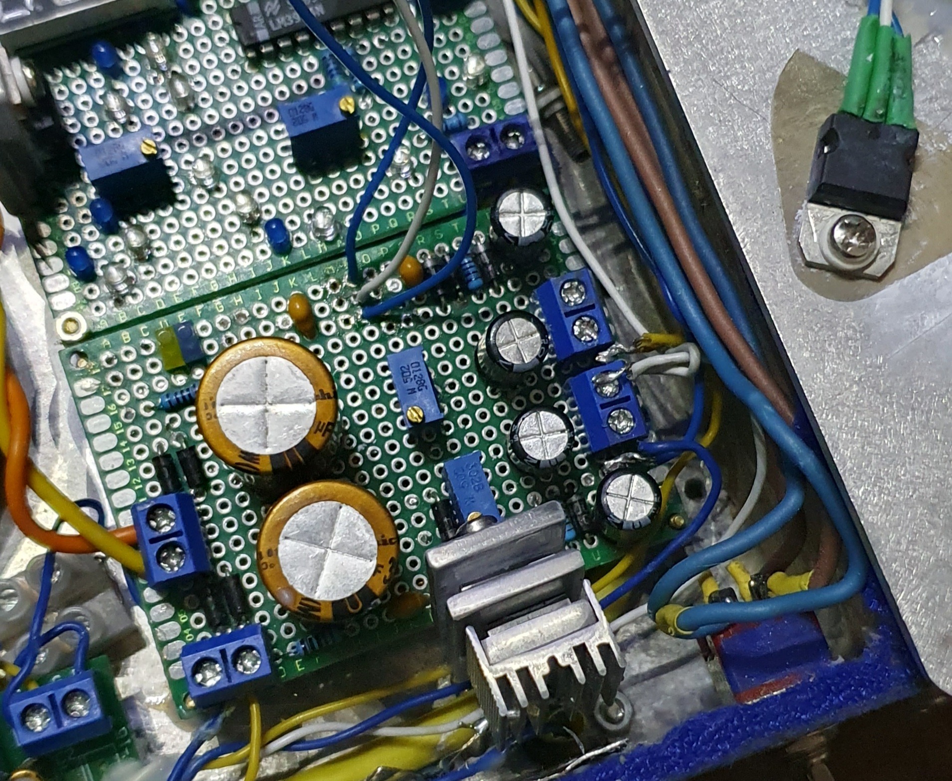

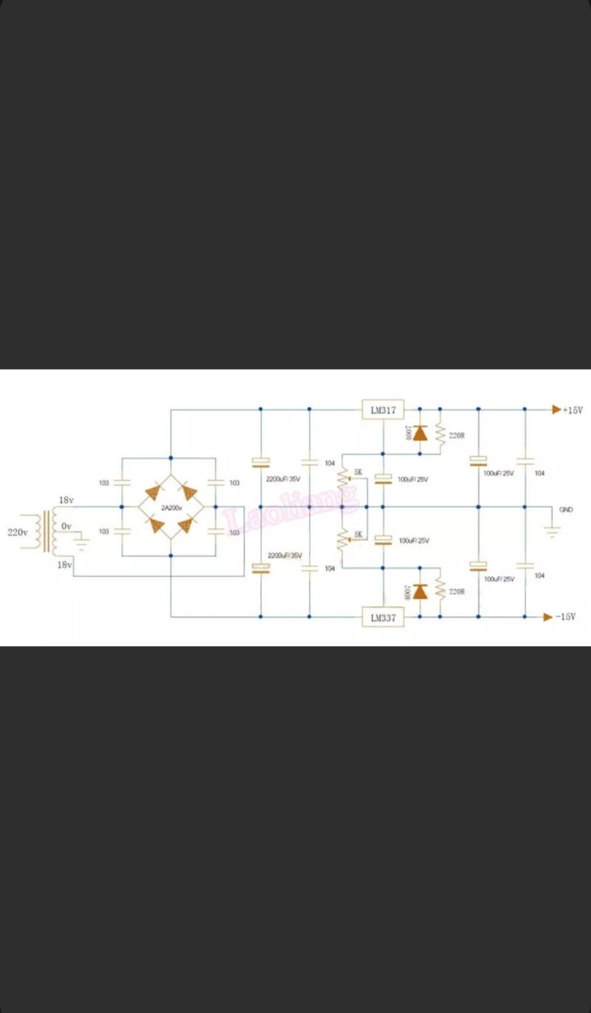

Circuit diagram and photo attached. Only difference is I'm not using a centre tapped transformer.
The power supply seems to be working fine, +/-15v or so, stable. It's just when I attached the ground of the power supply to the chassis earth, the opamps smoked.
The preamp, with the opamps, is ESP P97 (Elliott Sounds).
Everything was working perfect before, other then a hot lm317 so I mounted it on the aluminium lid.

What do you mean by, you are not using a center-tapped transformer?
That is necessary, unless there are two isolated secondary windings instead,
each with rectifiers and regulator. Post the correct power supply schematic.
I find it odd an LM317 was hot while just powering opamps. Was it just one of the two that was hot? Sounds like a low resistance path somewhere, and there shouldn’t be -13.8V on the chassis ground. It should be minuscule, like 0.1V, if anything.
What is that stuff under the LM317 - is there an insulator pad or is that some type of grease?

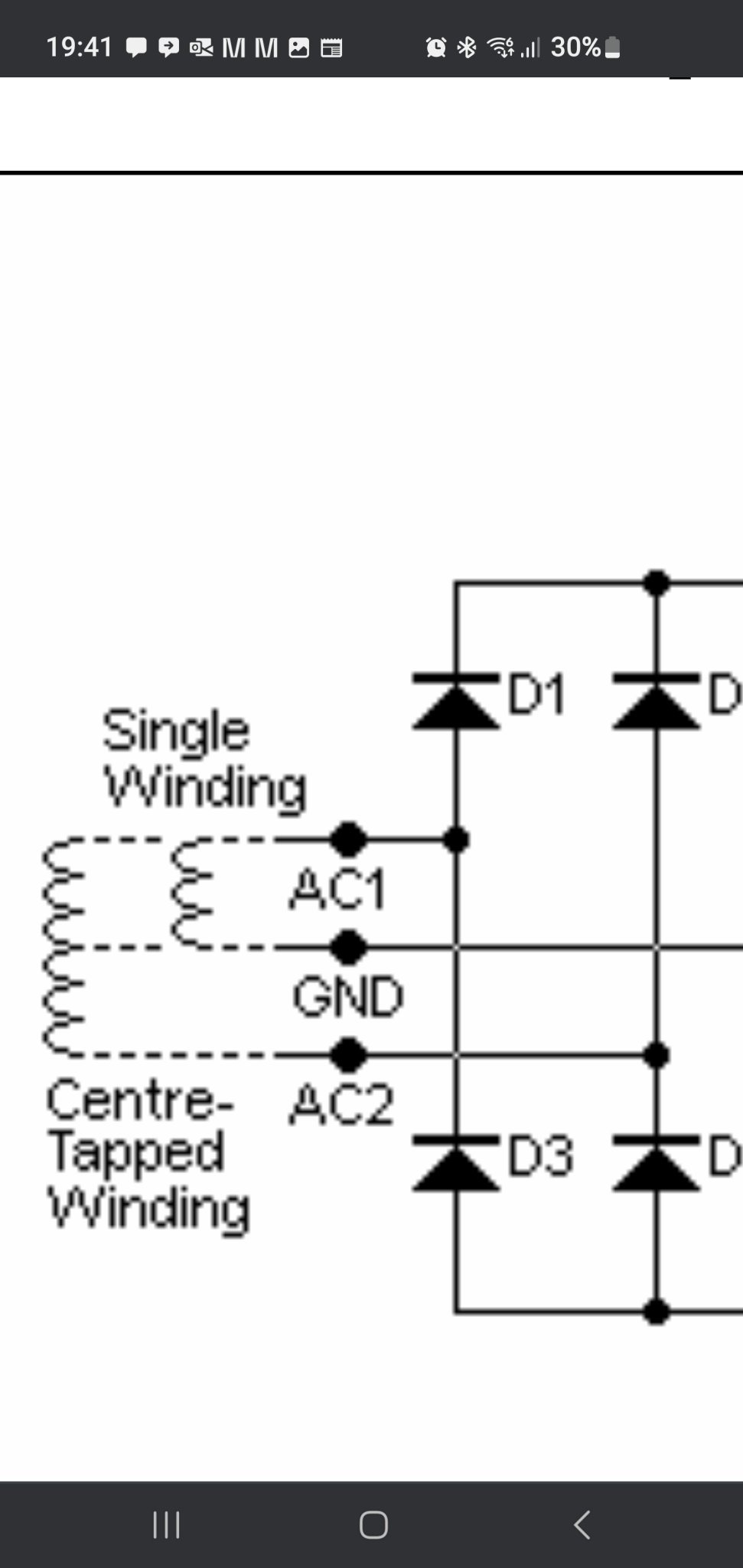

Yes, two separate secondaries, but single rectifier though, as this extract from ESP site (single winding)
4 opamps in total, plus 5 LED's. The heatsink was very small, + hotter than - (LED's).
Under the lm317 there is isolation pad plus heatsink compound.
Well, that’s good to know.
If -13.8V voltage on the chassis appeared after the regulator was mounted, I would check the pad. I guess an important question is, what’s the voltage on the chassis when the regulator isn’t mounted to it?
Not a working schematic. Needs 3 leads from a CT secondary to function.
Also draw the actual transformer secondary winding(s) exactly as they are connected.
Schematics are topological only, so exchanging the caps and diodes is meaningless.

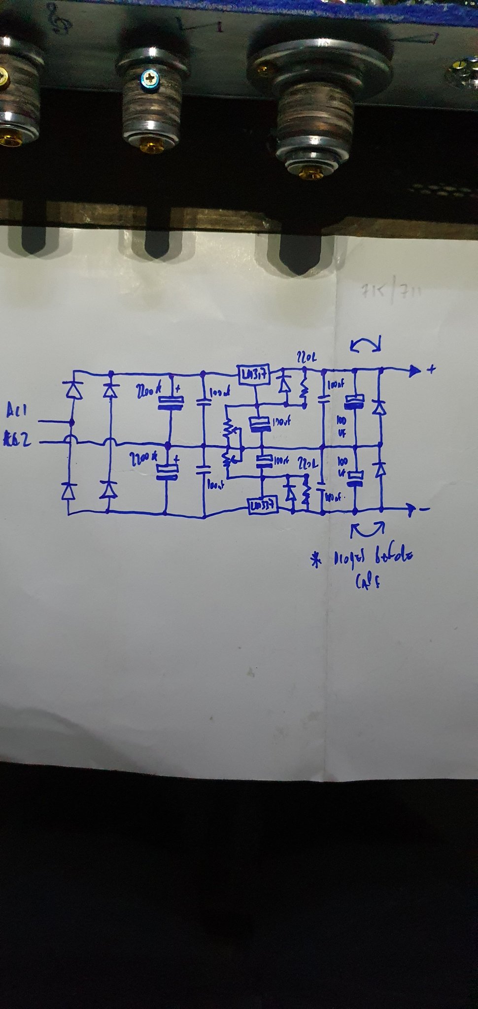

Yes, I thought to correct it only to show exactly how it is.

Please see this link to the ESP website, P05 power supply
https://sound-au.com/project05b.htm
Mine is wired exactly the same, the single wired option, no CT, see schematic and text below.
You can have one of the following:
one secondary (or two secondaries in parallel) , and one output voltage
two secondaries connected in series, using a wire from the center connection, and two output voltages
two separate secondaries each with rectifier and regulator, with outputs in series, and two output voltages.
Without a complete, correct schematic of what you have, it is not possible to determine whether it can work.
ESP has no"single wired" option. Do you perhaps mean "single supply"? That only has one output voltage.
