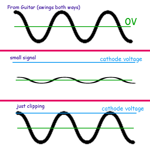

As said, the guitar swings both ways around zero volts.
We normally set the tube grid to zero volts (cheap and cheerful), bias-up the cathode to positive 1V-2V.
The "signal is negative" relative to *cathode* until peaks rise above cathode bias.

OH: and tube-men commonly refer all electrode voltages to *cathode*.
But in practical builds we often jack-up the cathode a volt or two with a resistor. Then a ground-referenced grid is negative *with respect to cathode*.
