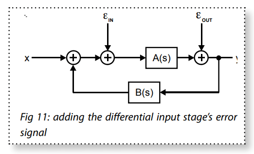

Perfectly valid for AC if G(ol) and Fb are proper functions of omega. Then you can even determine if it will be stable.
The trick is determining those functions exactly. Especially for the transformer. Not exactly paper math I’m looking forward to. In my own “fuzzy math” I tend to make a few approximations that work most of the time. But sometimes I get burned by it…..

It is phase shift, not time shift. Negative feedback is 180 degrees phase shift at all frequencies, fed back to the input. If it were delay, the phase difference would be frequency dependent: virtually zero at low frequency, going through 180 degrees somewhere, and 360 degrees (in phase) again at a certain frequency. This is true for sine wave. For real audio signal we simply invert the signal and call it 180 degrees phase shift. A reactive circuit element (an inductor or a capacitor) will increase or decrease this phase shift - again frequency dependent.Delay of the corrective negative feedback signal, not a good thing.
Subsequent distortion of the N Fdbk signal itself going thru the amplifier just looks like a small additional error component (for the next moment) that will get (mostly) fixed by a second loop thru the Fdbk loop. As long as the amplifier has plenty of excess bandwidth and correct phase compensation, the results will quickly converge to what the feedback equation predicted. Higher frequency input signals and higher harmonic distortions will deplete the excess amplifier bandwidth available for multi-looping. So good practice removing the OT from the loop at higher frequencies by HF transition to a local loop. Important OT distortions occur at low frequency anyway.

I think it's safe to say that feedback is causally recursive. Without it, Black's equation would be exact, rather than an approximation.
