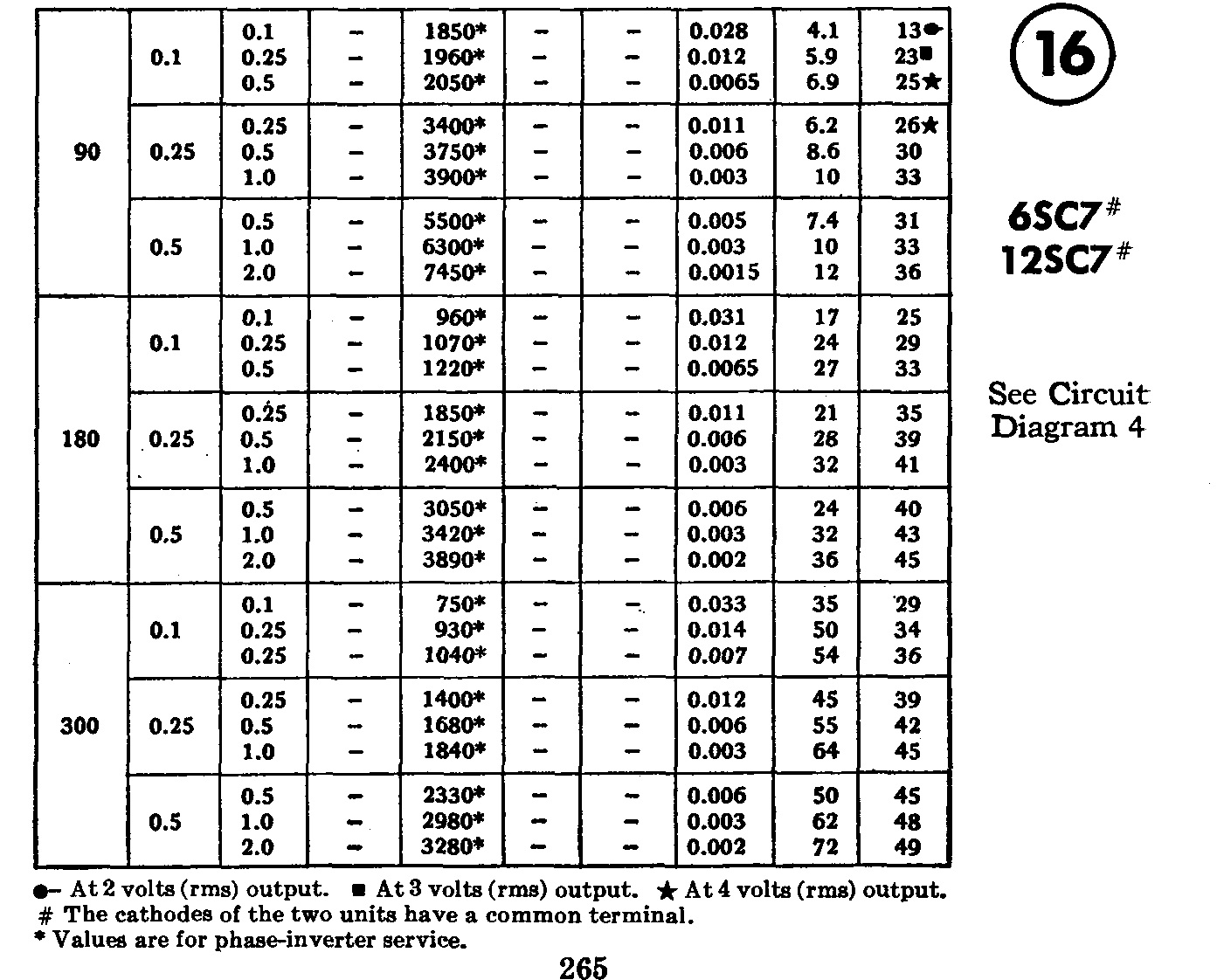

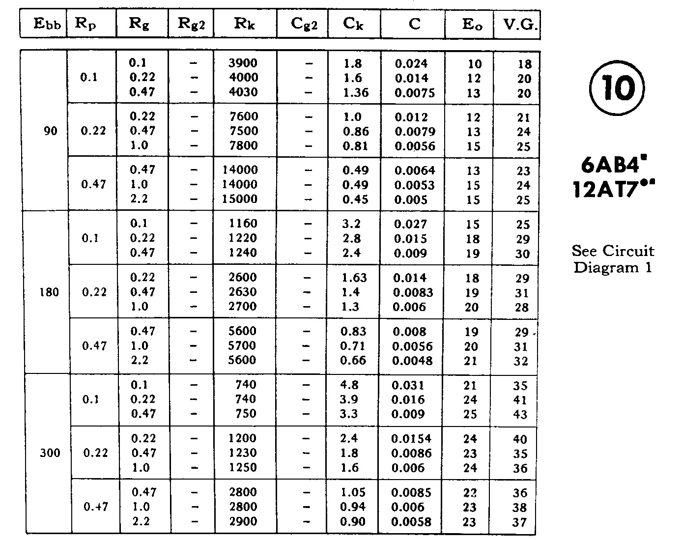

Right changing a 12AT7 for a 5751 (more like a 12AX7) will increase the gain a lot.
The 12AT7 has a mu of 60, the 5751 has a mu of 70, and the 12AX7 has a mu of 100.
The gain with a 5751 in this circuit will hardly be more than that with an 12AT7.
These are the rc-data from the RCA Receiving Tube Manual for the 12AT7 and the 6SC7 (mu = 70 / Ri = 53K / S = 1.325mA/V, so very close to the 5751). The voltage gain for both tubes at about 180 V and with a load resistor of 100K and a cathode resistor of around 1K is the same: 25.
