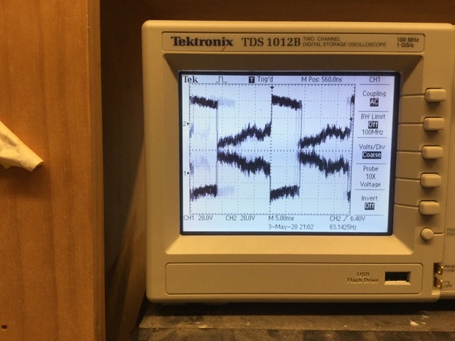

Lead dress is extremely important for stability, even in stages with low gain. Things you don’t expect to make a difference can. The bias board at the left of the photo was originally located at that second set of holes to the right of the k-followers, with the coupling caps flying over the stage back to the phase splitter. Couldn’t get the stage stable, and it’s unity gain, dammit! Even with no feedback, or even output tubes. Get the signal level above a certain point, and the followers would regenerate and drive straight to clipping. Square wave clipping, and asymmetrical to boot. That would have made some NASTY popping sounds. After a lot of head scratching the only thing it could have been is unintentional coupling. Moving the bias board and putting the coupling caps on it to minimize lengths fixed it immediately.
