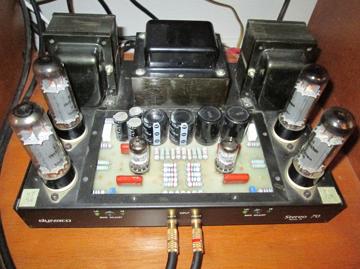

I have always used the 4Ω output on my Dynaco ST-70 series ii. My speakers are 4Ω.
Why is the negative feedback always connected to an 8Ω output or even a 16Ω output on tube amps when they very often are not the outputs used? Is this why some prefer to connect 4Ω speakers to the 8Ω output?
I am building the amp with the schematic attached. Why not connect the neg feedback to the 4Ω output, and if so, what value resistor would I need to use?
I am also wondering if I should change it on my Dynaco ST-70 series ii?
Edit: updated the ST-70 ii schematic

Firstly R8 is to allow cathode bias voltage detection, nothing to do with the nfb loop. Too much current flowing will illuminate the LED as a warning of imminent meltdown.
You can choose whichever tapping you want for the nfb loop but you will need to recalculate the values of nfb components accordingly and in your schematic, reverse the anode wires if you select the 4 Ohm tapping, for obvious reasons.

Changing the Dynaco ST-70 series ii might be too complicated for me to handle. I have no idea how it would affect the LED bias indicators located on the front panel. The amp I am building now wouldn't have that complication at least.

The highest impedance winding typically has the best coupling and least phase shift at high frequencies, so may be easier to compensate. Resistor is easy to calculate, capacitor across it and any high frequency shelf network have to be found by experiment (best square wave, stability into various loads).
I assume that the 4 Ohm output is a tap, not a separate winding with opposite polarity as the schematic shows. As shown, half the secondary is always unused, resulting in higher leakage inductance. Hard to measure with an ohmmeter, nearly zero Ohms, but you could put 117V on the primary and measure each secondary plus the sum.
It depends on the output transformer. As Tom Bavis indicates, some OPTs exhibit better (or worse) behavior depending on the output tap selected for feedback. For instance, the Acrosound TO-330 is notoriously tough to tame due to some excessive peaks in the high-frequency response. Unless you design a multi-tap feedback network like Eico did in the HF-60, you're better off taking the feedback from the 4 ohm tap. You would need to 'scope your amp's square wave behavior to determine which tap gives you the smoothest response and the best high-frequency stability.
I would not change the ST-70 unless you're prepared to look very closely at the results on a scope. The A-470 is an excellent transformer and the feedback works best from the tap chosen by Dynaco.

To change the feed back from the 8 Ohm tap to the 4 Ohm tap, reduce the feedback resistor to 70% of the resistor that is used for the 8 Ohm tap.
If you have a 10kHz square wave, an 8 Ohm dummy load, and a scope, measure the square wave response into 8 Ohms on the 8 Ohm tap.
Then, change the 22k feedback resistor to 15k, and change the connection from the 8 Ohm tap to the 4 Ohm tap.
Test the square wave response again, but this time with two 8 Ohm resistors in parallel (4 Ohms), on the 4 Ohm tap.
Your Mileage May Vary, for the most part according to the output transformer.
Good Luck, and happy listening!
