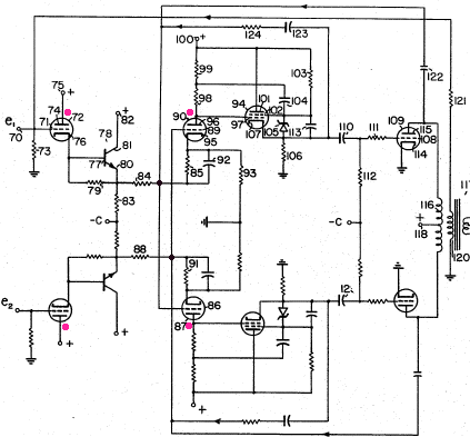

Yes you are right, that is not my amp. It's 1953 patent by John Miller and his 1950 article, could easy has another NFB in the front end though. But I think he didn't do it due gain limitation imposed by PF due transformer output, if OTL amp sure he can boost the gain further...
The 3rd point refer to my amp.

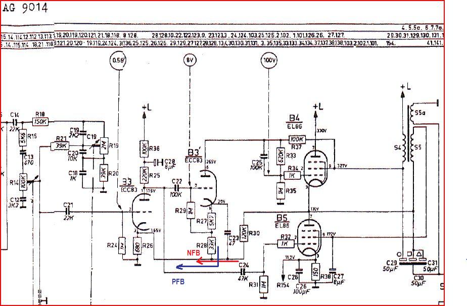

Right, I understand, I will take snapshot of the waveform on top of resistor R34 of V3 cathode and R37 of V4 cathode soon.
Today I done yet another experiment. I increase the value of R17 of V2 top to about 20K while R18 at 16.5K unchanged. The reason is that I always get positive DC offset in the output, with or without PF. This is because top tube is conducting less than the bottom tube so waveform is lopsided. Even with so high NFB, it still can not raise enough drive for top tube. Not only that the conduction angle is "shorten" early and the lower tube start to conduct earlier. That is why the crossover distortion is not visible under heavy clipping due "over" overlapping. After R17 is increased to 20K I got good DC offset and now you can clearly see the crossover during clipping right in the middle. That is more like Class AB, but the idle current could be reduced somewhat so yet increase some more efficiency.
This change has brought the amp with full control of NFB once again, sonic wise has improved.
I will post the snapshot later today.
This current waveform of top and bottom tube 20*10 mV scale. Output level is just under clipping when the current waveform is taken. This is 10 tubes model 5 tubes each bank, current waveform is taken using floating scope across 1 ohm resistor in the cathode of one of tubes.
As you can see from 2nd snapshot in the last post, when driven further into clipping, crossover point shifted up further, meaning top is conducting lesser during this time due to loss of gain, as well as DC offset jumped to 1.2V at this point while normally just < 0.1-0.2V.
" I'm assuming the operation at V2/bottom is class A, so there is no switching on/off of the PF."
I like to make clearer answer to this:
1) yes V2 is a Class A type.
2) V2 also drives the bottom tube
3) V2 also where PF is (solely) derived so it it important V2 output not be trimmed due addition load branching. So must have sufficient gain to minimize the loss. We experienced some difficulty in very low mu tube such as 5687, and so plate resistor in V2 needs adjusted to compensate for the loss. The value in original schematic works very well including 5687 (Have to adjust the PF resistor R16 and R26 to suit my latest is R26=500, R16=100K), the others remain unchanged.
4) It is debated as why PF should be derided from V2. Ideally NFB should be able to have full control under optimal condition, these conditions can be met easier with a bit higher gain tube, with low gain is it is a bit of challenge especially boosting to same higher level. It is important the condition be met before drawn conclusion. Since the bottom tube is a voltage follower and upper tube is cathode follower to begin with, V2 drive would be quite different from V2 top in turn of wave form shape since there are not the same output type so they have different gain at low output to nearly some gain at higher output. Still remember V2 bottom is sole point where PF is derived for top and bottom. If we maintain V2 bottom level as is (it signal level under NFB control through out), it appeared to me this PF so derived appeared to be have very good result.
5) You can see why in snapshot attached. The top part of wave form drives bottom tube and bottom part wave form (actually an inverted in V1 splitter for top tube drive, as the bottom part does not actually drive top tube, it is mirror of the actual arm drive the top tube). drives top output tube This is the kind of proportion we looking for.

Thanks for all the photo measurements. Much clearer now how it is operating. The output currents indicate class aB operation of the output tubes. The NFB is swinging the drive signals asymmetrically to drive the cathode follower up top versus the grounded cathode stage on the bottom. The full NFB loop is performing the "voltage follower" function for the bottom output tube. Usually I think of a voltage follower as being a more local feedback loop.
In addition, I think what you have been saying (and I wasn't getting) then is that the PF assists "more" when the bottom output tube needs more drive signal (since the bottom V2 plate swings more then), so the PF is doing some of the output symmetry correction directly. It is an interesting approach. One might expect the adjustment of the PF gain to find an optimum level where it just exactly corrects the lower tube gain. Somewhat similar to the Error Correction (EC) technique used in SS amplifiers for fixing crossover, except here it is functioning with a large assymetry to fix.
This would be quite interesting to look at the output distortion directly with a differencing Op Amp, while adjusting the PF level to see if there is a best "null" error point for the PF.
The EC technique puts the PF correction in ahead of a local NFbk point (effectively changing the input signal), so that it can develop immense gain (recirculated PF leading to just short of infinite open loop gain) to overcome the error altogether at an adjusted "null". There is then a global NFbk loop around the EC loop to fine tune out any residuals and maintain stability. Your circuit's PF loop may still be operating as conventional PF with fixed gain, not sure at this point about the front end cathode PF injection. Finding an error "null" (optimum PF level) would indicate it is operating like EC.
Conventional PF would show asymptotically reducing distortion as the PF is increased. While EC would show an optimum PF point, and can actually invert the distortion if adjusted beyond the optimum level.

What if we provide additional gain to top tube by altering R17, so the open loop gain of both is same under PF control?
"What if we provide additional gain to top tube by altering R17, so the open loop gain of both is same under PF control?"
Exactly what I was thinking. The PF loop gain can be adjusted to unity loop gain, no matter which output tube is conducting. So it is a matter of providing some extra V gain for the N Fdbk loop to always control that. The bottom output tube already provides some gain when it is conducting, just the top tube is short on gain. So increasing the driver gain to the top tube to match should be able to level the field. Only thing then is if the load Z varies, then the bottom tube could loose some gain at times. But it just needs to keep up some minimum gain.
Thank you, I think now the open loop is quite close due to the PF branch loss of bottom tube, no much I can do at this moment.
