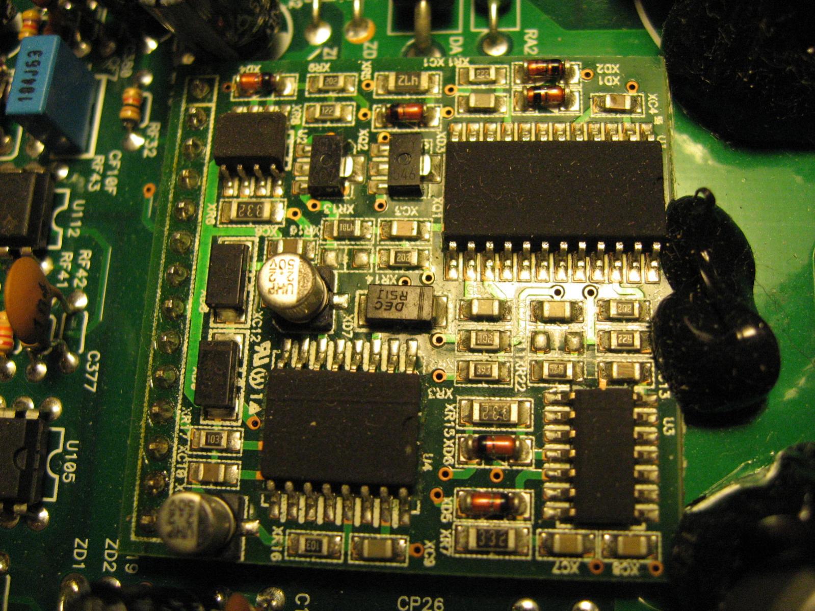

Here are a couple pics of the power supply and output cards for the Memphis Mojo 16-MCD4KW, if anyones interested in them. 🙂
I'm not sure Perry. There are 3 chips and I have no idea what each one are doing, or what voltages I should be seeing. I'll get you readings first thing after work. 🙂 I got all the reading from the 494's in the power supply last night
