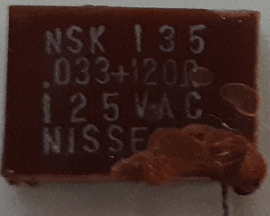

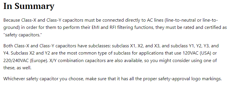

Ok that is the one type of critical component because it's an AC line capacitor. Those have been known to fail (in a spectacular way) from a certain vintage and manufacturer. You want to replace it with an X or Y capacitor depending on the circuit. See https://www.allaboutcircuits.com/technical-articles/safety-capacitor-class-x-and-class-y-capacitors/
Because Class-X and Class-Y capacitors must be connected directly to AC lines (line-to-neutral or line-to-ground)

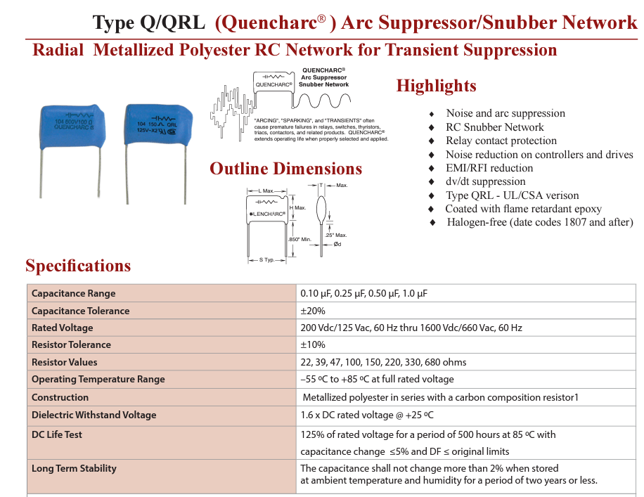

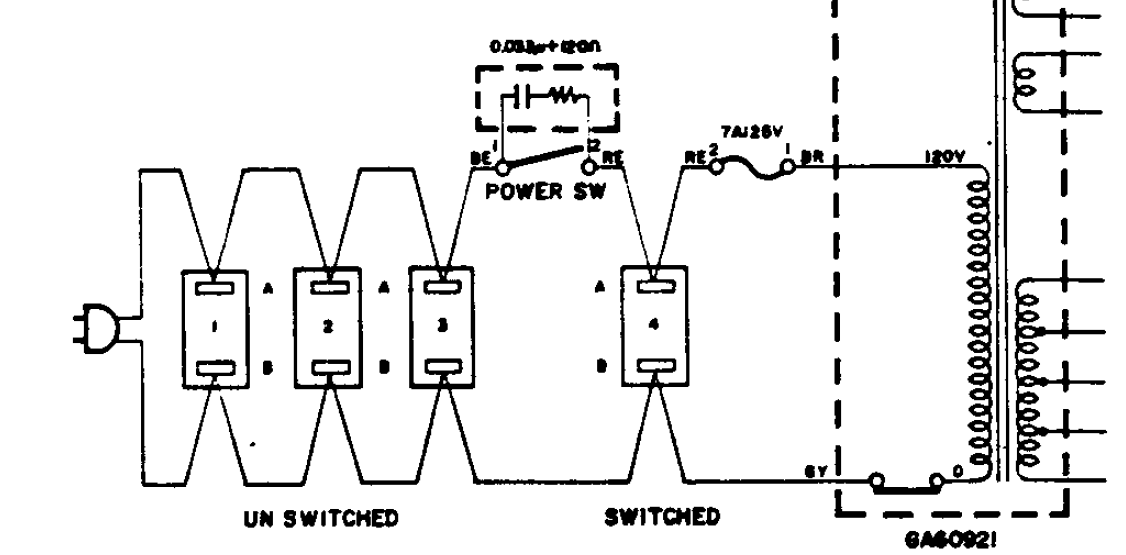

This is what I am finding, I was reading a Tech Note on Snubbers the other day and it's effect upon transformer ringing. Therefor it appeared to be critical to use the correct values. I don't see the values here.
I also saw an article on using a MICA cap and Carbon Composition Resistor. When I looked at MICA the price was over $40.00, that is a surprise and other ideas?
This part in question has nothing to do with transformer ringing. It's to quench the small arc when the switch is opened and slow down wear on the contacts. Where did you see the article about mica? Here's all you need.
https://www.digikey.com/en/products/detail/würth-elektronik/890324025006CS/5038917
$0.39
https://www.digikey.com/en/products/detail/ohmite/OF121KE/15294014
$0.95
Honestly you could leave it out of the circuit and never notice a difference. There's probably a dozen devices in your home right now with a switch and no snubber across it.

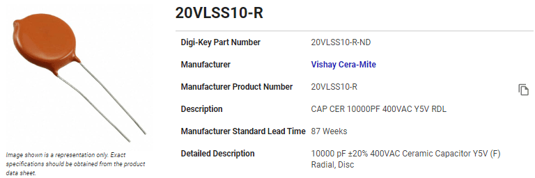

This is the only 0.1uf ceramic cap that I can locate, unless I can use a film. This for the Main board.This part in question has nothing to do with transformer ringing. It's to quench the small arc when the switch is opened and slow down wear on the contacts. Where did you see the article about mica? Here's all you need.
Where is it located in the circuit?
Ceramic disc caps are ancient now and that's why Digikey carries ONE in that value. Pick a regular ceramic capacitor and you'll have hundreds to choose from. I don't know of the voltage rating you require but here is 0.1uf at 100VDC.

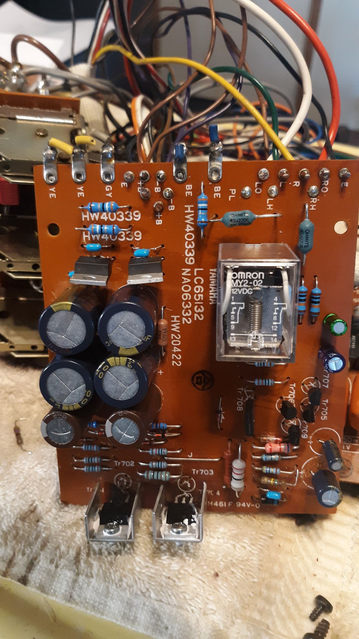

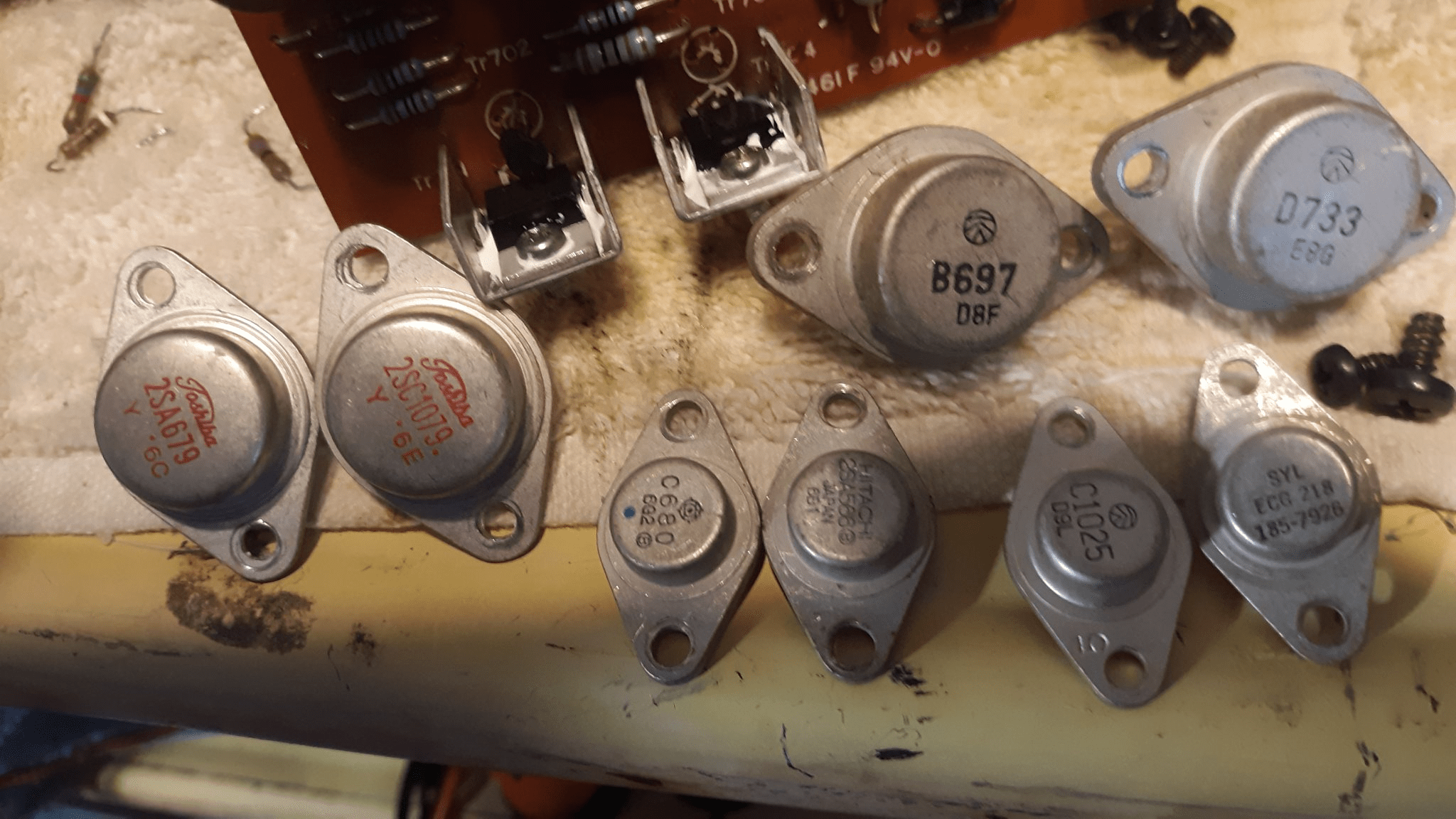

Help me out here, I thought you were referring to these?TO-3P transistors were originally intended to drop into a TO-3 outline, though they might need a rectangular insulator rather than the diamond-shaped TO-3 insulators. There are a couple of TO-3P devices available at Digi-key that might be suitable as replacements for the original TO-3 devices used in this appliance.One is from Sanken, and one is from On Semi.Both appear to be as zippy as the original TO-3 devices used here.

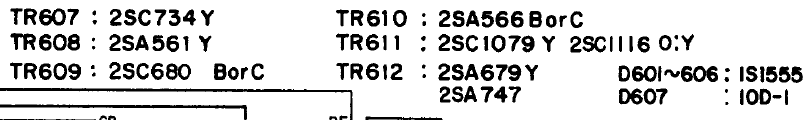

TR609,
TR610,
TR611
TR612

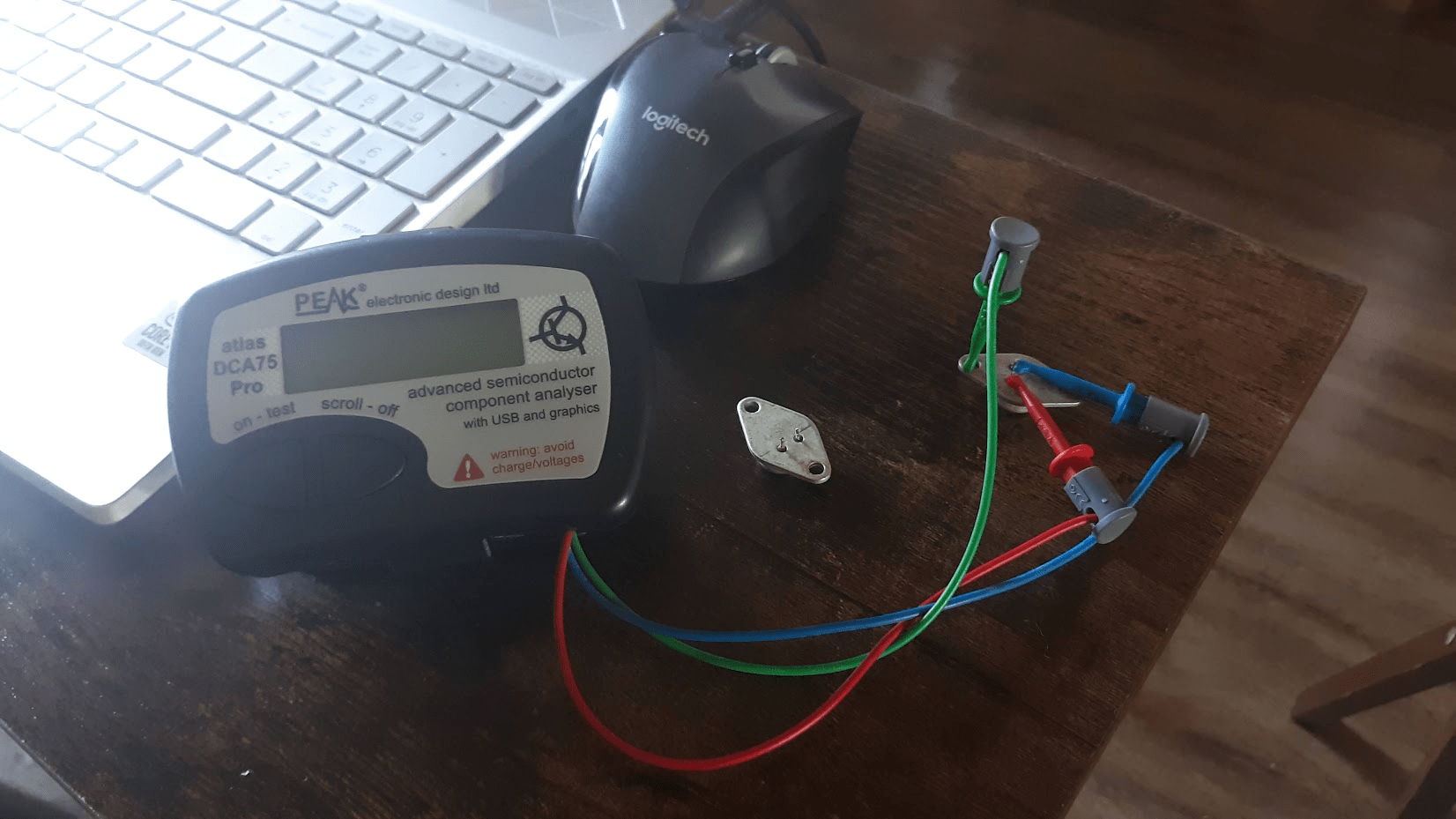

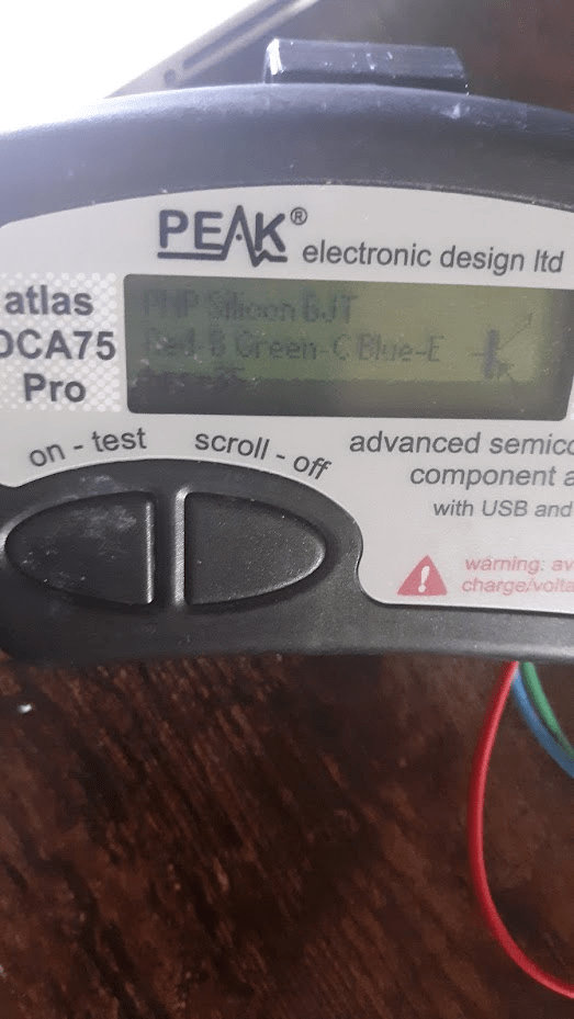

Every one of those transistors can't possibly be bad unless it was maybe struck by lightning.
Have you considered that your meter is bad since you claim every part is measuring out of spec?
Part number inconsistentEvery one of those transistors can't possibly be bad unless it was maybe struck by lightning.

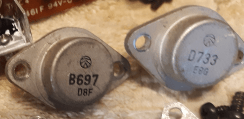

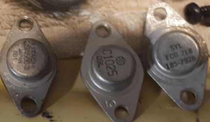

I don't find anywhere a cross-reference from original to these
- Needing a 1970's Yamaha Engineer (employed by Yamaha)
