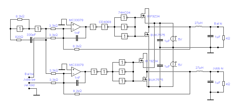

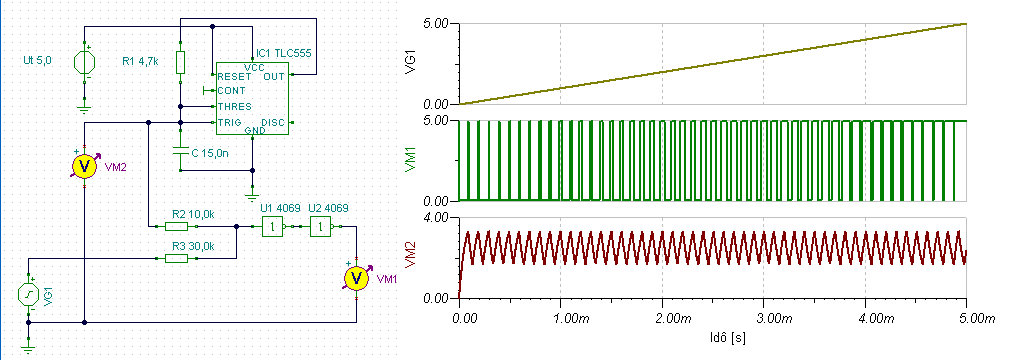

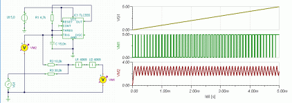

I attached some schematics showing inverter (like 4069) used as modulator, clock generator.
But you can also use it as error amplifier just like an inverting OPA. You can imagine it as a weak, a little noisy, but fast OPA where the noninverting input is hidden inside, and tied to (VDD+VSS)/2. So if VDD and VSS are clean and symmetrical, then this can be used as an inverting OPA circuit.
