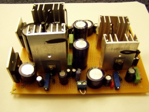

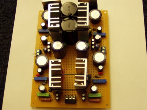

This is the finished power supply. It is capacitance is 1kuf__resistor__12kuf+.1uf+.01uf/lm317/3.4kuf+.1uf snubber----1kuf+.1uf+.01uf/lm317/.1kuf+.01+.1kuf_snubber
and 100uf on adj pin.
I have jump point at bridge and bewteen the lm317 sets,so the supply is flexable.
Thanks to all who helped ,especially juma and rudi
