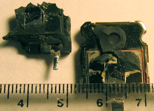

i've tried splitting open the dead '1302 but so far it hasn't split. I whacked :smash: it good with the handle of a screwdriver on the side of the transistor about 50 times but only succeeded in creating a slight chip around the "ear".

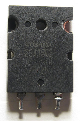

attached is a pic of it with the slight damage from my attempts to break it open
I went ahead and ordered a couple 2sa1302's from digikey (and a couple of 2sa1943 as well); when i searched the forum a few people mentioned that digikey buys straight from toshiba and they should not have fakes (thus they should have NOS)...well, i ordered a couple and when I get them, will attempt to split one open and see. will post pics. if the 1302's are good I'll use them, if not then i'll use the 1943's, and if THOSE are fake..i guess i'll go with onsemi MJL1302. I wanted to keep the transistor as close as possible to original to avoid any unintended affects on the amp..

In the US, www.digikey.com and www.arrow.com still stock these. They are big distributors who get their stock either from Toshiba, still have stock on hand from Toshiba or have other reliable sources. At least I was told that when I asked.

Centauri said:
Yep, that looks like original. All the fakes seem to have the chip covered in a white silicon stuff.

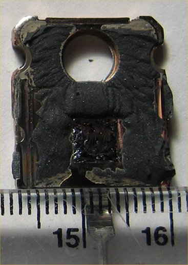

I got three new 2sa1302's from digikey, and sacraficed one for "testing" purposes. am happy to report it's a real one. see attached image.

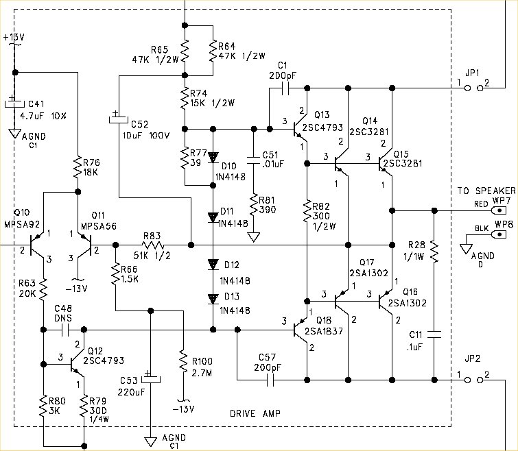

I've attached the schematic in case anyone has any pointers on other things to test, even though it sounds like it's working great.
JP1 and JP2 lead to "down converters" whatever that means. it's a bunch of additional circuitry that looks like it's meant to play tricks with the rail voltages. The outputs of these component circuits connect at JP1 and JP2 and are labeled "(+) delta V out" and "(-) delta V out"

i really don't think you want to replace just one output device - without emitter resistors the only hope is very, very good matching, such as you could at least hope for with 2 devices from the same manufacturing lot
so, i'd be better to replace all four final output transistors? How would I know any better/worse if all four new devices were matched?
I only replaced the failed one. I didn't think it'd be too bad, because it is paralleled with another 1302 (so any differences in the new 1302 should be 50% counteracted by the parallel'd device), plus it's a sub amp, ~ 80hz and below only, and human hearing isn't that accurate down there.
At least..that was my reasoning. is there anything I'm missing?
Due to differences in the transistors, one transistor will tend to hog all the current, leaving the other one(s) doing very little. While not a problem at low volumes, high volumes can overload the hogging transistor causing it to fail (and probably taking something else with it).
Usually most power amps like this will have low value, high wattage resistors (0.1 to 0.5 ohm, 2W or 5W) in the emitter lead of each output device, which tends to promote even current sharing between the outputs. As this amp does not have those, matching of the outputs is more critical.

since matching is critical with this topology, it sounds like I'd be better off getting the MJL1302/3281 matched pair from audiochips and asking if they can match me two pairs so that all four output devices match each other.
any reason why the specific schematic/topology i posted woudln't like the 1302/3281 from OnSemi?

The ON parts are different from the Toshiba parts in a few parameters. cob hfe etc.
If I were to do it, I'd replace the entire OP stage with Toshiba's own 5200/1943 replacements. These are closer to the 1302's than ON's MJL1302 etc.
