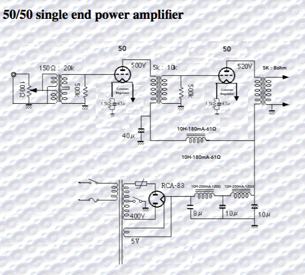

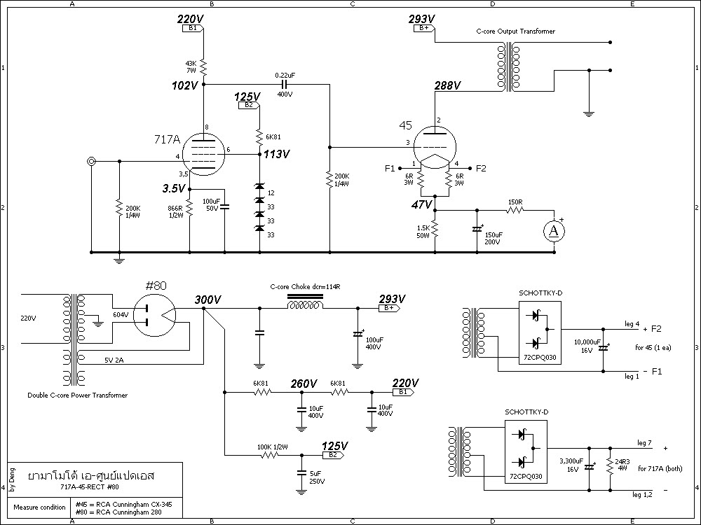

Need your thoughts on a 50 / 50 SET amp
Please review this schematic and let me know your thoughts. based upon the Sakuma principle with the driver tube = output tube. I am curious about your thoughts for any improvements or if it looks OK, then please confirm.

Are you suggesting that the input transformer be eliminated? What are your thoughts about eliminating it completely?
no , you need it to have some gain but even with a good model like the lundahl LL7903 with 1.8 ratio will sound worse than adding a tube gain stage .
some tube schematic are just for style with exotic name but in the real life can be a waste of money .
the 1:2 It must work but 1:1 will always be better and the input transformer certainly not or if so i will buy dozen of them 🙂
Are there any specific tubes that you would recommend to replace the input transformer and the driver 50 tube? Trying to kill 2 birds with 1 stone, as they say.
if want a mix retro:modern
or the mix with a small pentode WE717 , WE 310a , 6J7 , 6C6 " a la yamamoto" style to stay in the exotic name

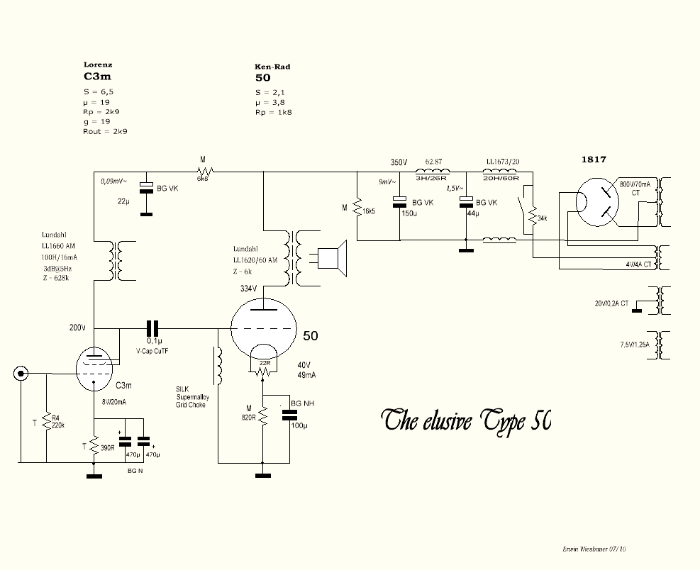

Juanitox, thanks for sharing the schematics. Do you have experience with either of these schematics? Preference? I have not done any A/B comparison of interstage tranny vs. cap/resistor. Any thoughts on this, as both of your schematics eliminate the interstage tranny.
i have tried interstage vs Choke loaded or RC coupling and prefer the later but the only IT i have tried is the lundahl 1660 , i don't think a PIO of mica coupling cap could ruin the sound a bad IT certainly will.
i have tried both type of driver didn't like the C3M " to good to be true "
i prefer another aproach with small vintage pentode WE310a EF37A 6J7 in pentode mode with a VR tube regulation on the screen , or DHT like 26 , 71a , 46 if you don't need gain or if you have a preamp with high gain. the 50 is a fantastic sounding tube , i will first try it with a small and cheap pentode ( except real WE310a) in pentode or Triode mode. 🙂

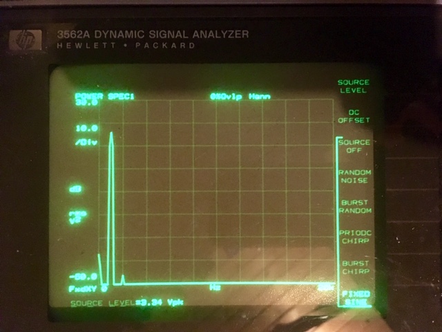

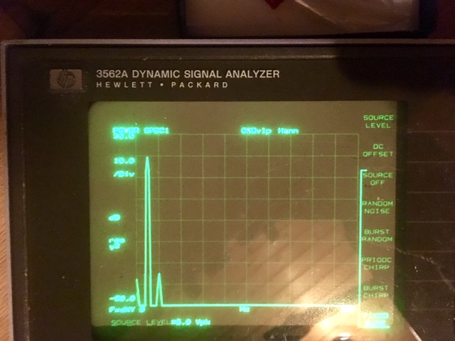

I made a se 50 4 or5 years ago, settled on the EML 30a as driver it coupled to the 50 with the iso nc 20f interstage transformer.
Attached a measurement from the secondary of the interstage
(secondary open during measurement)
1 khz 77,3 Vrms out. The EML 30a is one hell of a driver tube...
also attached 1 khz, 116Vrms output

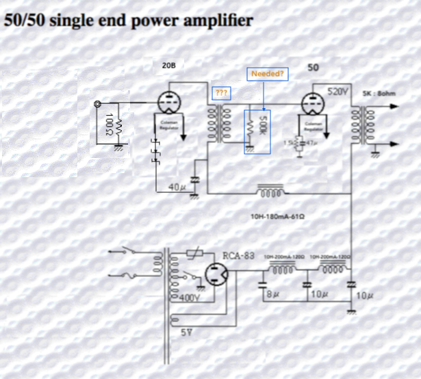

I re-did the schematic (see below) using an EML 20B driver tube (mu = 20) or an EML 30A driver tube (mu=32). Eliminated the input transformer. I have a few questions:
1. What values should the interstage transformer have (Henry and Amps). Please let me know how you derived these values, as I am in the learning stage and would appreciate the help.
2. Is a grid Leak resistor necessary if using an interstage transformer?
What do you think???

EML20B should have a load impedance that's about 10K, so we would want an interstage transformer with ~100H of primary inductance that has been designed to function as a 10K IT.
The Hammond 126C looks to be up to the job, albeit at lower plate current than the book operating point that EML gives. The Sowter 8424 is also workable, and you could get some support from Brain regarding running it as a 10K unit.
