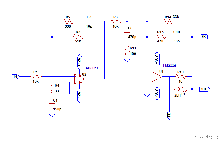

Nickolay Shvydky Member Joined 2005 s-audio.com 2008-11-30 1:27 am #21 2008-11-30 1:27 am #21 Here is the schematic. R2 could be set to 100k if you need amp gain 30. For R2=51k, gain is about 15. Attachments lm3886_gain_3_3.gif 9.4 KB · Views: 460
