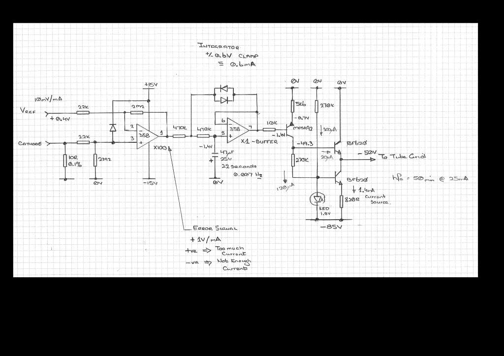

I am running for some years now the ul40s2 from Menno with the autobias:
Autobios improved
Everything is nice and quiet. I am running this amp in ultralinear.
I have just pulled the el34 and plugged 6550 from svetlana in withou changing anything else.
i got a huge hummmm...music could be played, but the humm was a lot. I plugged in a matched quad of kt88 of the treasury series...same behavior.
This is issue no 1. No idea why this can happen.
Worse, I plugged in the el34, and zhe amp was not quiet anymore. slight hum, but the channel as well is now not as loud as the other anymore (i did this experiment only on one channel). I did not change anything in the autobias module or anything.
What happened here ?
Thanks for your support

Ok, I found that one of the auto bias circuits for one tube did not work anymore, so one tube got a neg. grid voltage of -80v, while the rest got -35v. the 6550 needs about -45v, so well in the set range of -90v.
the auto bias was set for the el34 to 50ma. sure, the 6550 could get more like 80ma, but besides this, should it not work with 50ma as well ? Not following your point.
The key question though: Why did this all happen at all ? And if I now plug in the next 6550...what will happen than ?

Do you have a schem. for the autobias board? It may have a failed part or two.

The "autobias" board consists of a bias supply (voltage tripler) and four individual bias servo circuits with a common reference to define the required current. If there are no issues with sockets etc. then you have damaged one of those bias servo circuits. Each one looks like this. Since it is all surface mount then repair is a PITA but probably worth the hassle. Check that 10 Ohm current sense resistor first.
