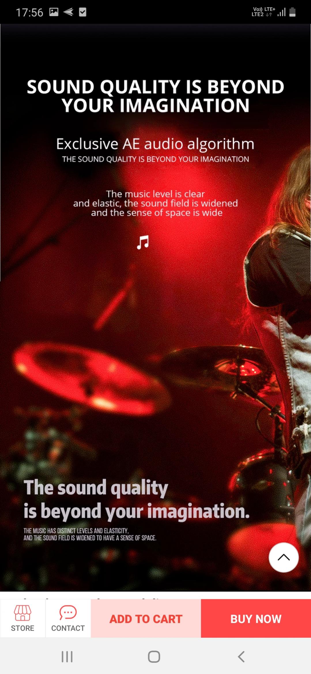

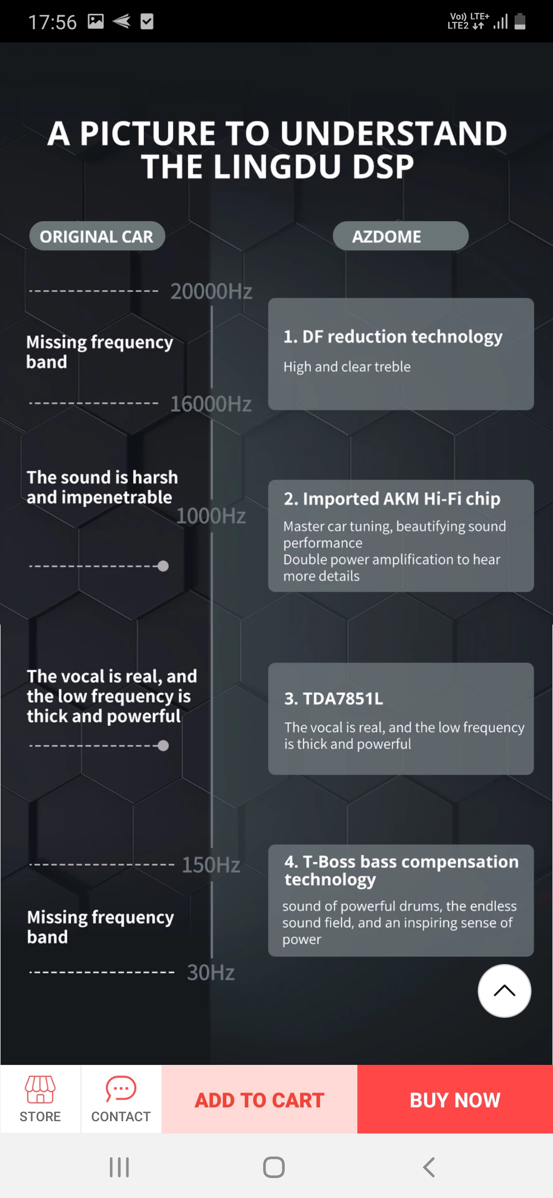

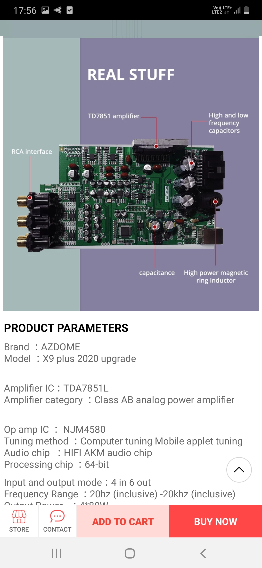

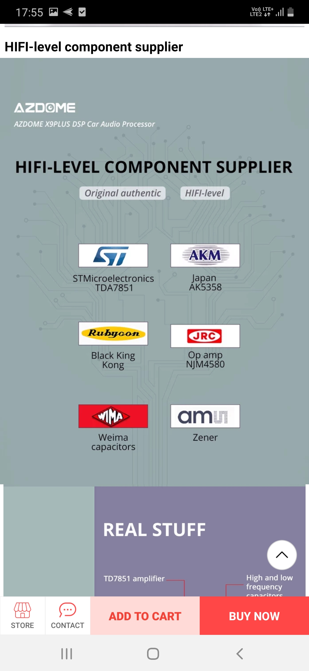

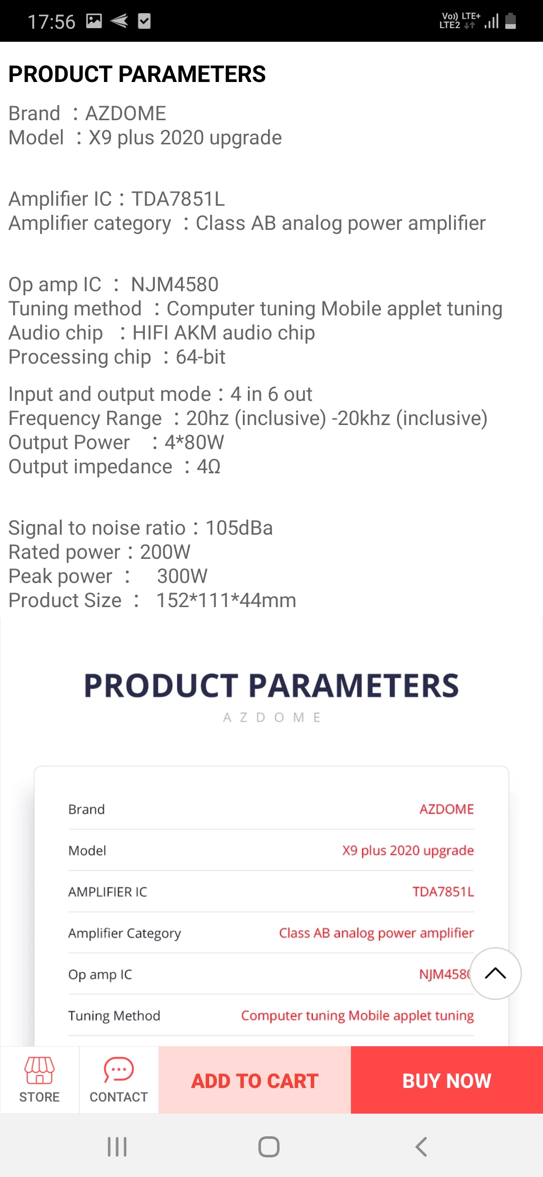

While searching for low power car amps I found this one and since I did not find any review video of this one.
I was wondering if anyone could give there opinon on this amp as the seller claims that it has exceptional sound.

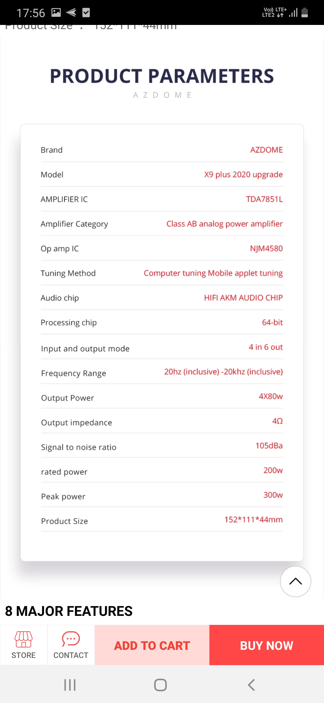

nonsense product with a DSP front end.
TDA7851 gives about 15W per channel into 4 channels from what I can see. Where the
6 channels or the "4 x 80W" figures come from is anybody's guess.
Oh my ... that's simple, Mark ... they lie.
They lie just a little, the TDA7851 can deliver 78 Watt/ 2 Ohm with 100% THD.
This is pretty honest, as they could also quote 500 Watt / 0,2 Ohm / for 0,001 Sec.
Off course, this power can only be delivered once, while the chip blows up.
Which is what we usually call PMPO...
