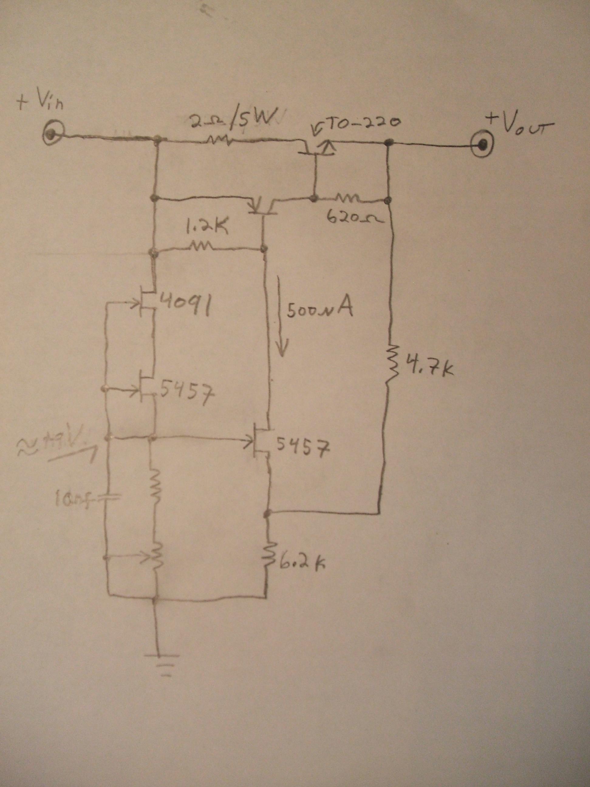

Here is a simple little circuit I like to use. It is a series regulator without any noisy Zeners:yuck:. The 5457 J-fet Idss is about 1-3mA and would have to be measured in order to choose the correct value resistor and pot for the correct voltage. A trivial task.🙄 The PNP transistor can be any old small signal device, there are plenty to choose from for that voltage range....2N3906 would be fine. The TO-220 can be any general device as well, 2N3055 or something. Might need its heat sinked of course. Values are arbitrary to realitive currents so they aren't set in stone.😉

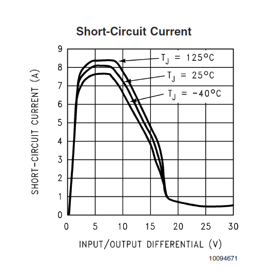

Why I don't know, but the damn LM1084 just shuts down. The steady current is only 1.25A but maybe it's the initial voltage that triggers the shut down - the supply is 33v off load - or the current surge on switch on or something. It's frustrating.
At 33V in, you could be exceeding the absolute maximum input-output voltage rating for the part (29V) if you're charging an output capacitance on switch on.
Well, I tried out the LM1084 in CCS mode, and it works fine, so that's one result.
