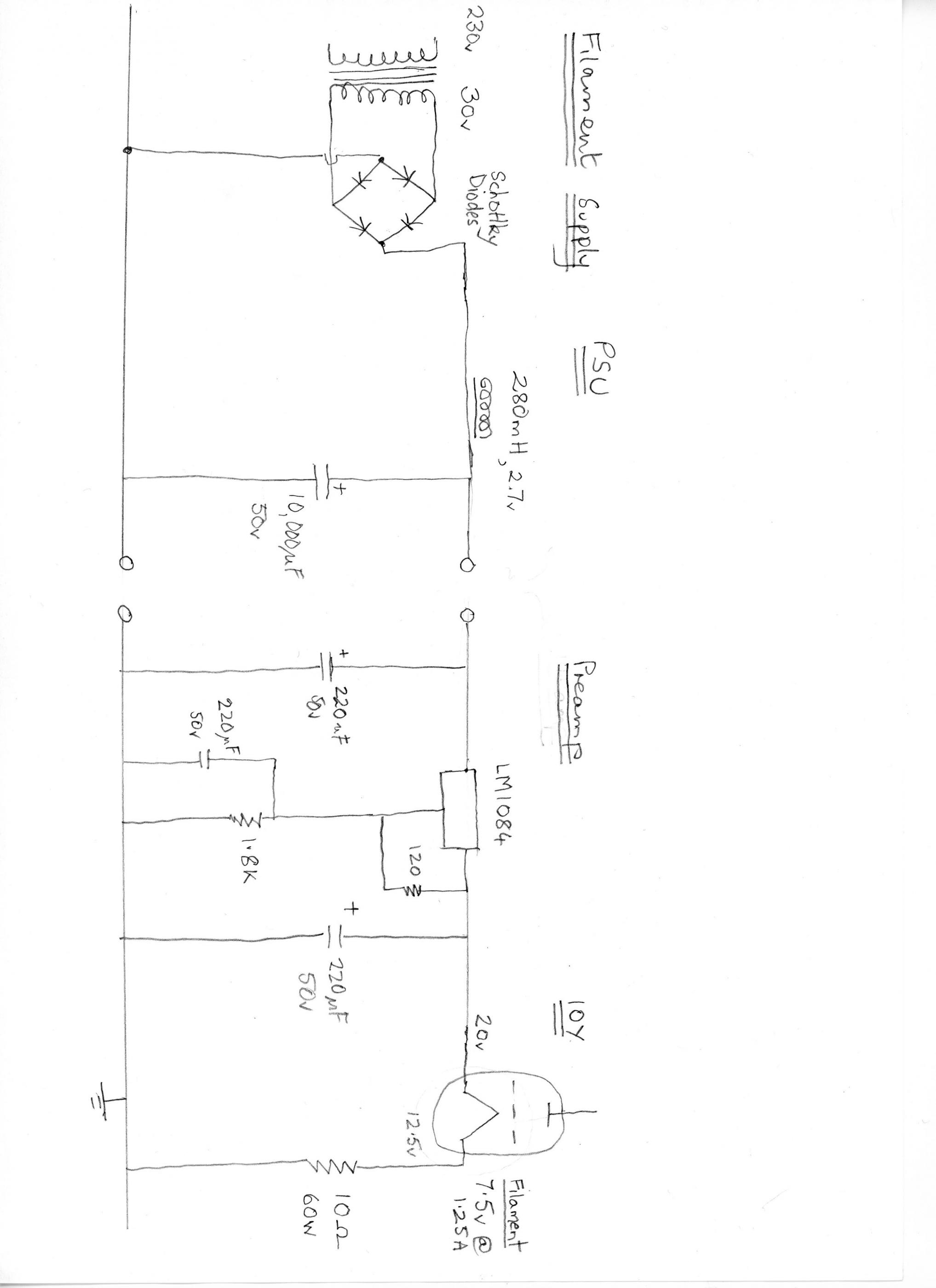

I have an application (tube DC filament supply for 10Y DHT in filament bias) requiring 20 volts adjustable +/- 2v at 1.25A steady current. I'm planning on at least 3 amps turn on surge. Currently using a LM1084 which though rated 5 amps is only rated 15v, and it cuts out on turn on.
So what's a simple circuit for achieving a comfortable 20v at 3A with plenty of margin? Supply voltage is choke input and can be anything from 24v to 29v depending if I put a small cap in front of the choke (280mH).
Need to get this built, so all ideas, links and schematics very welcome!

if the circuit needs 1.25A then I cannot see any reason for supplying a constant (adjustable) voltage.
I would use a Constant Current Source (CCS) set to 1.25A to feed the circuit.
A 317 can meet this current requirement but if the voltage drop across the 317 increases then the total dissipation of the 317 also increases.
Might be better to use a pair of 317 in parallel each set to ~630mA
The big advantage of the CCS feed is that current surge into the cold filament does not exist.
I recently built one of these to power a laptop computer(3A). With the 20 ohm pot it will give you 17.9 to 21.7V. You can add an output cap if you want to improve HF rejection but this will give you about 68db power supply rejection at 120hz without any capacitors.
M2 needs a good heatsink.
Needs about 3.5V Vin to Vout.

You can use 15 v regulator with 5v zener attached to its ground pin making "ground pin" of 15v regulator 5 v higher from common ground. now you have 15 + 5 = 20v regulator.>>

...I would use a Constant Current Source (CCS) set to 1.25A to feed the circuit. ...
Yes, that's a good solution for tube filaments - fix the current and voltage will respond to Ohms' law.
... A 317 can meet this current requirement but if the voltage drop across the 317 increases then the total dissipation of the 317 also increases.
This is true only if LM317 is used as a series voltage regulator. If you use it as a CCS it becomes very unreliable for currents greater than couple of hundreds of mA (Rset becomes too small).
The LM1084 makes a perfectly good CCS - for the 10y tube you need 1.25A which gives you a 1 ohm resistor at 3.2W so you need a 12 watter or more.
I got frustrated with not finding a solution to my shutting-down LM1084 in voltage reg mode, so I went back to a LCLC supply ending up in a common mode choke. Listening now - it's probably the most detailed version I've used but may be a trifle hard sounding compared to the solid state stuff. The supply is really much too big, so I'd still like to only use one choke.
The hunt for the perfect solid state solution goes on. Haven't tried the LM1084 as CCS yet - just wanted some sound!!!
andy
I'm sceptical of anything less than 5 amps (LM1084) and the LM350 is rated 3 amps. On the contrary it may be necessary to go up to a LT1083 at 7.5A. Why I don't know, but the damn LM1084 just shuts down. The steady current is only 1.25A but maybe it's the initial voltage that triggers the shut down - the supply is 33v off load - or the current surge on switch on or something. It's frustrating.
