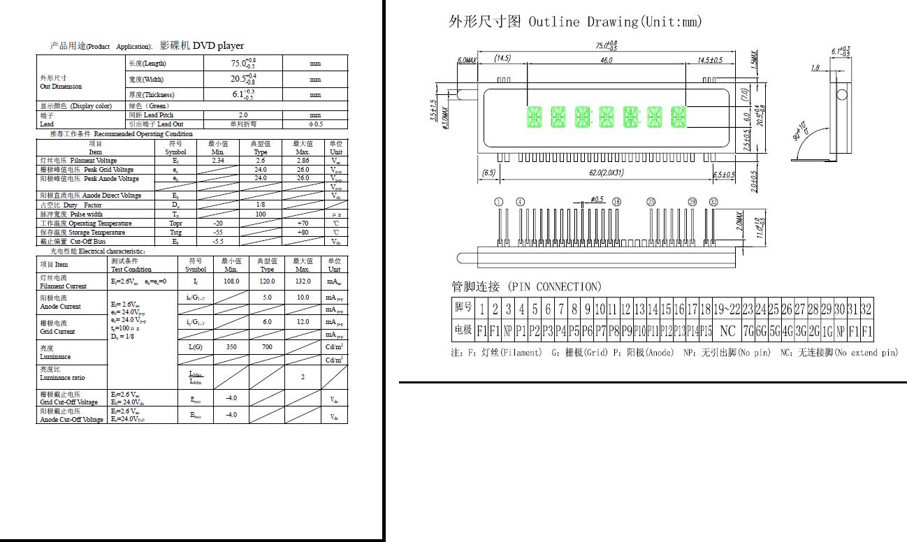

Need VFD display filament driver
Whoa, IIRC, the filament on VFD's is normally 3 volts, and -30 applied to the cathode to illuminate the segment.
Hey there,
for VFD as well as for other tubes, the (electron emitting) filament *is* the cathode.
But you are partly right, one has to distinguish between the voltage/current to heat the filament (probably a few volts) and the 'anode voltage' between the filament and the rest of the display - this will probably be the 30V mentioned.
A datasheet for the VFD would help! ;)
Greetings,
Rundmaus
Hellow to all,
The unit I am building is getting its supply from DC wall adapter & it is better if I avoid usage of transformer.
I had came across some Chinese amplifier where I found this VFD & its driver IC.
There they had used two additional winding of 3V/0.3A,28V/0.2A. For my case,
I need some converter chip to generate those from 3.3V.
I had attached VFD datasheet on previous my post:(..but it was bigger then the size mentioned. Anyways attaching only the relevant pages in JPEG form.
