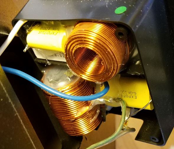

Examining the crossover (see picture at link below) it looks like there are two (yellow-coloured) caps. Both are Expotus brand, which from browsing this forum I understand are metalized film caps. One is marked "3.3K 100V", the other is marked "6.0K 100V".
Is my understanding correct that metalized films caps are unlikely to deteriorate and would not merit replacing?
The white component in the picture looks like a resistor. I can't make out the full brand name but the name ends in "opride" and the marking says "7W 3.3 ohm J".
Your advice would be much appreciated. Thank you.
I agree. No point in changing anything. Those film caps won't have deteriorated. Maybe the ferrofluid on the tweeter could be replaced. It tends to dry up and reduce output on tweeter.

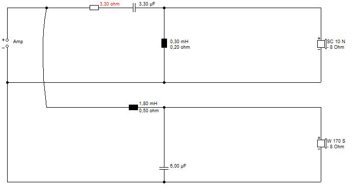

Best guess on a 3.5khZ crossover, for what appears to be a 8 ohm 6" plus 1" speaker.

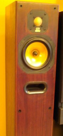

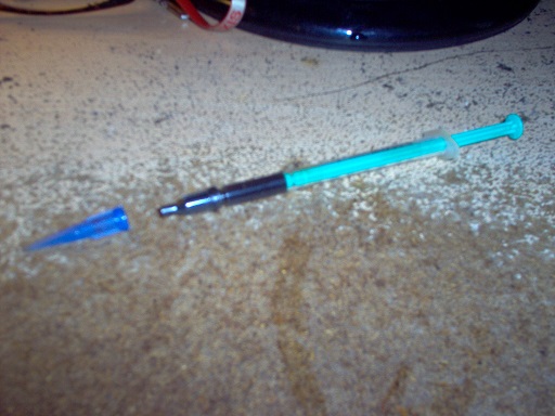

System7, I have done some reading on replacing ferrofluid. Looks doable but again there is some risk of ruining the tweeters. Any sense of the odds that the ferrofluid has dried out by now, or how to assess whether it has? (I read your thread on restoring MA R300/MDs with interest.)

These look like the voicecoil lifts off when you undo the 4 inner screws. Lift the coil up vertically. Hopefully the tinsel wires come up at the same time, though some designs need unsoldering first.

The above is the cheaper clip on type. Clean out the old gunge with a blotter and maybe a solvent like WD40 lubricating spray. Add about a 1/5 of the 0.5mL in the syringe. It's not critical. It's like oiling your bike chain.
