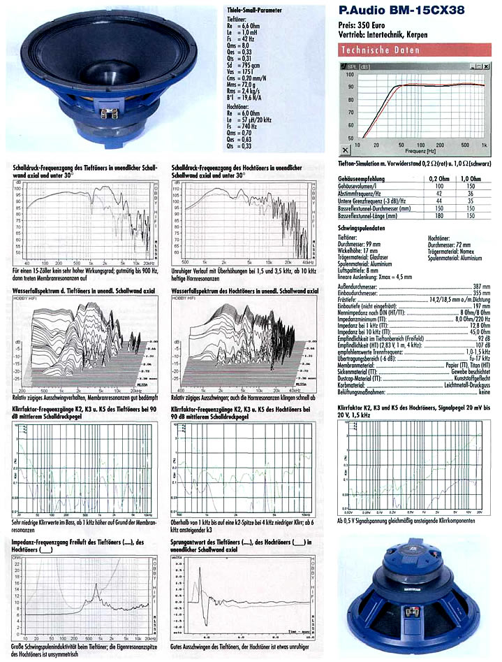

bm-15cx38, from Klang Und Ton(??)

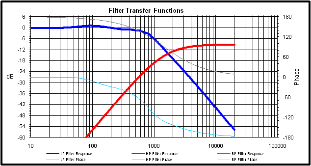

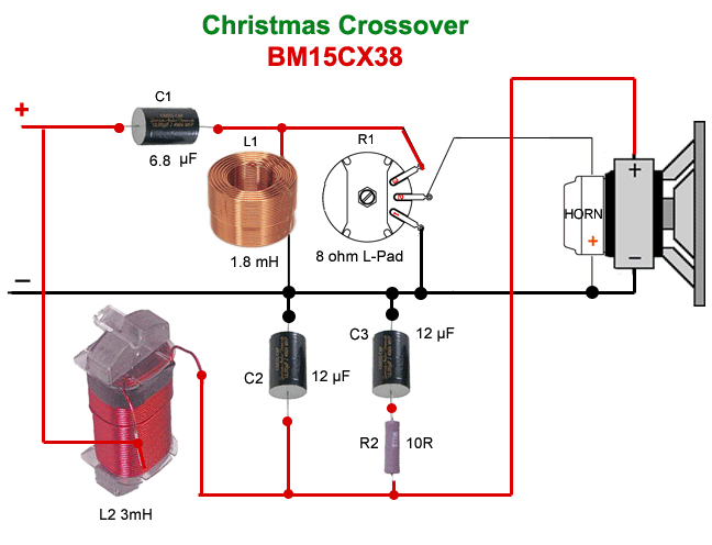

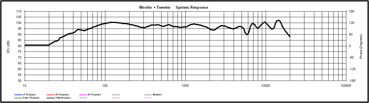

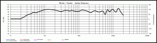

OK, here is what I came up with.
Some caveats.
This is done in software, not actual in room measurements or listening. It is important to understand that.
Response curves from P.Audio published FR. Impedance from P.Audio 18" coax.​
That said, the FR and impedance should be very close. As stated earlier, the main trouble is that both drivers have a midrange peak that gives these P.Audio coaxes a "P.A" sound. That hump is right at the crossover region, too. So what I have done is to spread the electrical x-over points to achieve close to 3rd order (Butterworth) acoustic slopes circa 1100Hz. This should achieve a fairly flat summation thru the midrange with a slight downward slope, depending on where you set your L-Pad.
The compression driver breakup is not dealt with, but a trap can be added later, if you feel you need it. It will sound better with a trap, but you can run without. Disregard the response below 100Hz as this does not include box or room.
It's simple and the diagram should let you wire it up with ease.
A 2nd order low pass on the woofer, 1 coil, 1 cap + a Zobel (cap & resistor).
2nd order high pass on the horn, 1 cap, 1 coil, 1 L-Pad for level. Horn is wired reverse polarity. Not much too it. This will sound sooooo much smoother and better than the single cap filter. Imaging should also be much improved.
You'll also see the filter function plotted, to give you an idea of the electrical slopes.
Please let me know if you have any questions. Have fun with it!!

I really dig it. Sounds so much better then the single cap.I have wondered how a trap would sound but never looked into it. When ran on the DEQX ( that thing is great!)
I can do pretty much anything I want but you have to have two amps.
Next will be to try it OB. Pano im sure you know a thing or two about that!
