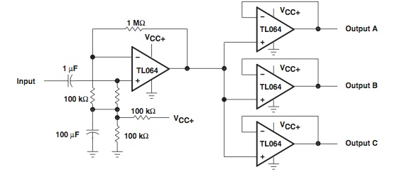

I'm planning to tweak one Car CD-player (Honda Accord 2008).
It hasn't pre outs, so I'll try to make some and get signal before power amp.
But I'm worrying about one problem. I need 2 or 3 line outs to make per-channel amplification (some kind of bi-amp).
And I think that paralleling 3 outs is not very good idea, right?
Can You please give me advice how can i make this? Maybe some kind of simple buffer based on opamp? I would be very pleased if someone share scheme of this...

If the pre-amp (really it's a line amp, as the output voltage stays the same) has a robust output stage and all the power amps have the same type input stage, than the pre-line-buffer-amp should have no problems driving several amps. Problems sometimes arise with amp inputs that but different demands on the buffer. Turning one of the amps off can cause high distortion in the other connected amps.

It's actually not line-amp, but pre-amp-out because it is placed right before the amp stage...
I just worried about output resistance and signal level of pre amp stage. If normal out has x kiliohms, than 3 paralleled will have about three time lower, right? And normal output level is ~2V, than paralleling three out will have the same value or lower?

I just need to know the best way to get 3 pre outs from stock (without factory pre-outs) system 🙂

No thanks, 250V without skills - it's very dangerous in car.
I need simple solution for 0...9V or +\-12...15V

It's not case of commercial, I just help someone to build SQ car and now we are thinking over future project, before buying amps and loudspeakers.Better if it's not your car ! You can ask a lot for charge and keep the rest..
Thank You. It looks like subj 🙂
What is the "name" of this scheme? I would like to search addition info about this.
