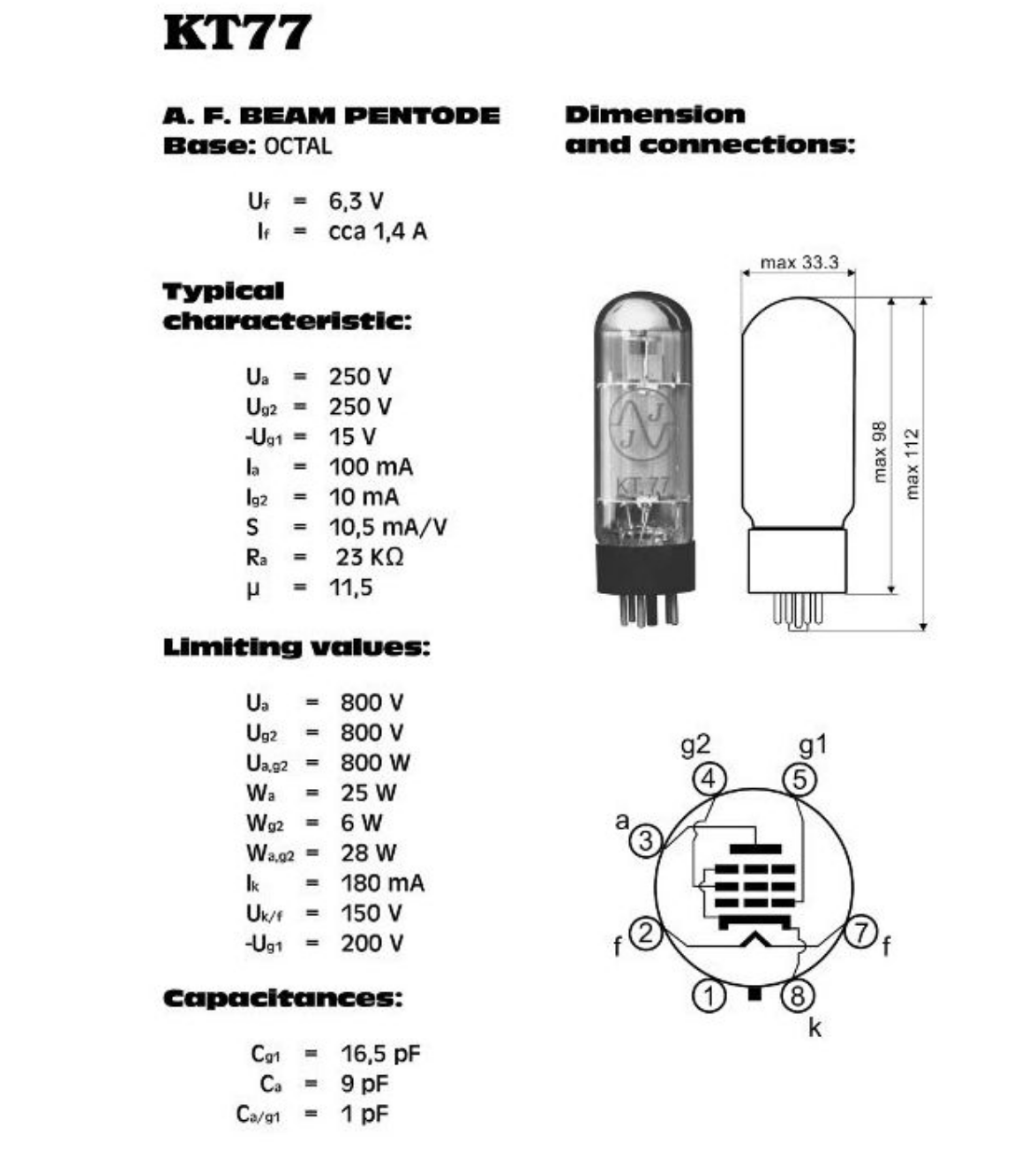

KT77 is a pentode. Treat it as an EL34.
The load depends upon the HT.

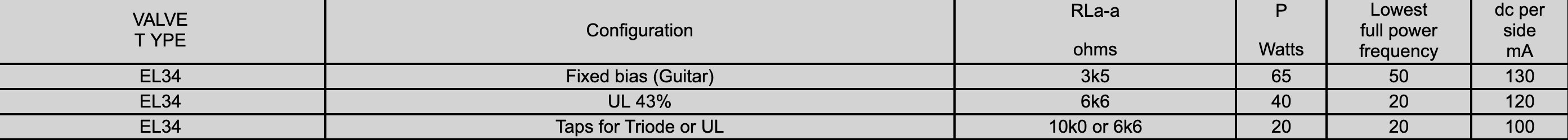

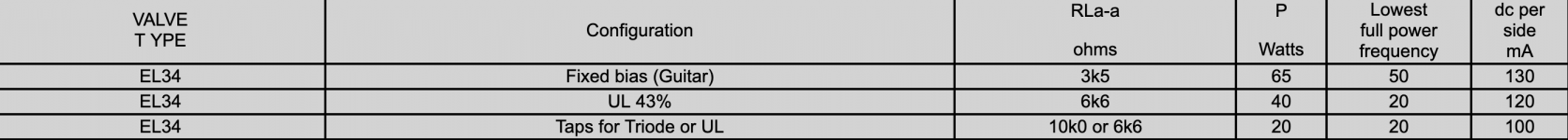

Looking at the Genalex KT77 data sheet and for PP UL, it shows Va=500V with Rload =5.5k, then Va=600V with Rload=9k.

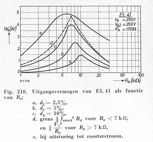

This diagram for the EL41 shows load impedance versus output power for five levels of second harmonic distortion at Va = Vg2 = 250 V (curve "e" represents the power output at the start of control grid current). From it one can deduce that the second harmonic distortion at a certain output power level increases when the load impedance deviates (in both directions) from the optimum load (7K).

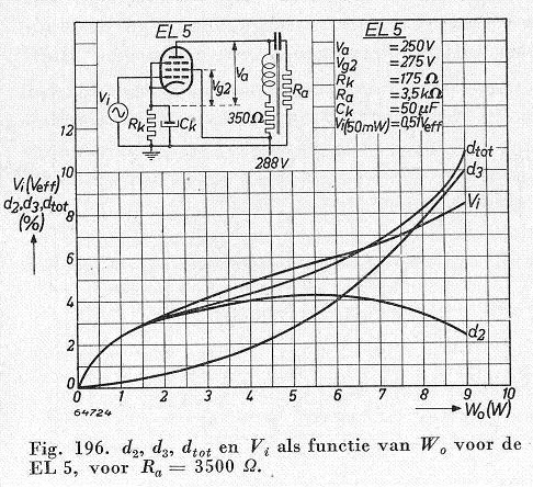

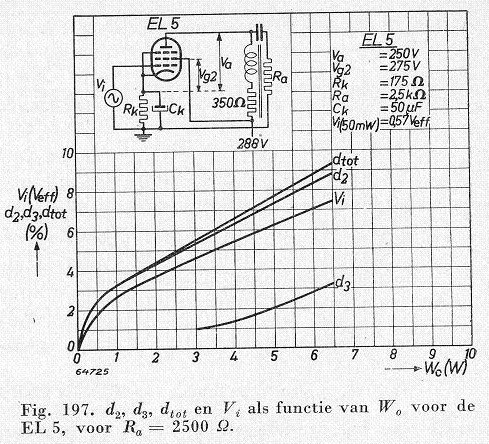

The following diagrams for the EL5 at Va = 250 V and Vg2 = 275 V show that at the cost of some output power, a somewhat lower load impedance (2K5) than the optimum load impedance (3K5) makes that the total harmonic distortion is made up of a bit less third harmonic distortion and some more second harmonic distortion. If you compare the two for 6.5 Watt output power you get:
  • 3K5: d2 = 4 % and d3 = 5 %
  • 2K5: d2 = 9 % and d3 = 3 %

I divided ra by five and I get:
