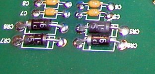

I'm looking to replace those diodes, and don't know where to find them. The print says: GP15B 9532. Thanks for any assistance.

The general instrument data book lists GP15B as:
glass passivated junction plastic rectifier..
100 volts, 1.5 amperes.
Peak forward surge 50 amps half sine.
1.1 volts forward at 1.5 amps
full load reverse current Tambient=55C, leads .375 inches., 100uA.
5 uA at 25C
200 uA at 150 C
2 uSec Trr
15 pF. (1 mHz, 4 vdc)
25 degrees C per watt, straight line derating from 60 C to 175.
operating and storage -65 to 175 C.
30 mil leads..plated
Hope that's enough...
