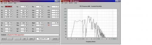

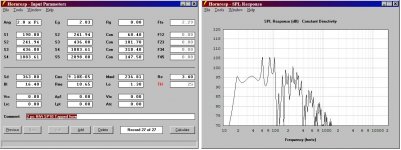

I did a quick and dirty tapped horn with your driver. It really has no gain but here it is. How close is it to what you came up with?

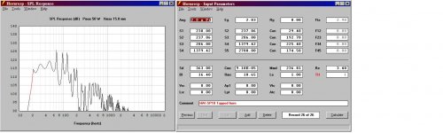

I also post a quick and dirty SP10 box. This is actually a great driver for a tapped horn. The last post is a 1 watt input for the HiVi driver. Not to shabby considering it is 84 db/watt in a normal box. THe uneven response is never there in real life so don't sweat it. This driver can really be a contender for a true tapped horn. Some more tweaking of the design could smooth it out some more and shrink it a bit. But it is really not all that bad to begin with. I'm kind of proud after about 10 minutes with the design. But me thinks shipping would kill me for this driver. 13kg! Almost 30 lbs!
It's not bad at all... my best modeling for it has it at an 18Hz or so corner with a small throat (60cc) and small mouth (500cc), 5:1 compression ratio. Response looks really smooth that way. Actually it's modeling better for me now than it was this morning... I guess lack of sleep is a bad thing 😉
I still prefer the SDX10 for my next project though, just because I can get 'em cheaper and easier.
