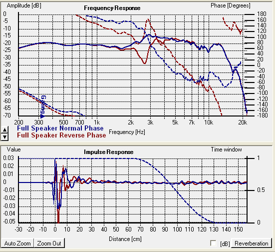

With the measurement capability that you have, did you invert the polarity of the tweeter and measure spl? That might help identify the crossover point, and possibly more.

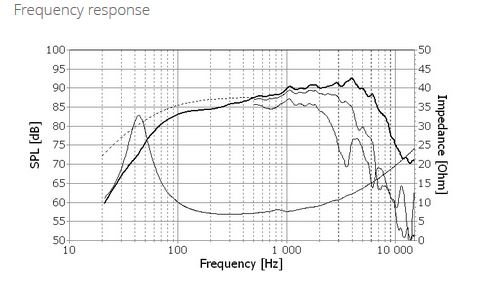

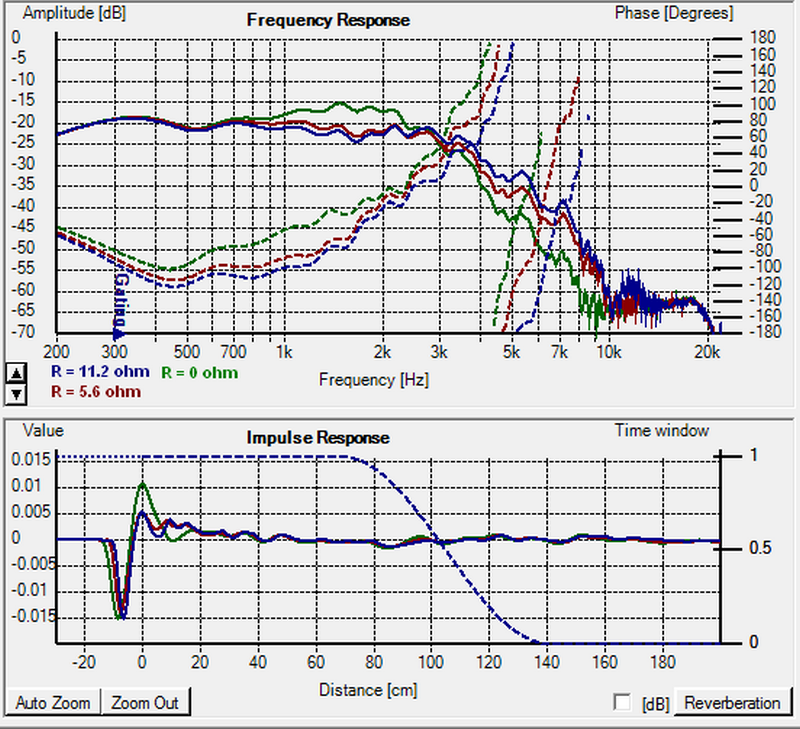

I have some thoughts on this peaky response. I think an HM170 Aerogel woofer is quite naturally able to run near-crossoverless. But that creates the peak:

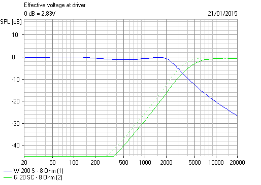

I don't see why you couldn't give it an Idunn bass crossover:

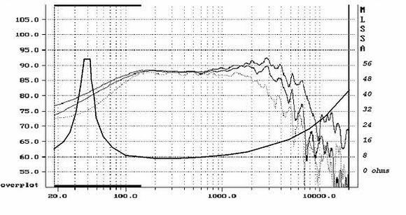

The SEAS U18RNX-P is rather similar to the Audax HM170Z18.

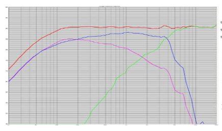

Dear Brakspear, from the curves attached in post n6 it is apparent that the peak comes from the tweeter crossover/driver. I would advise you to change the 6μ8 capacitor to 3μ9 or even 3μ3. Tweeter (and sum) output will fall (I expect about 4-5dB in the 3KHz region and progressively less up to about 9KHz), phase relationships between drivers will not change drastically, total impedance will have a (positive) peak in the 5KHz region.
On the other hand, output in the region 1.2KHz to 2.5KHz will be then somewhat lower than ideal. You would then feel tempted to change values in the woofer RC circuit to fill in the gap (by lowering the cap value – from 15μF to 10μ or even 6μ8).
So, you could begin with changing the 6μ8 capacitor in one speaker, take a measurement, proceed accordingly. Not to much work.

PS. I have measured the FR with reverse polarity on the tweeters but forgot to save the graphs! They didn't look nice, phase was all over the place. I don't have an Spl meter but I may re-visit this measurement with the new caps, just to get more data on how the circuits behave.

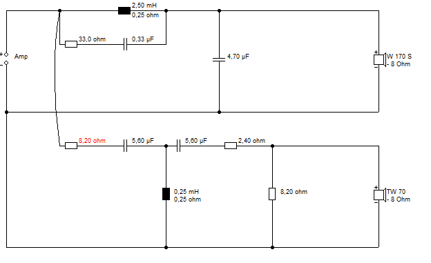

Frankly, 6" bass is a tough speaker. I never get it sounding too good. Here's one of my current ideas, with a notch around 5kHz.
The notch depends on the coil and capacitor value. I don't much like it anyway. Too bright IMO. 😕

I think with some simple changes to the crossover you can get a lot better results. FYI, putting caps in series reduces the value, putting them in parallel adds the values. Keep that in mind when searching for a value on the tweeter.

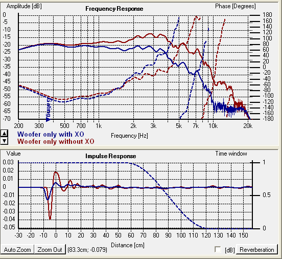

Have you tried measuring the FR's of the woofer and tweeter without the xover attached? Comparing these to the measurements you have made will give you a picture of the effects of the existing xover on the driver FR's.

Ditto what Robert says. Always good to see what the drivers do without the crossover.
If you use the High Pass function down to the right of the impulse window, you can start the sweep higher for the tweeter. That keeps low end out of it without the crossover. Maybe high pass at 600Hz. Check this function first on the woofer to be sure you have it working.

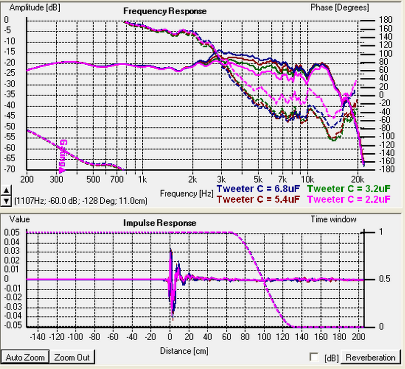

I've now got the new 15uF caps in the woofer XO circuit and they sound excellent. Just to confirm the earlier data I tried shorting the resistors in the woofer circuit and measured the effect but I haven't done the nearfield measurements to extend the data to the bass range.

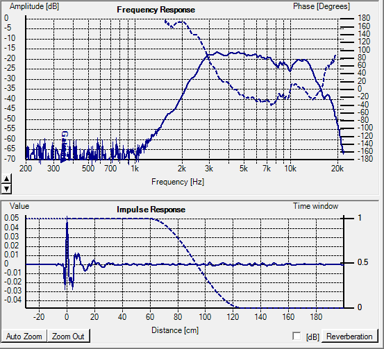

I also got a few low value PET caps so I could mess around with the tweeter XO and I've posted the graphs below. Lowering the tweeter capacitance to 3.3uF looks like the way to go. For some reason I couldn't get Holmimpulse to work with a high pass filter in place - it cut out everything below 1kHz as I wanted but at the same time stopped the sweep signal at ~2.5kHz, which was useless. If anyone knows how to get round this I'll post the data for the tweeter with and without the crossover, at the moment the graph below only shows the response with the crossover in place.
By using the caps I already have I've currently got the value at 3.1uF and am getting used to the sound - once I'm happy that this is what I want I'll get some polypropylene caps and hook it up permanently. Thanks to everyone for your assistance, I really would not have known how to sort this out by myself

Good work! Looks like real progress.
Glad we could help.
Only think I now see is that you are a little hot circa 3K. At least on axis. That may smooth out of axis or at the listening position. A 3K bump can sound a little forward, but will make voices clear. Without changing the woofer inductor, it won't get much better.
As for HOLM, you may have had the low pass filter engaged as well as the high pass? That's all I can think of.

What you've done looks about right. Reduce 6.8uF to 4.7uF. That'll reduce the 3 to 6kHz range by about 2dB.
A 3.3uF takes out about 4dB, and would lose you a lot of energy above 3kHz. Might even sound like a serious hole in the response.

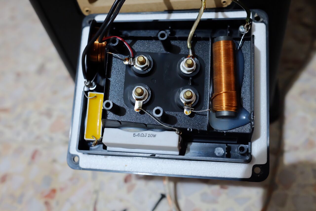

im new here and new to hifi world also. how this project has been so far?.. its been a year now.. but im interested in the result. just got myself mission 752 freedom for 21usd in mint condition 😀.. i love what i hear but im looking for xover upgrade (more to replacing caps/resistor/inductor with better one).. not really know about electronic stuff but my xover seem different compare to Brakspear75 showed.
for the woofer its just got an inductor to it, not sure what its value. and for the tweeter i can see two 5.6ohm 10w resistor and 1 4.7uf 100v, not sure about the inductor value also.
plan to replacing the caps with sonicap and both resistor with mills.. anyone got idea what the value for both inductor? might go to flat copper foil
