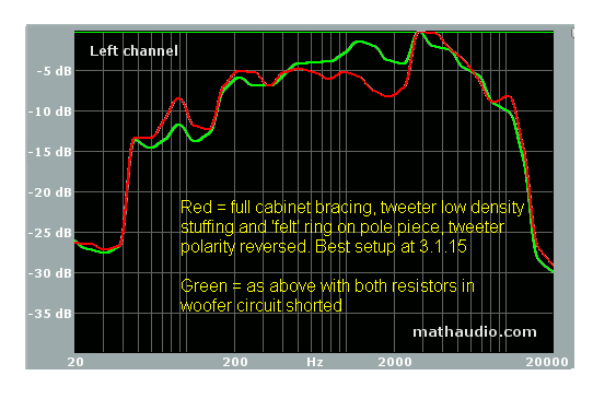

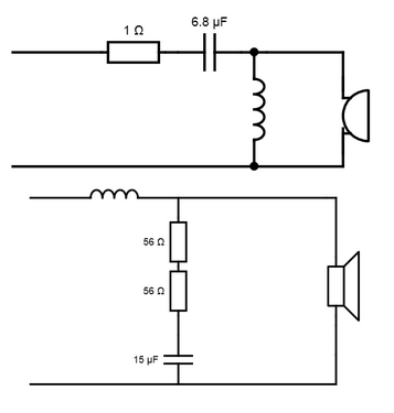

I've recently been modifying my speakers, some old Mission 752's, by adding cabinet bracing, felt etc but nothing I've found on physical mods gets rid of a frequency response peak at ~3600Hz which I think is the crossover frequency. I've searched for info on the crossover and traced the circuit in the speakers - unfortunately I don't have values for the inductors (or an LCR meter) or any detail on the drivers themselves. I think the woofer is a 6.5" Audax aerogel unit and the tweeter a Peerless 19mm but both have been re-badged as Mission drivers so I can't find the specs. The circuit diagram and FR graph are attached below - red line is the current response.
I have no experience at all with crossover design so I'm hoping someone will be kind enough to point me in the right direction; for now I have a few questions
1) The speakers are over 20 years old and have never been re-capped - could the unwanted peak be due to the 15uF non-polar electrolytics failing?
2) The 6.8uF capacitor is a polystyrene dielectric, would changing this to polypropylene give a worthwhile improvement in sound?
3) Does anyone know the values for the inductors - if not can anyone still suggest which component I might best replace and with what value to give a flatter FR?

Are you sure that those resistors series with the woofer cap are 56 ohms? Because it does not make much sense..... 112 ohms in series with 15uF does virtually nothing in that circuit. If they are REALLY 56 ohmers, try to reduce their value to somewhere around 10-12 ohms, and listen again. Also there is a good chance that the 15 uF bipolars dried out, so replace them with similar value caps (foil cap will be even better than bipolar).
That's quite a peak! Must sound bright.
If that is the crossover frequency, you could try a modification by reducing the value of the tweeter cap. If it's 6.8uF now, try half or something similar. What that will do is cross the tweeter higher, maybe attenuating that peak. You spread the crossover frequencies a little.
Easy to try, and you should be able to hear and measure it. Not a final solution, but a path to one.

Here are some other things you could try:
It won't hurt anything to run just one section at a time and it will tell us a lot about what is going on.
- Bypass one, then both resistors. Use a bit of wire or a clip lead.
Measure each section on its own. Post those measurements here.
Measure the woofer trying the resistor bypass

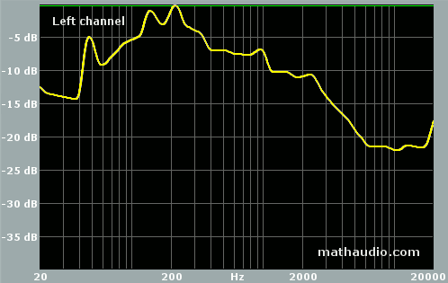

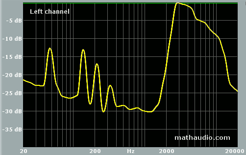

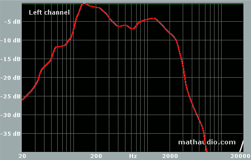

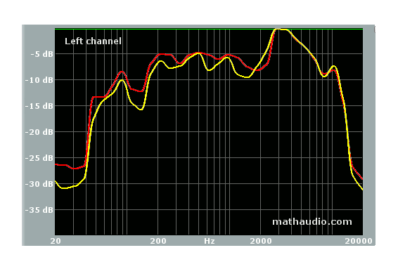

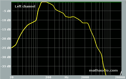

Thanks for the suggestions - below are the FR's for the individual drivers, tweeters measured at 1m and woofers nearfield at 5cm, hope that's the right way to do it!
I haven't bypassed the resistors yet - this is FR as the circuit is shown (ignoring errors...). I'll post the FR's with the resistors bypassed once I've done them.
You have surely measurement errors (spikes present on both drivers).
Besides that, the right method is to gate, without gating you measure also the reflections. And are you sure your mic is flat?

Thanks for the measurements, they say a lot.
Don't really understand that crossover, unless things have really aged over 20 years. For the moment, I'd say leave both woofer resistors in bypass and then worry about the tweeter.
Don't know why the tweeter plot falls off like that. Could be any number of things.
If it were mine, I'd want to flatten it some. A little roll-off will sound good, that that's too much. Looks to me like a peak caused by incorrect values.
Try something like a 4uF or 5uF cap. Maybe as low as 3uF. That might kill the bottom peak of the tweeter and flatten it some. If you can get a handful of ~1uF caps and stack them in parallel, that can help you narrow down the value that will work. No need to go expensive, just get what you can to test with.
- Incorrect component values
- Bad tweeter
- Mic response
- All of the above

Hi Ralf, I only have the one mic and it's not calibrated, but I'd hope it's not out by 5dB at 3600Hz! If it is it's a strange coincidence that it aligns with the crossover freq so exactly. Also the speakers do sound bright, although not unacceptably so (maybe I've just got used to it).
Not sure what you mean by gating but I almost certainly don't have the equipment to do it...I thought the idea with measuring woofers nearfield was to minimise reflections? I'm happy to try other measurement methods so long as they don't cost much - I can spring for a few caps but I'd rather not buy a new mic/soundcard/software etc.
I doubt you need to worry about a new soundcard. The mic, hard to say without knowing what it is! 🙂
(but it's not likely off at the crossover frequency)
I concur that the mic is unlikely off right at the crossover frequency, but I'd take the results with a grain of salt.

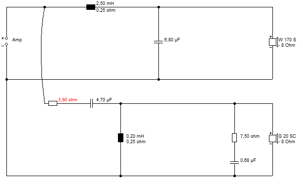

The circuit below is a good stab at a typical 6" driver.
Audax HM170Z10 Aerogel 17cm 6.50" woofer
I can't say what the exact value of the tweeter resistor will be though. I'm guessing 3.9R, but select on test.

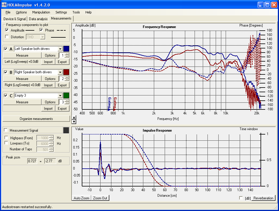

It seems ARTA really doesn't like my pc, so Holmimpulse it is, thanks ief. The measurements were taken on axis at 80cm with the closest surface being the floor at ~ 75cm so despite my mic not being sensitive enough to pick up the reflections the data should be accurate enough around the crossover frequency. Please note that I've removed the shorting links across the resistors as this cut the bass output too much without doing much to the unwanted peak - a comparison of the FR's using the old measuring method is attached.
There's quite a difference between the speakers so I guess the caps probably have dried up - I'll replace the 15uF caps first and then see what the measurements look like. Any recommendations as to sensibly priced replacements - I'm happy to go with the suggestion of foil caps as being higher quality? And a cheap source in the UK?
Glad to see you've got HOLM running. It's my favorite. You can loosen up the gate a little. 800Hz is high.

It would still be nice to see the woofer without the resistors. Try again after you get new caps. Let's see what the curves show. In your previous measurements the woofer looked better without the resistors.
