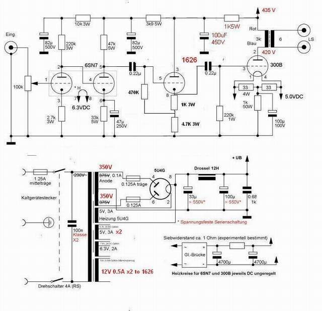

Frequency response of that amp will depend on the quality of the output transformer. That is not easy to model accurately in LTspice. Since this amp is single-ended, it will need a very, very good OPT, which will cost $$. A push-pull amp would have better frequency response and give more power from a smaller, cheaper output transformer, but it will be push-pull. Some people don't like that.
That last schematic is basically the classic 3-stage 6SN7 > 6SN7 > 300B single-ended design, with a 1626 cathode follower between the 2nd 6SN7 plate and 300B grid. It still would only make about 7 or 8 watts output. It's a good idea, but I'm sure somebody here will state (correctly) that it would be better to DC-couple the 6SN7 plate to the 300B grid, so you can get some A2 (grid current) operation of the 300B for a few more usable watts of output power.
Probably the better way to do this would be to use a MOSFET source follower instead of the 1626 cathode follower. This could be DC-coupled from the second 6SN7 plate, with the MOSFET source RC-coupled to the 300B grid.

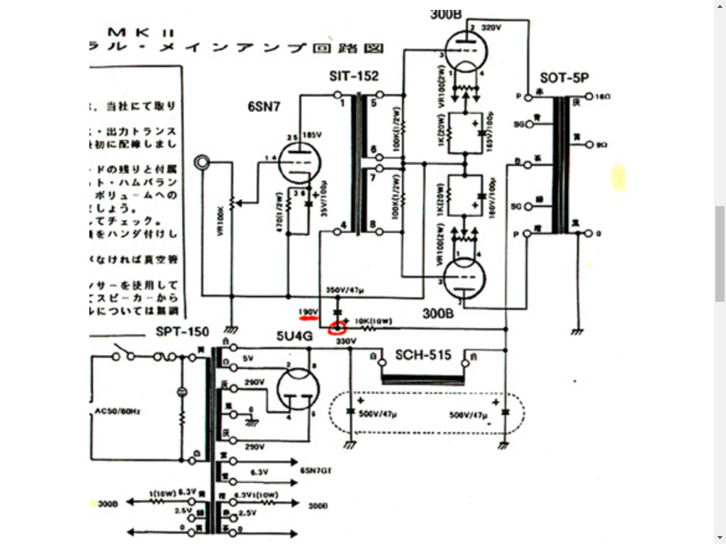

This Sun audio of Japan might more suitable for me. It produce 25 Watts.
It can drive both my old B&W 603 S3 and of course "Dali Zensor 3".
I have to try to understand how to build this amp. I don't know what are choke & transformer of
SCH-515 ( I think it is 10H choke)
ST-152 ( I don't know this transformer) Anyone can help?
SOT-5P ( I think it is output transformer) Anyone can help?

I just don't understand the value of 2 transformers in 300B push pull.
Can anyone explain please?
1. SIT-152 (what is this 8-Pin transformer???) What value I need?
2. SOT-5P (output transformer)

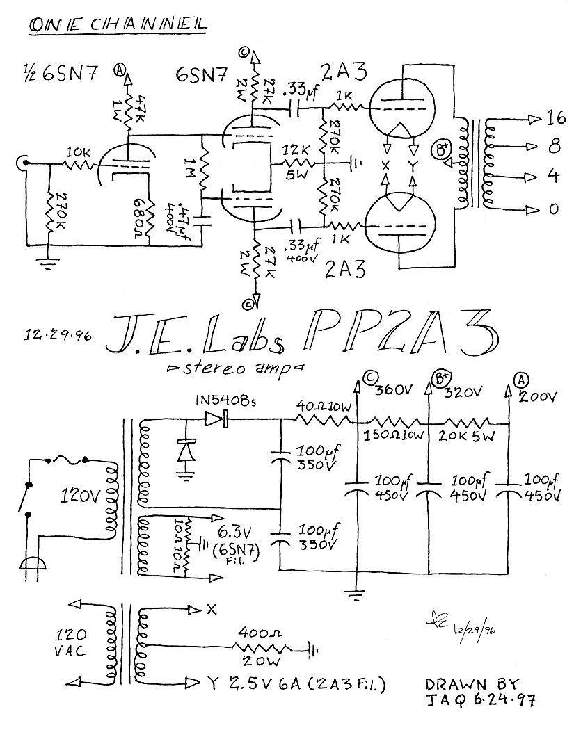

Just found other link of 2A3
http://www.diyaudio.com/forums/tubes-valves/194645-chinese-amp-2a3-6sn7-6sj7-5z5p-push-pull.html

Another schematic 6SN7 2A3
It is also interesting 🙂

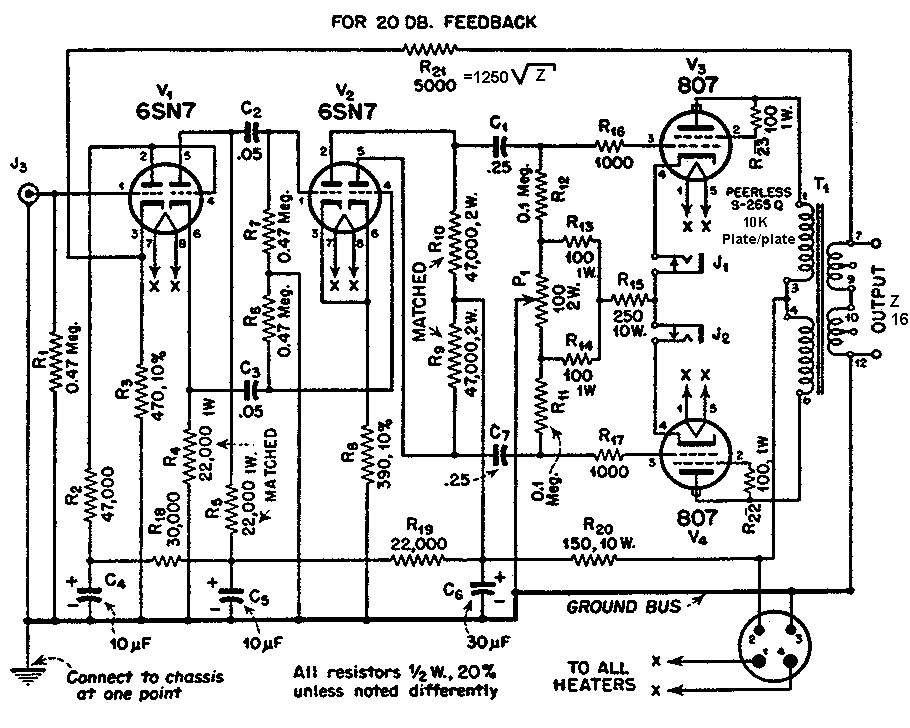

Or the easy old one from audioroot website 807 Push Pull 30 W
Amplifiers | audioroot
More homework to do 😀

SIT-152 is an interstage transformer used for phase splitting. It will probably be a very expensive part.

PS - The JE Labs and Analogmetric circuits are actually very similar to each other. They will not make 15 watts per channel. More like about 6 to 8 watts per channel.
