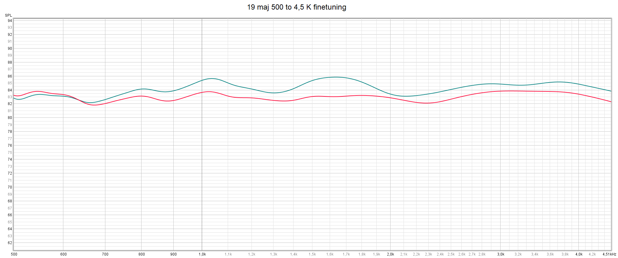

Yes i´ve workt many many hours on this diy speakers/xovers, and around 19 may i was minutes from "a completly finished perfect xover", but i had work so much many day in a row, so my bad back and neck was hurting like hell.
So i decided to give my "body" a few days rest, but 2 days later my daughter & her friend run in to my xover ( laying on the floor, and 60+ other loose xover-components)) when they played, so every solderpoint on the " finished xover " come loose and was mixed with all other 60+ components !
That filter was supergood and build in only 1 week without notchfilter etc, and even without having impedance curve for the AGA driver or real made impedance curves in the actual boxes for all the drivers.
Work´t on 3-4 different xover at the time and made many notes ( I thought), but REW craches from time to time, and almost no mesaurement was left from that timeperiod.....And my head was "full" and had a little of "everything", but even now 3 months later and with all correct curves for the drivers, i still can´t come back to the same "point".
It´s sad but im learning "by misstakes" the hard way. ( will never work on 3-4 xover at the same time again, and make more evident notes)
The speaker sound great Ray, but need to decide the "exact" xover, so i finaly can put it in and finish the speakers back-plate and smal other things.
I will look at the link 👍
And i know my filter-curves are not symmetrical compared to design norms, and i know how they should look like
But the low-mids smal box, and the AGA complicated spl and impedance curve, made me to try it all.

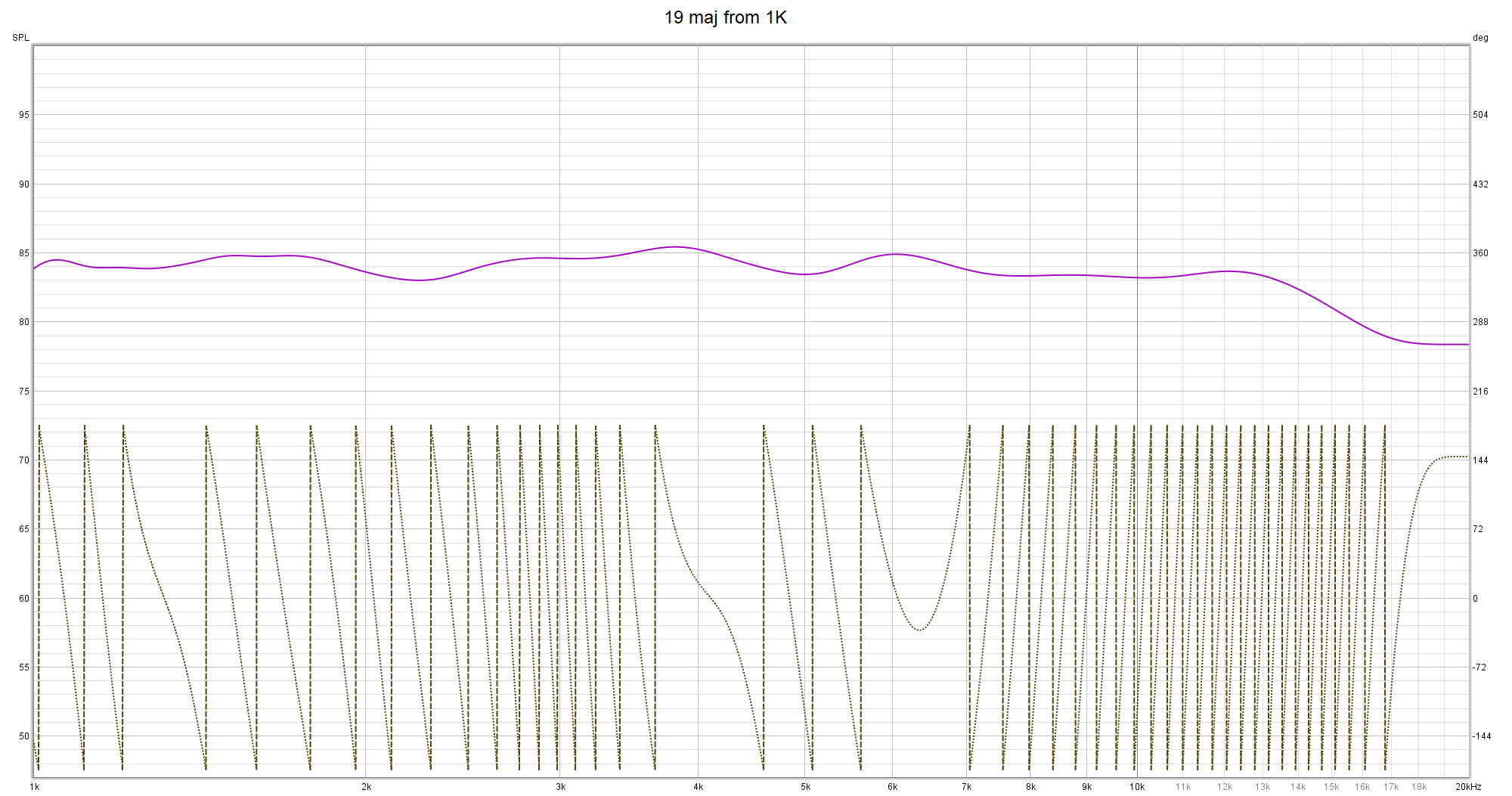

This was my mesaurements from maj........In a png file, but real mesaurements and notes are gone from one of REW many craches
Take care Ray !

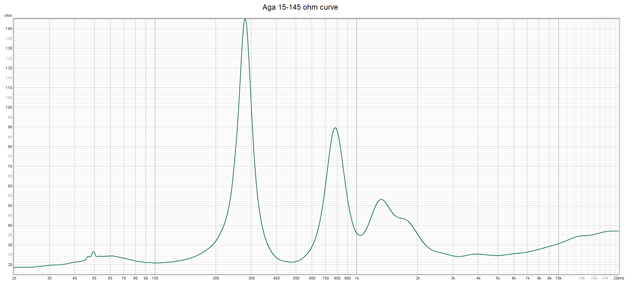

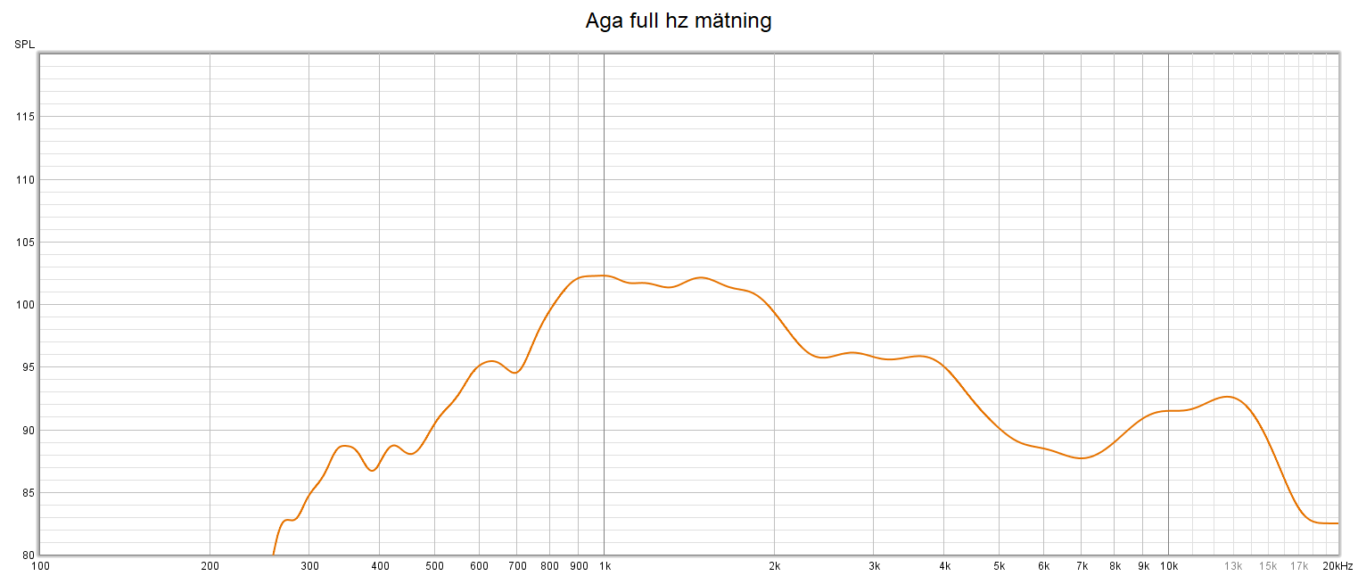

Have you some solutions for E145 and AGA drivers ?.....feel im stuck in my brain.

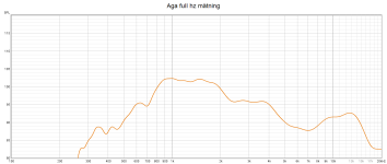

This is tha AGA spl curve in the horn and the impedance curve i have to work with,.

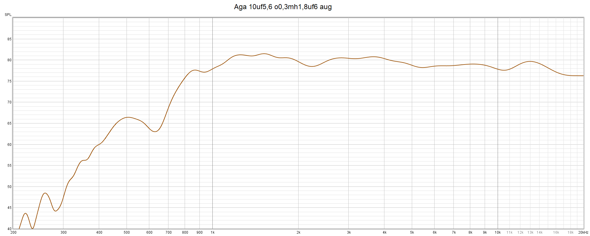

and also a minimal xover with 10 uF, 5,6 ohm to ground, 0,3 mH and 1,8 uF to ground.

Your Aga10uf5 .6 graph looks well listenable to me.
Yea Ray, it´s simple and cheep and sounds good 👍 ( But maby can sound better ???, nobody knows before trying)
It was a test after "the accident", when i was frustrated, don´t know if the xover/ filter topology is bad in some way, but maby you know.

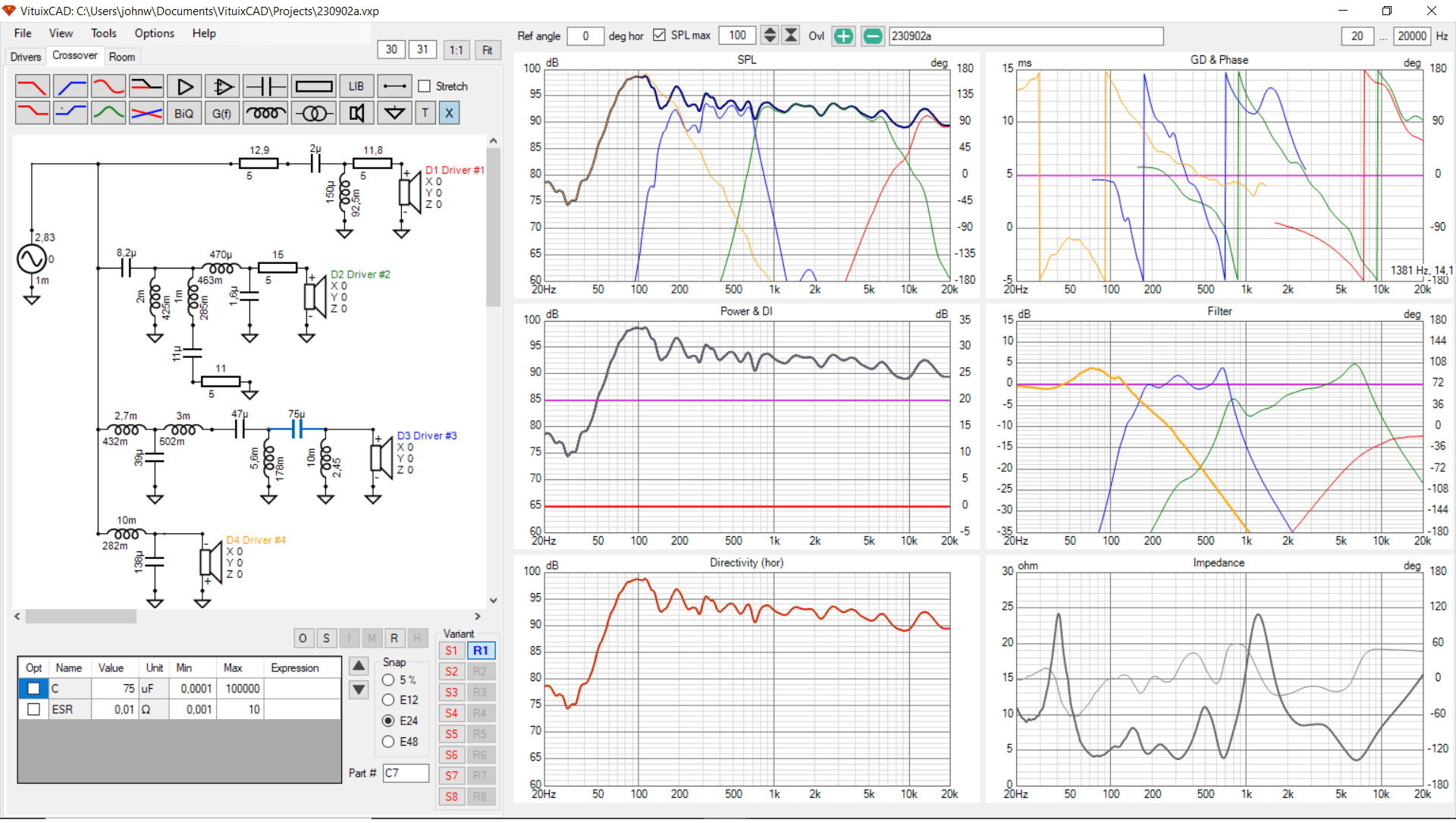

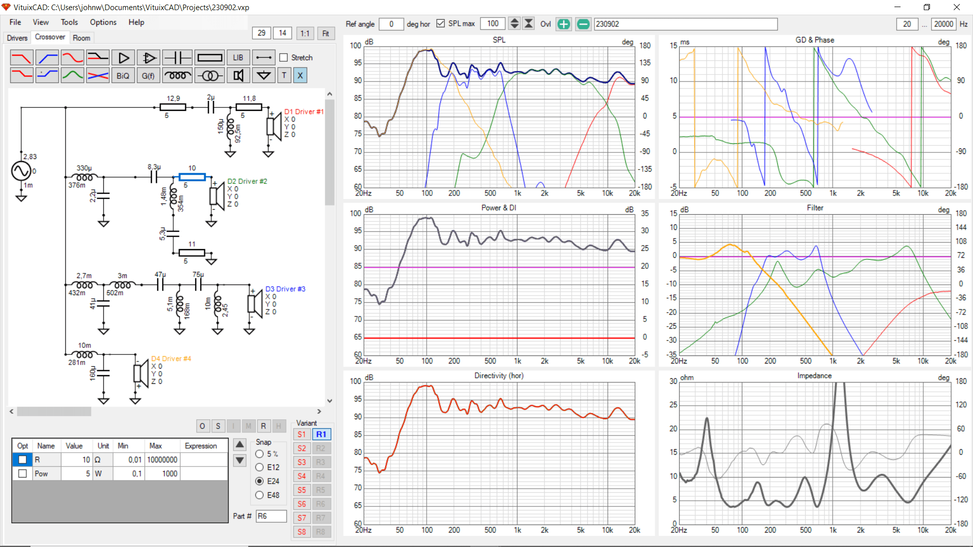

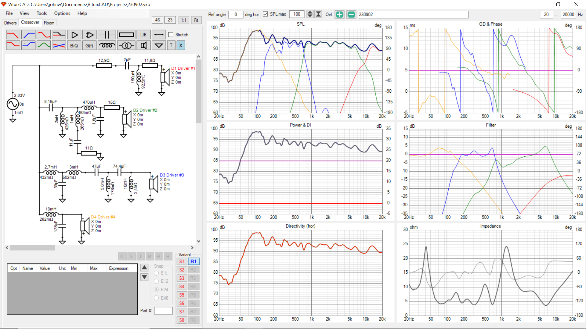

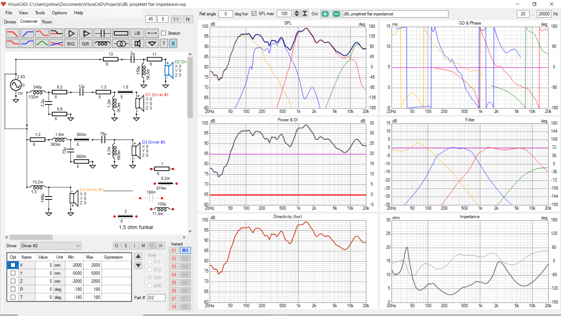

Hi again kaameelis
I took you word and have really tried to follow your and Ray´s advice, and have stuggle with a almost impossible assignment.
Really can´t get nice "Filter-frequency-curves" on all drivers together, and the same time have real good SPL-response and keep me over 3,8 ohm.
This is the best i can do, and i have made 3 different xovers to show you guy´s, and ask you if one of them is "more right"
Been a nightmare to raise impedance so i can use the speaker both with one amp or Bi-amp it with stronger amp for the woofer and low-mid.
Any questions or information on the xovers i have simulated is much appreciated.
Best regars John

Hi Jawen,
Thanks a lot, that's a real tricky question as we haven't heard them and we may not like the sound you are after.
The second and the third iteration look reasonable enough. Not sure why you have so much going on around 700 - 1100Hz? Maybe try the mike in a different position to see if that changes ?
A question if you ignore the overall frequency response shape and make the drivers behave without the peaks at the end or beginning of the passband what does your response then look like. At the same time what happens if you drop your resolution to a 6th or a third of an octave? I sometime do this to help me understand if i have a major issue or I have become fixated on one bump?
Good luck. 🙂

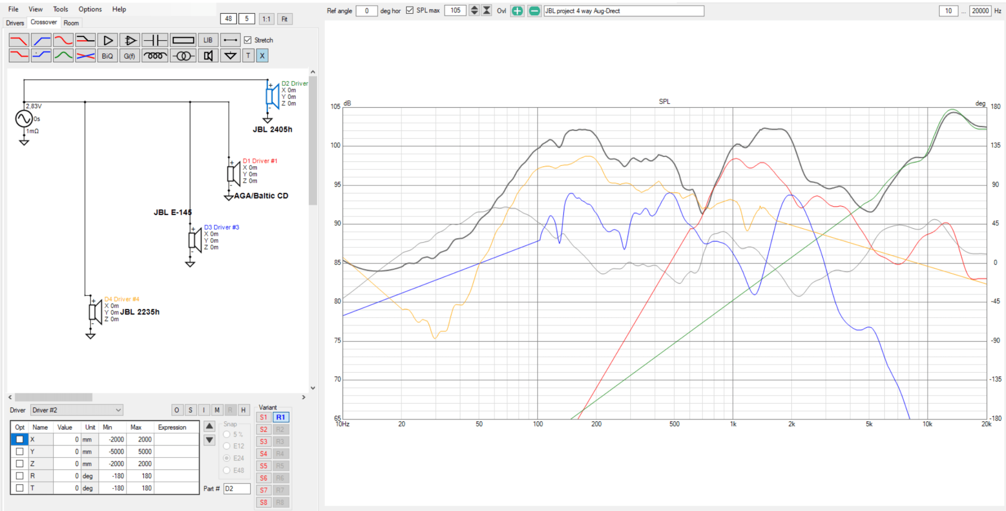

To visualize the complexity I made naked project without filters, naked drivers FR-s.
From this can be seen what frequencies is reasonable to select for filters.
