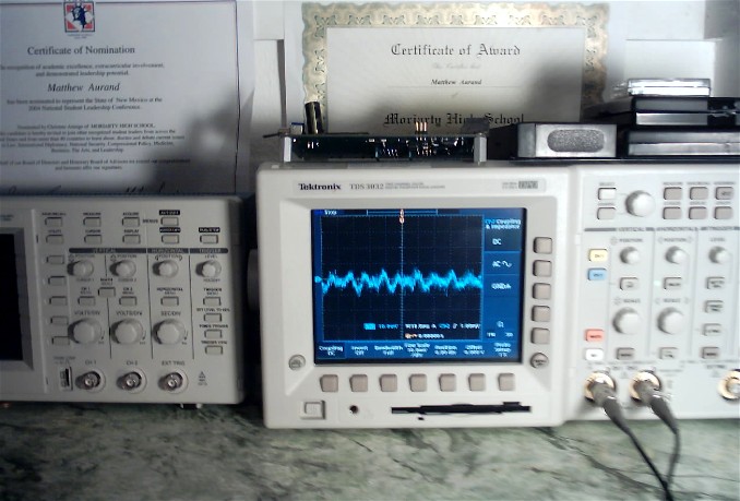

Here is a picture of an audio waveform from my portable CD player...I was just playing around like you should 😀 Can you tell it is metal? 😉
