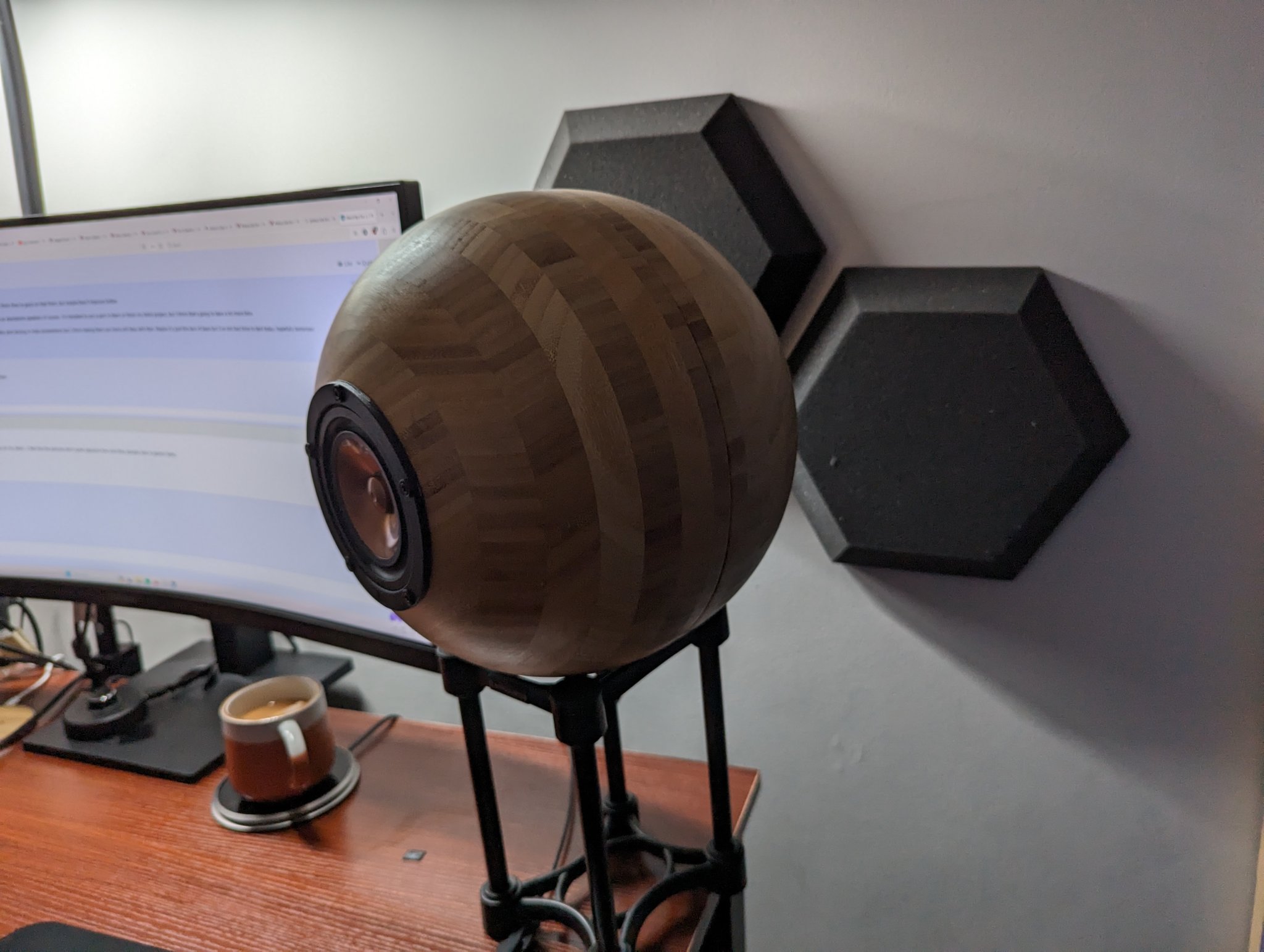

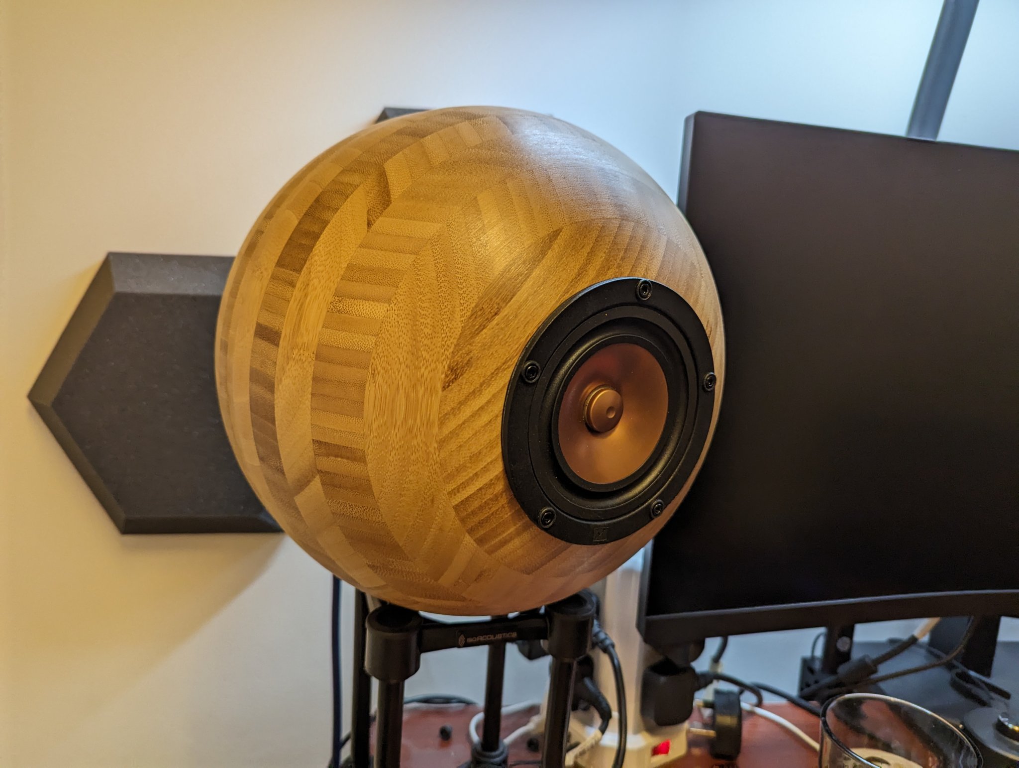

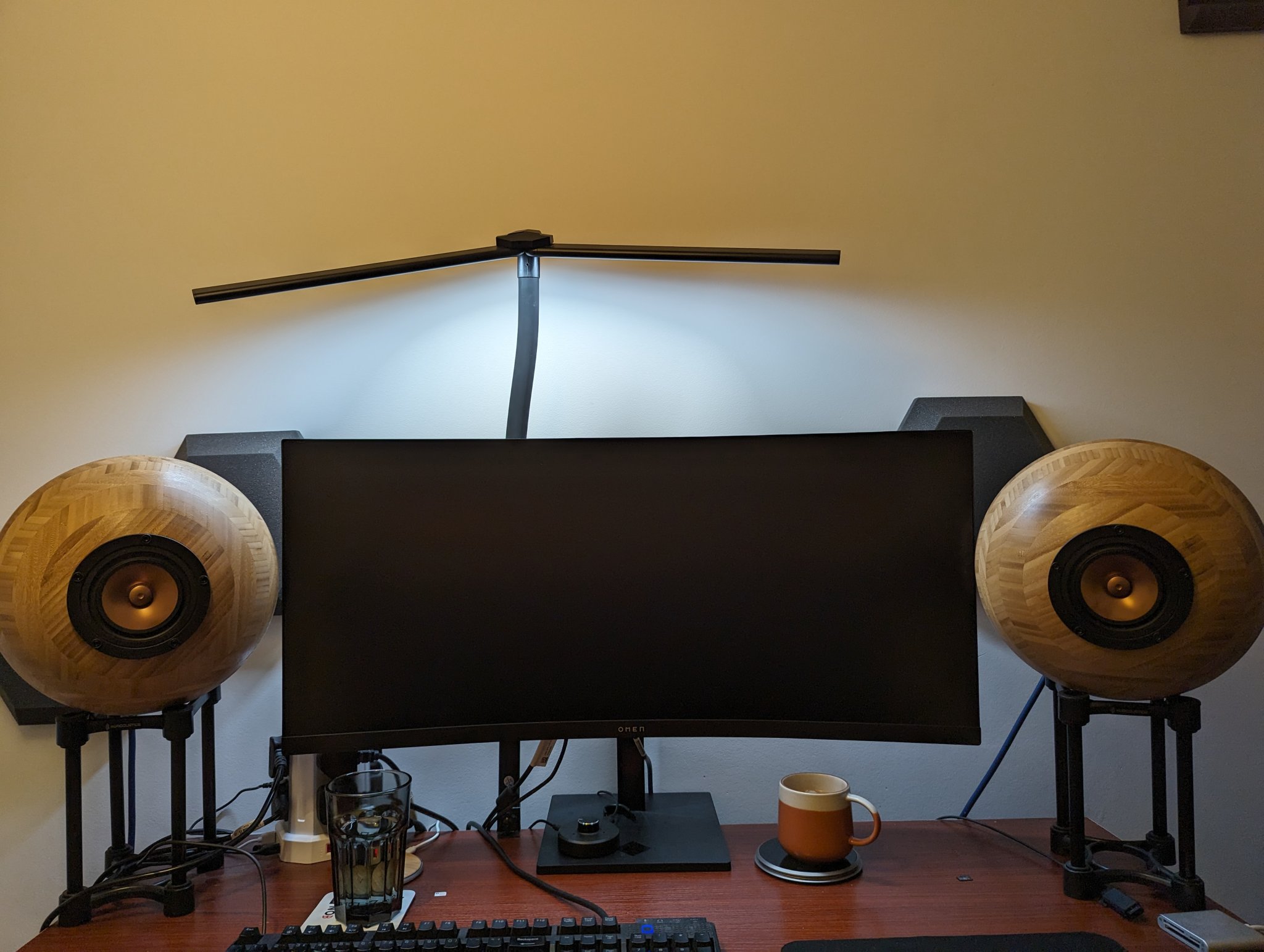

Small update for anyone who may want some impressions of the Pluvias.
Since my last post, I've upgraded to a larger desk, added a sub and a very light amount of eq.
They sound very good now. For the build price of around £200, excluding the sub and amp ofc, they sound excellent. I can't imagine many speakers sounding better at this price, and I imagine they can compete with any small retail bookshelf up to around 1k (haven't tested much over that) if you aren't going for outright power. I will have to update once I test my Adam a5x in this new set up as the position of the speakers has made a huge difference, so I can't give any conclusive comparisons yet. Do also note, my tests are all nearfield at the moment. Speakers around 115cm apart centre to centre and I'm about the same distance from them.
If anyone wants a budget nearfield setup I'd happily recommend these speakers, perhaps a tpa3255 based amp like the 3e audio one, and a sub. Would probably be all in for under 1k and you'll have a full range system. You'd just have to decide how you will add the sub based on your DAC.
I do also need to try another amp and dac, at the moment I'm using a Yamaha A-S801 with its own integrated dac, so there may be room for improvement. I haven't got anything else to hand at the moment though. When I eventually do some more tests I'll update.

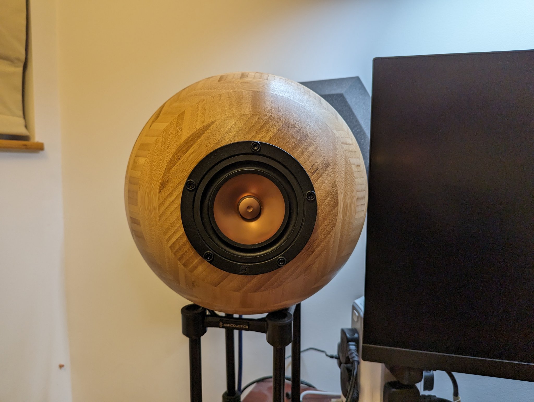

Wondering if anyone can advise on this. I noticed one of my drivers has a slight buzz when playing certain bass sounds. I can hear it on this 60hz frequency sweep easily
I don't think I can hear it in music, but it bothers me it's there either way. I have taken the driver out of the enclosure and it still makes the noise when I hold it in free air. It sort of sounds like the noise of interference from a phone, but in this case it's going at 60hz or so rather than random buzzing.

I tried to play your 60 HZ but heard nothing 🙄, however, these small drivers shouldn't play 60hz anyway I think.
Nevertheless Pls check how are drivers mounted in Ikea bowl, it's rather tricky and possible you have leak that's buzzing...?

The buzzing is definitely not from the enclosure as I tested them by holding them in free air and it still happens, I'm not playing them very loud when testing this too. It sounds like it's coming directly from the cone, if I move off axis from the cone the volume of the buzzing goes down a lot. I'll try to record it later when I'm home if I can. I can't hear it in normal music but it still bothers me of course.

This buzz seems to be actual question, is it possibly a faulty driver. If you bought it with warranty, I would send it back. It's truth that 60hz is too much for those minis, but still it should not buzz or anything at small power.
