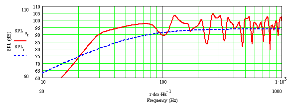

Veravox 7x BIB
Line length 140in
Zdriver 29in
Sl=150in^2
It's got to be pretty big compared to, say, a cabinet for a similar sized Fostex unit because Q / Vas ratio is high. Still, looks a pretty good response to me!
