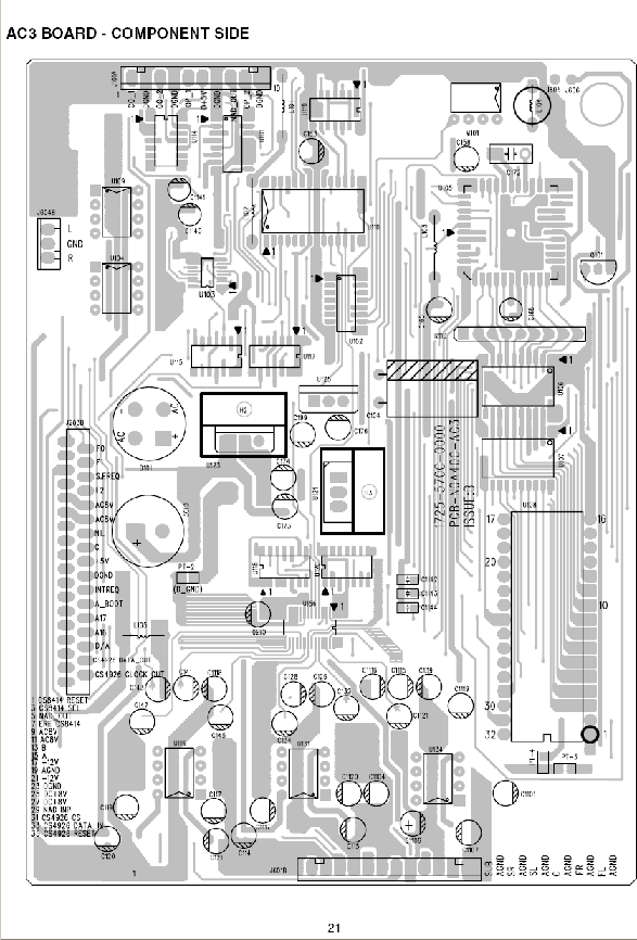

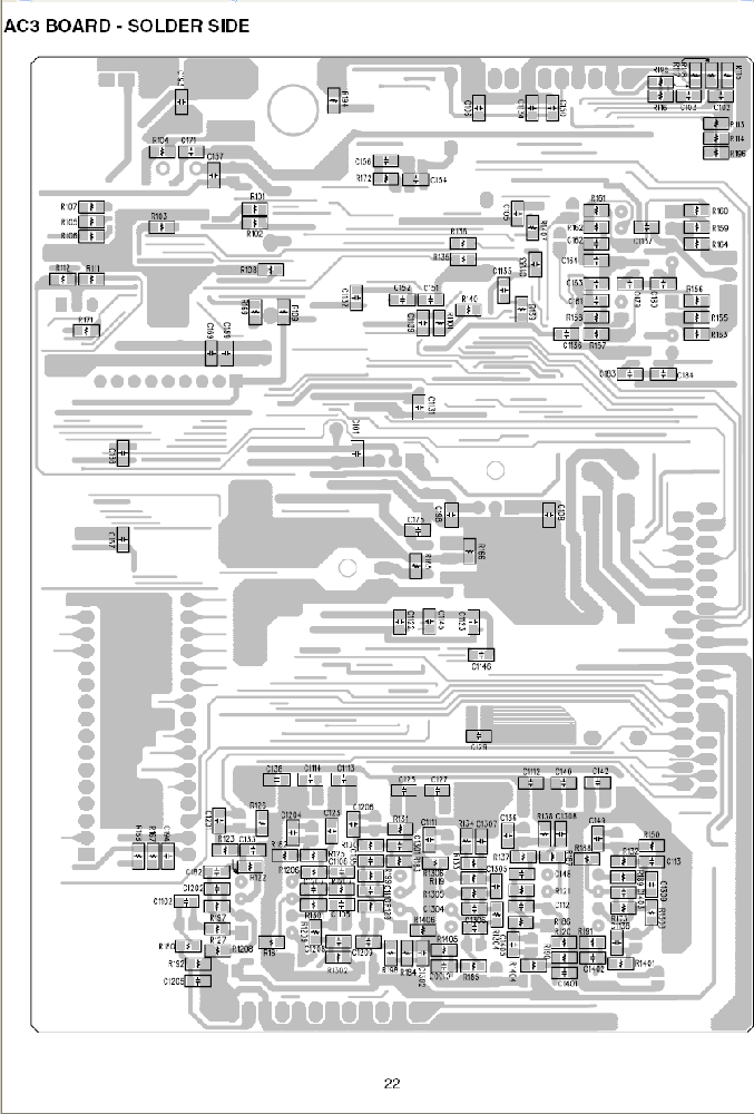

If you look at the AC3Board__1 & 2 photos you'll see that the input of the rectifier should be 8V

I checked the input voltage on the rectifier it's supposed to be 8V according to the schematic (you'll see 2 pins labelled AC8V) those are connected to the AC inputs of the rectifier.
Since they don't specify the voltage orientation on the input side depending how I connect the lead from my volt meter (on AC setting) I get either 7.8 or 8.5 V (seems reasonable to me)
