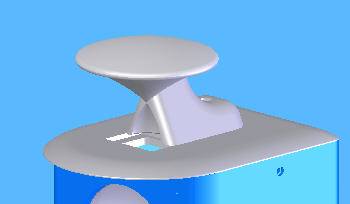

My design would not be valid for most people because it was designed for reflective lens something like this. Additional compensation was necessary for wider energy dispersion.
But if you use sound easy to measure the drivers and design an XO, it should be pretty accurate.

I have not perfected this design yet, there are some things that are still being studied. One is the effect of the concaved portion of on the cone response, the other is the diffraction impulses as the waves reach the edge. So the image is good, but not as good as a direct radiation. This is designed for 180 primary radiation and the frequency does not vary much within this range. The purpose is to make the design as close to a horizontal point source on a wall as possible. This way the sound is open and relaxing, image shift is not so significant as you move from the sweet spot.
I think I would use 360 degree radiation if I wanted the speakers in a really large room positioned far way from any wall. If the 180 degree is used in a long room, one could just position them at center of two side walls and you can listen anywhere walking between them.
Colin said:I'm also intrigued, particularly as Ted is vehemently anti-360 degree omni speakers. I've also found that the Jordan drivers are very sensitive to anything placed near them - it's easy to hear reflections. So I'd have thought a reflector like that would be a real challenge to implement.
Yes, it is a challenge, this is why I am working on it between other projects. I agree with Ted that 360 degree radiation is not the best for the average listening room as I have mentioned in the previous post. I think 180 degrees is more practical and flexible so that speakers can be mounted out of the way as close to the walls as possible.
All light metal cone drivers are sensitive to things very close to it. I discovered that the surrounds that the JxR6 uses is that way for a good purpose. The radiation pattern from cones are such that it is going to be difficult to work with, but I would not use a dome of that size even though it's easier to work with (well, maybe a diamond dome if a wide range driver like that is possible).
