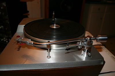

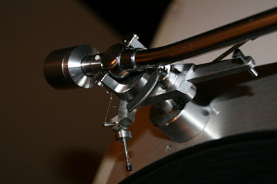

Here are some pics:
Judging by the way your arm is mounted on the Empire 208, you cannot treat the Kenwood arm effective length at 237mm. The Empire stock arm's effective length is 228.6mm (9") and since the Kenwood arm is mounted dead center in hole, it is acting just like the Empire arm because you are not changing the spindle to pivot distance, which is 210.4mm and Empire overhang is 18.2mm.
Unless you file the hole bigger and shift the Kenwood arm farther away from the spindle to make the spindle to pivot distance to be 222mm. There's about 11mm mounting difference between the Empire arm and Kenwood arm. Since the Kenwood arm is mounted like the Empire arm, you have to treat the Kenwood arm geometry like the Empire arm. In practice, you either have to shift the cartridge further back about 11mm from where it supposed to be to similar the Empire geometry or you have to shift the arm base by 11mm to fully match the Kenwood arm geometry.
In plain English, don't use the Kenwood geometry because the way it is mounted right now unless you modified the Empire chassis.

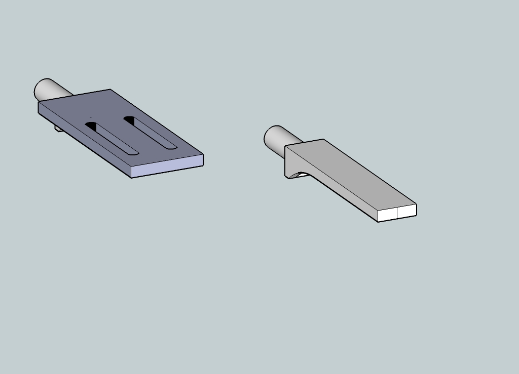

options for mounting...
I agree with directdriverregarding options. There is however another option that can work: Replace the headshell with a new one of a similar design, but "hack out" everything beyond the 1/2" centered mounting slots/holes, and create a plate to put on top of it. That way you can adjust (easily) the angle and mounting distance, without altering an original arm, or an old Empire (you suck, 'cause I've always wanted one).
For comparison of the Empire & Kenwood tonearms and use accordingly.

Well I now have a protractor and have set up the table using the stevenson math and it sounds great! I was able to slide the cartridge far enough back under the head shell to make it work.
Thanks again for everyones help!
