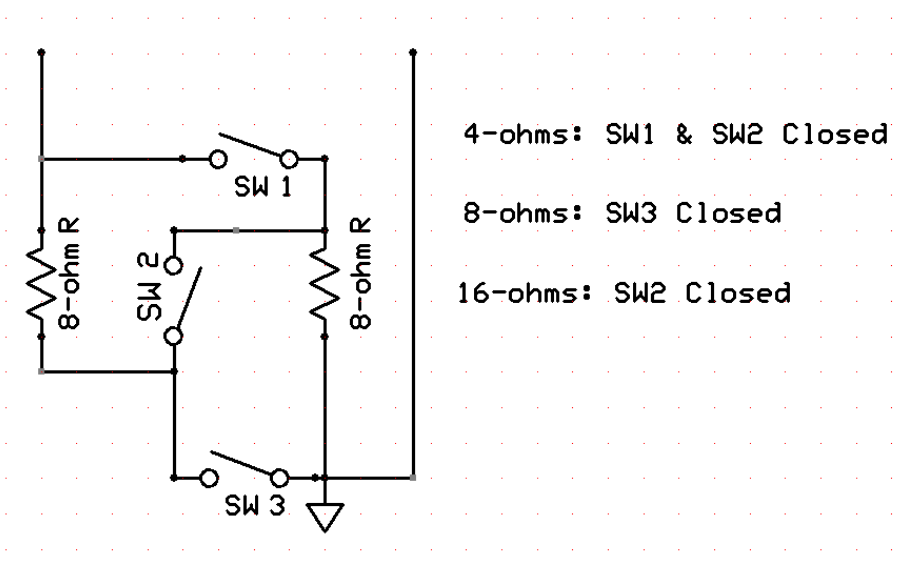

I'm reviving a dummy load project that I started a few years ago, but was delayed by the high cost of the switch. Originally I came up with a 4 pole switch, but I think it can be done with a 3 pole switch.
I'd like to have it be 3 position, 4, 8 and 16 ohm.
Who makes a switch with this logic?
The switch would also have to be a "break-before-make" type.
Otherwise, a potential problem with your circuit is that if you are in the 4-ohm position, and then you switch to the 8-ohm position, and SW3 closes before SW1 or SW2 opens there will be a momentary short circuit.
Same thing happens when going the other way too.
Some amps may not like this if the switch is operated while the amp is being driven.

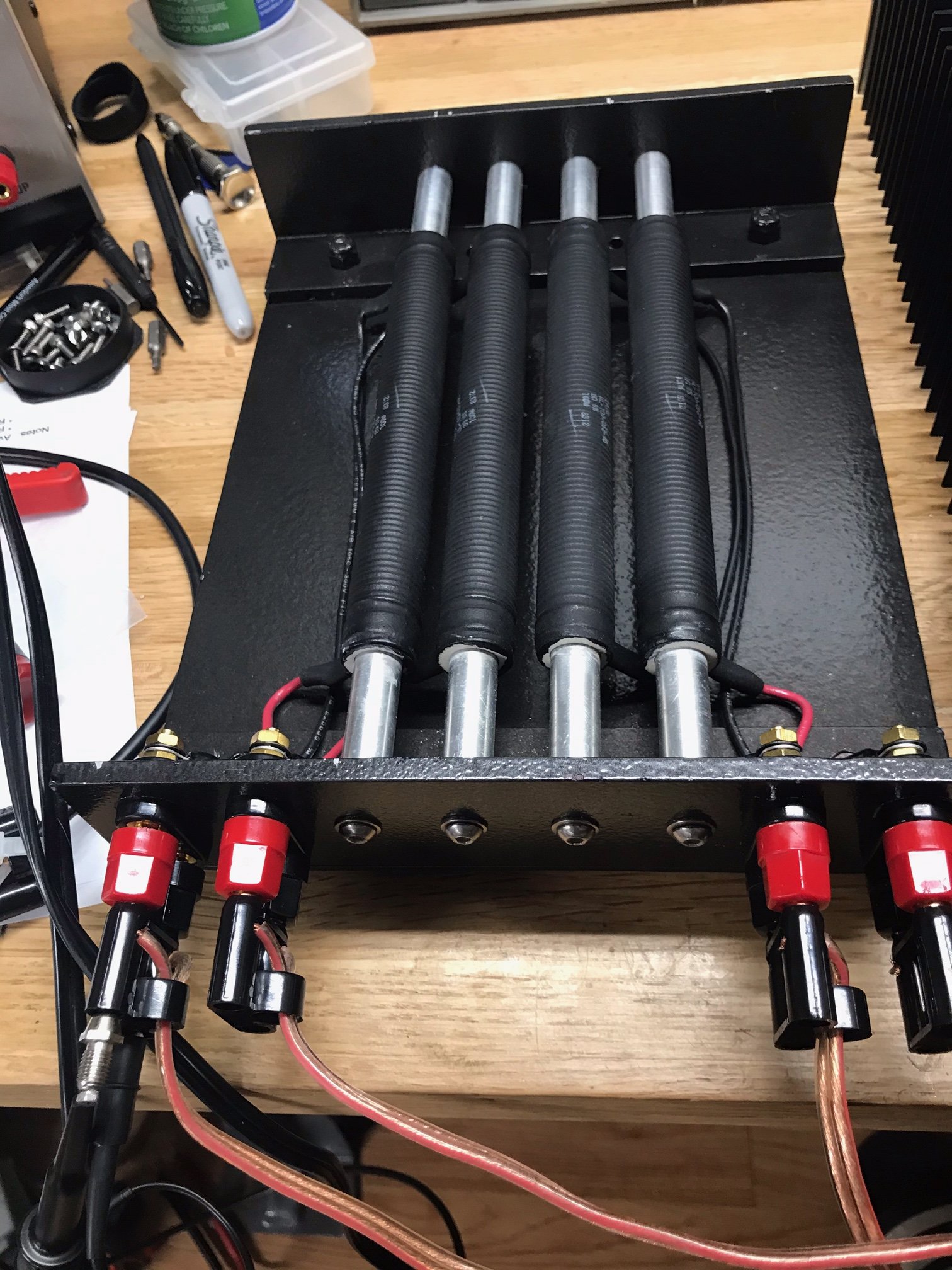

I built a dummy load with no switch - just two binding posts for each resistor and configure it with stacking banana plug jumpers.

I realized that I could do it with three switches, but I wanted to make this new load more "idiot-proof" as I fade off, mentally into the sunset. LOL
My current load only does 8 & 4 ohms.
I've got most of the parts to build the new load, but that switch is a tough one to find.
Here's what I did with four 100 Watt 8 ohm resistors to get:
1) 2 Ohm - one channel @ 400W
2) 4 Ohm - two channels @ 200W each
3) 8 Ohm - four channels @ 100w each
4) 16 Ohm - two channels @ 200W each
There are other combo's but these are enough fro me.
Lately I've been building multi channel amps and having a load with four identical channels has been great.

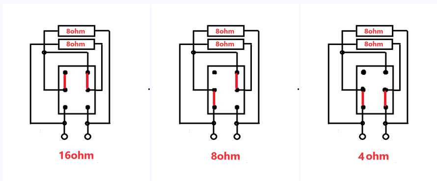

When I traced the schematic in post 1, I believe there was a typo, it should be SW1 and SW3 closed = 4 ohm.
Screenshot 2023-12-12 at 17-31-31 1702236733712.png (PNG Image 870 × 571 pixels) — Scaled (84%).png

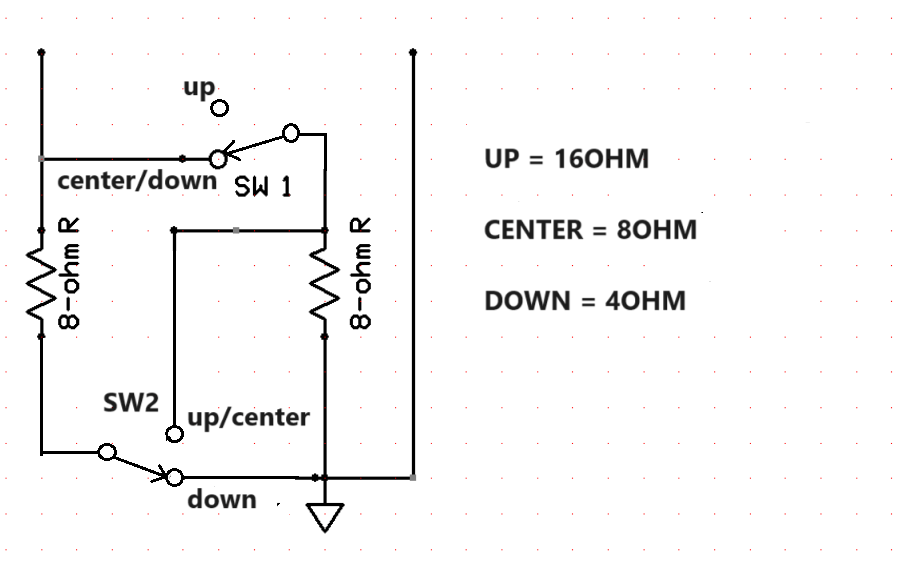

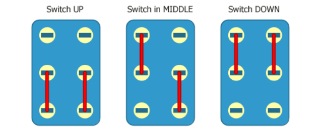

And I found that SW1, SW2 & SW3 can be simplified to two SPDT switch and came out with a new schematic uses a 3 position DPDT ON-ON-ON toggle switch instead.
At center position, SW1 stay down, SW2 moves to up position, only one of 8ohm resistor to complete the circuit (= 8ohm).
