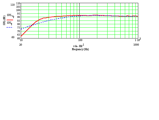

Below is a frequency response plot for a big hybrid bass reflex / MLTL enclosure (it's in the grey area really as to which it is) using the Seas 10in A26RE4. That driver works quite nicely as a midrange, crossed over to a good tweeter at 1.5Khz (which is exactly what World Designs do with their aperiodic kit using this driver -their crossover would be fine. Peter Comeau, ex design head of Mission came up with it, so it's pretty good). I've rolled it off to keep in step with room gain. Reduce the port to 3.5in long for max flat anechoic to ~20Hz
Internal dimensions.
42in tall.
14in wide.
15in deep.
Driver centre 10in down from internal top.
Port 3in diameter, 5in long.
Port centre 28in down from internal top
0.25lbs ft^3 stuffing
This is similar to a couple of enclosures I've come up with recently, first for a friend with 10in Coral Flat 10s full-range drivers, the other for a Supravox 8in wide-band unit. Ye olde approach still works: displacement has merit.
OK, so that's not what you want as you want to use subs. OK, I'd suggest 2 8in units rather than 3 (no need for the extra driver) in a sealed or aperiodic box, MTM layout, crossed over to the subs at around 70Hz. That should give you the performance you want.

Hello Scottmoose. Can you provide a few more details on this enclosure. Is there internal bracing? What is the distribution of stuffing? This sounds like a great design - sounds like you listened to in more than modeled it. That is the approach that works for me. Thanks.
