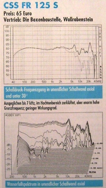

Thanks, I hadn't checked it out first, so didn't know that they weren't in direct competition as it seems in the threads. Interesting, though fairly negative reviews of the current FR125SR here: http://www.diymobileaudio.com/forum.../62692-dfw-high-noon-v2-0-results-w-pics.html
My only complaint is mine needed a 2 kHz dip added, but with my hearing gone up high, can't comment on its weak HF. In a search though, I found the below measurement that 'paints' a considerably different 'picture' that mirrors these folk's observations compared to the early documents and also shows a clear need for a 2 kHz centered dip. By the same token, my hearing is still good enough to know that the big peak in the sibilance BW isn't there, so wonder if the very early ones aren't somewhat better up high than later units.
All things considered, I don't see the CHR70 as any sort of worthwhile upgrade for the HF hearing impaired unless the price differential is a big deal, so I'll pass, though based on others opinions that it has a much better HF response it makes it a better choice overall for a 'FR' app for folks who can still hear the difference.
