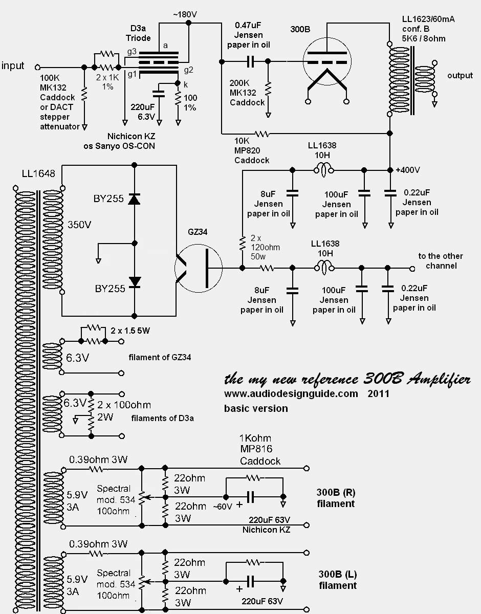

I am trying to learn how to draw loadlines. Can someone please look at the attached schematic and give me operating points for the D3a and the 3ooB? When I do it I am coming up way outside normal operating parameters and I have been using the amp for 5 years and it sounds great. Also I may have a few questions when you are done if you dont mind.
Thank you
Jeff

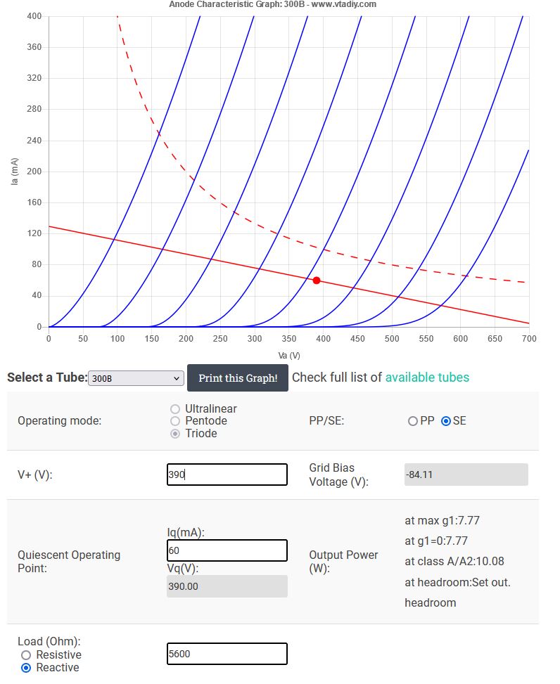

Thank you very much! Do you think the 300B operating point could be improved upon? It seems it the voltage was lowered some and the line was tilted to a little more of an angle it would be more linear. But could it be done without exceeding the 60ma limit of the output traffo??
If you don't feel comfortable using the calculator, the western electric data sheet for the 300b actually gives you a list of operating points and their measured distortion.
http://www.tubebooks.org/tubedata/we300a_b.pdf
The datasheet suggests using some more unconventional operating points will yield better performance.
