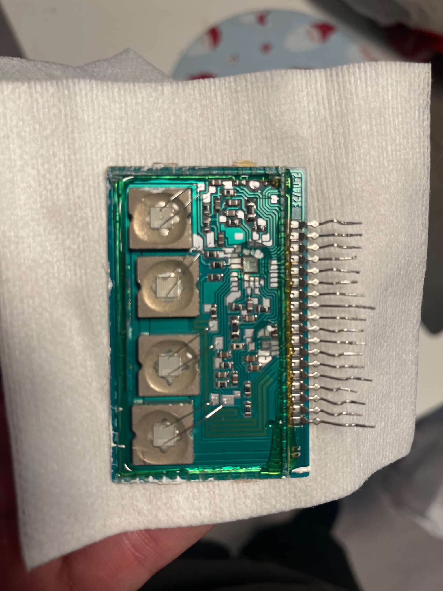

i have received my second Technics se-a900s, i bought this one defective, the problem is that it is in protect. i had a hope that it could be bad solder points... so i started troubleshooting yesterday and found many bad solder joints... soldered these but nothing happened, so i went ahead and measured some volts on svi 3205, and on pin 3 i found the fault.. 53.2v..so the left channel is defective.. i have an a800s that looks like it has been through a meat grinder so i am thinking of taking the svi 3205 from this one, but i don't want to put it in without knowing what caused the svi3205 to fail. so what is the next step? are there any other components that could have been damaged?

Okei, but what I don so far is de solder the svi3205 and taken of the cover.. I found a burned track on top that’s leads to pin 3..
