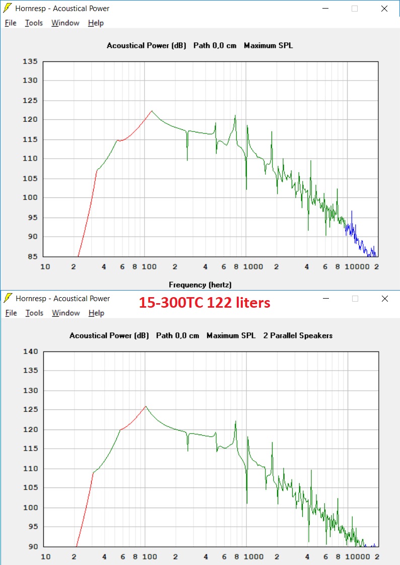

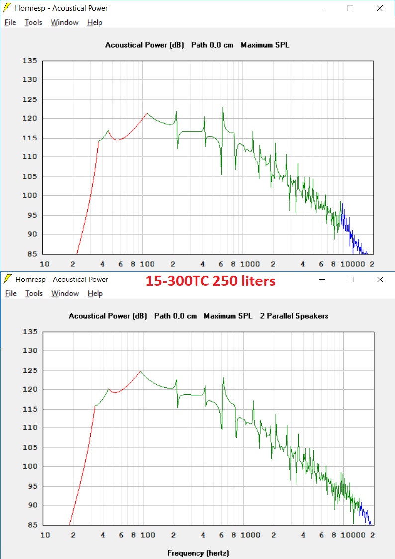

Sonce, so you have not run any sims, and you are saying that the 12" and the 15" are equal in bass performance because they have equal sensitivity at 1khz? .....
Granted, the xmax is similar, but the area of displacement is a little bit bigger.
The 12" is content with a 120liter box but the 15" wants 225liters or more. My sim was 225 liters, I have a picture of it here on my phone, but I have some problems posting pictures from my phone, and ho.e computer is 500km away. I can transfer them to my latop later perhaps.
No, but because of this:
In the same small box (say, 120 liters) the low end is comparable between the two. If you can manage box with double volume, go for it, the 15" will have deeper bass.
Edit: Sensitivity of 12" is 98 dB from 100 Hz to 1 kHz, sensitivity for 15" is 99 dB from 50 Hz to 1 kHz. The 12-250TC will be just 1 dB less loud than 15-300TC from 100 Hz to 1 kHz, up to 250W. 15-300TC can deliver deeper and louder bass below 100 Hz, but only in a bigger box.
It is not the first time I have mentioned bigger size box for the 15", it does not have the parameters to do well in 120liters, and the 12" will not give much more no matter what box. If you run a simulation you will also see the 15" has 4-5db more output overal from 200-300hz down.
