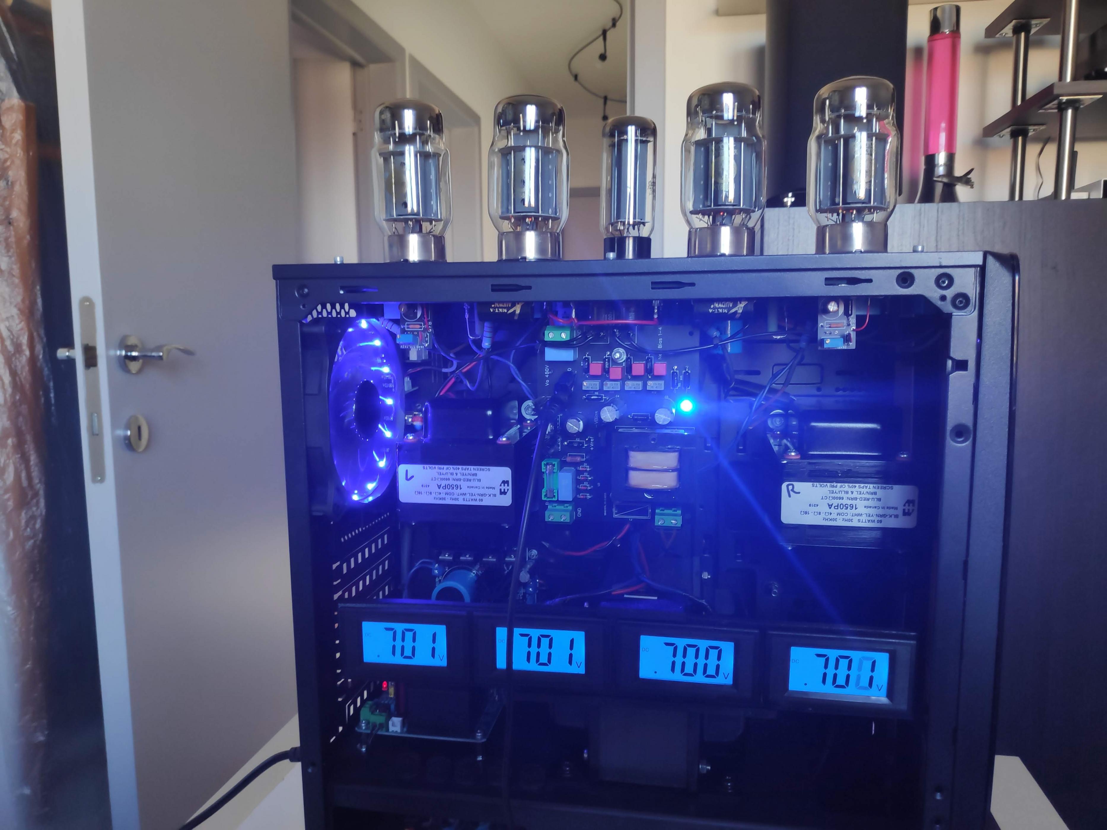

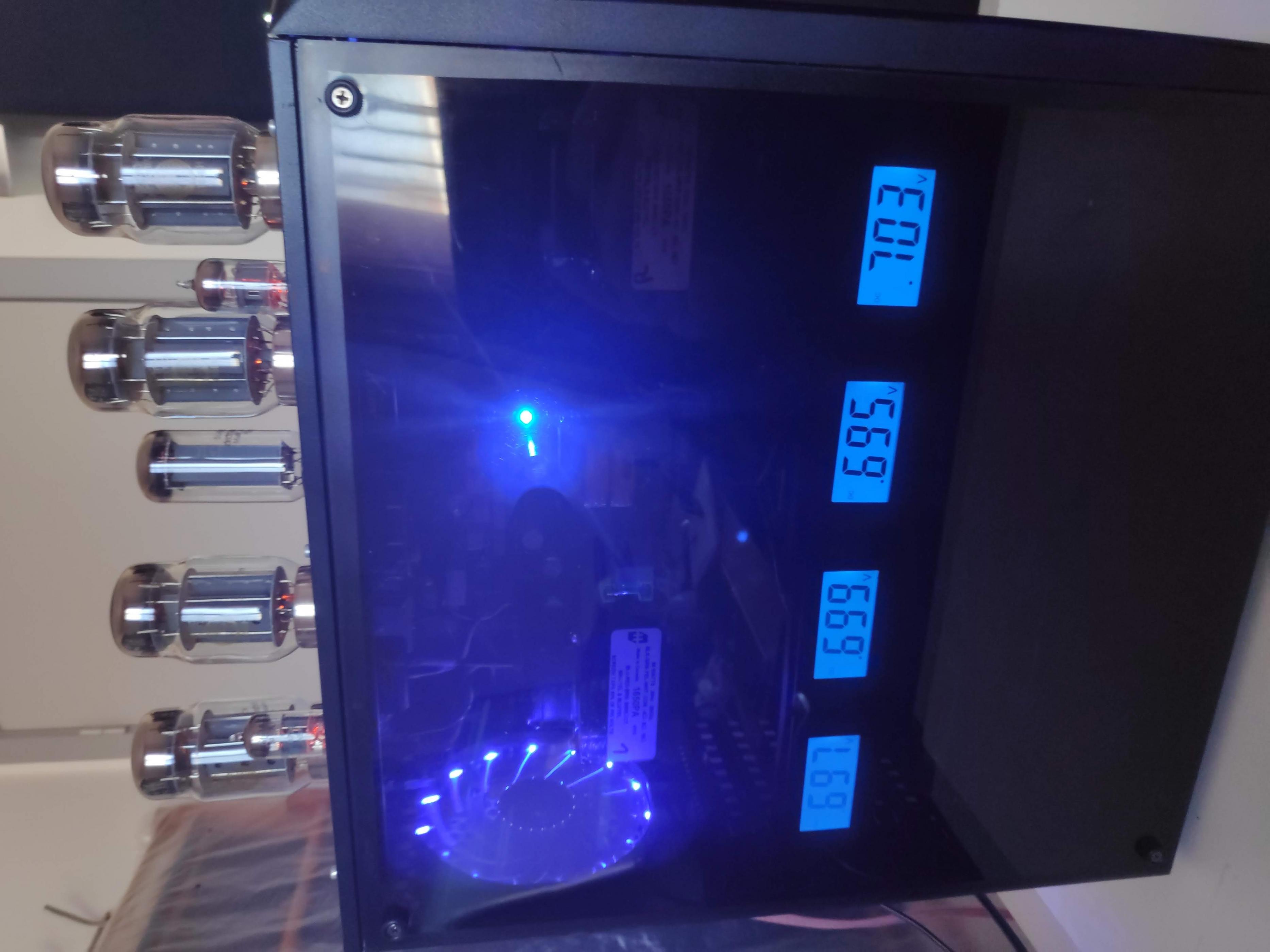

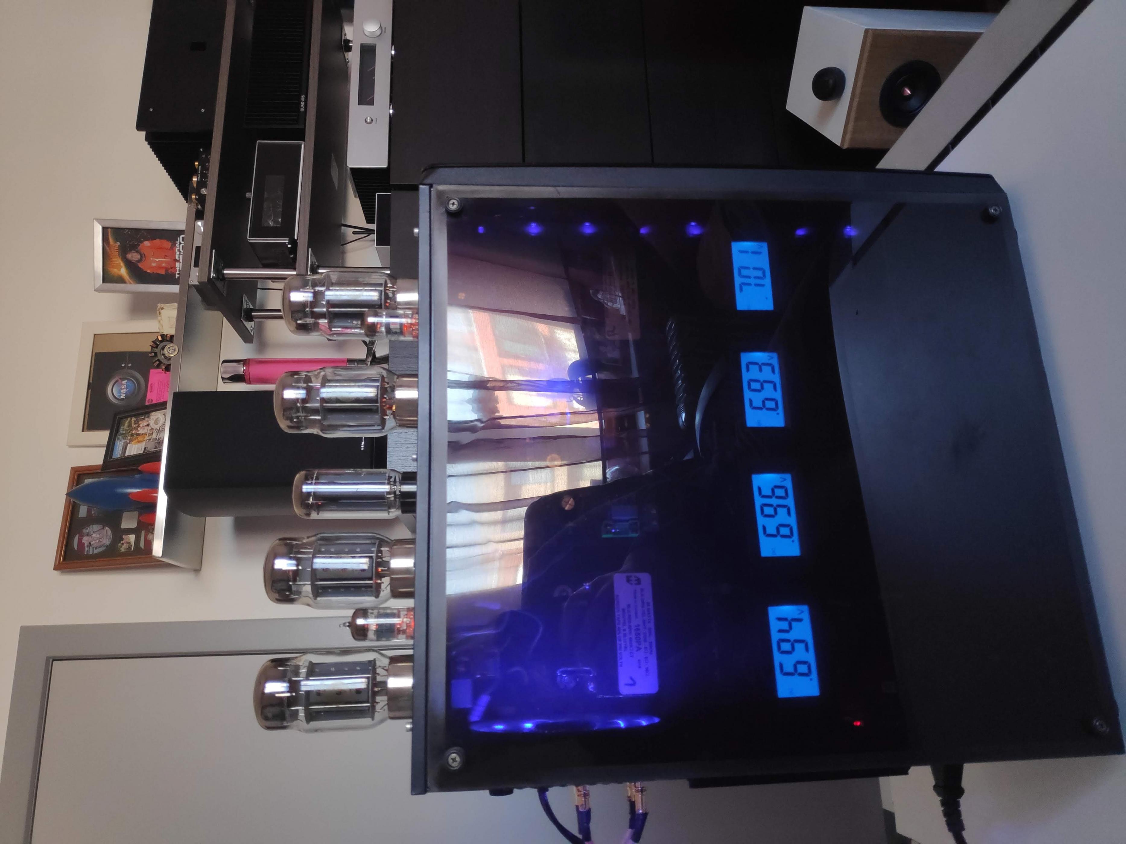

This baby is ready, KT88s are now driven correctly. The 6UA now works perfect with lots of gain and output voltage on the phase splitter.
28Watt RMS output / channel before clipping.

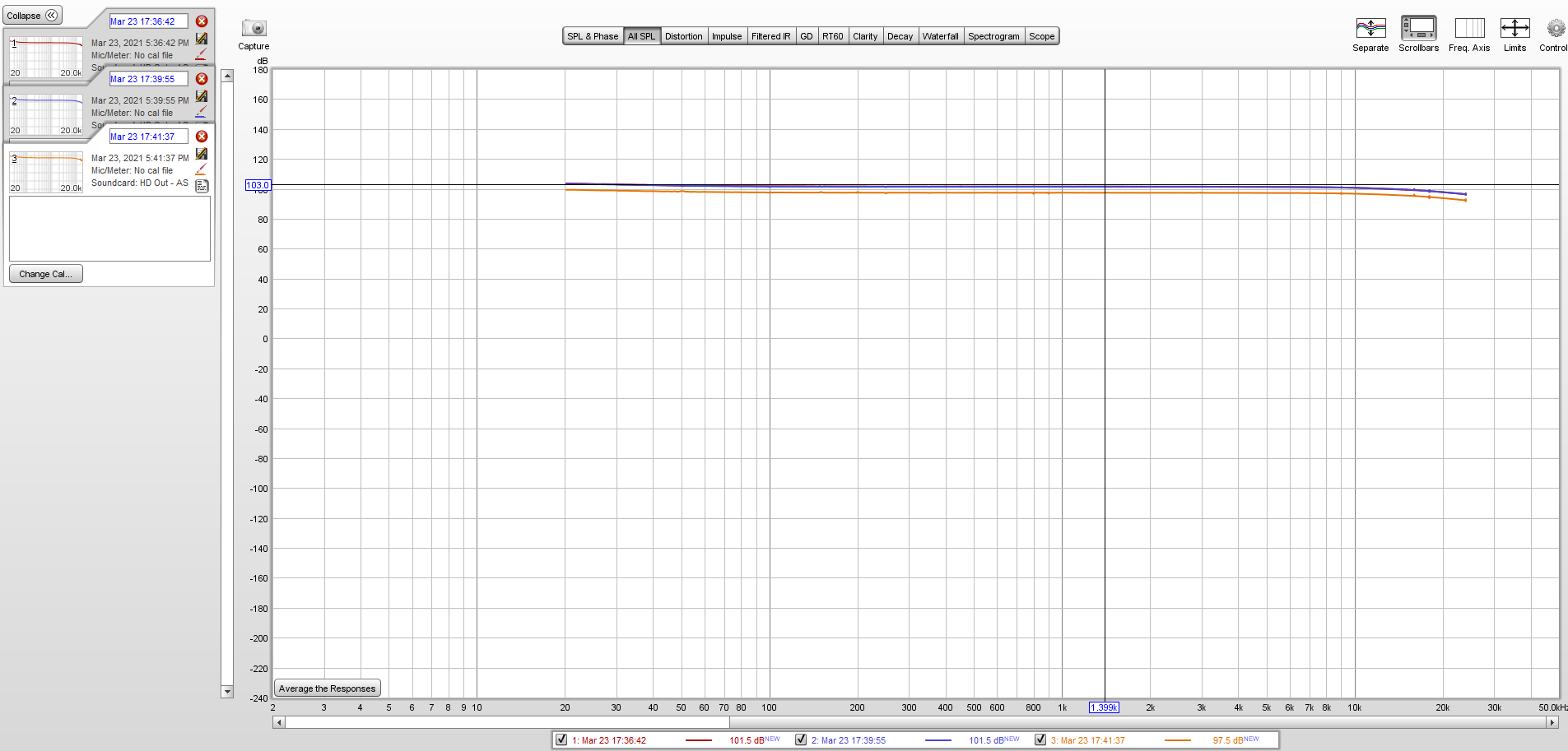

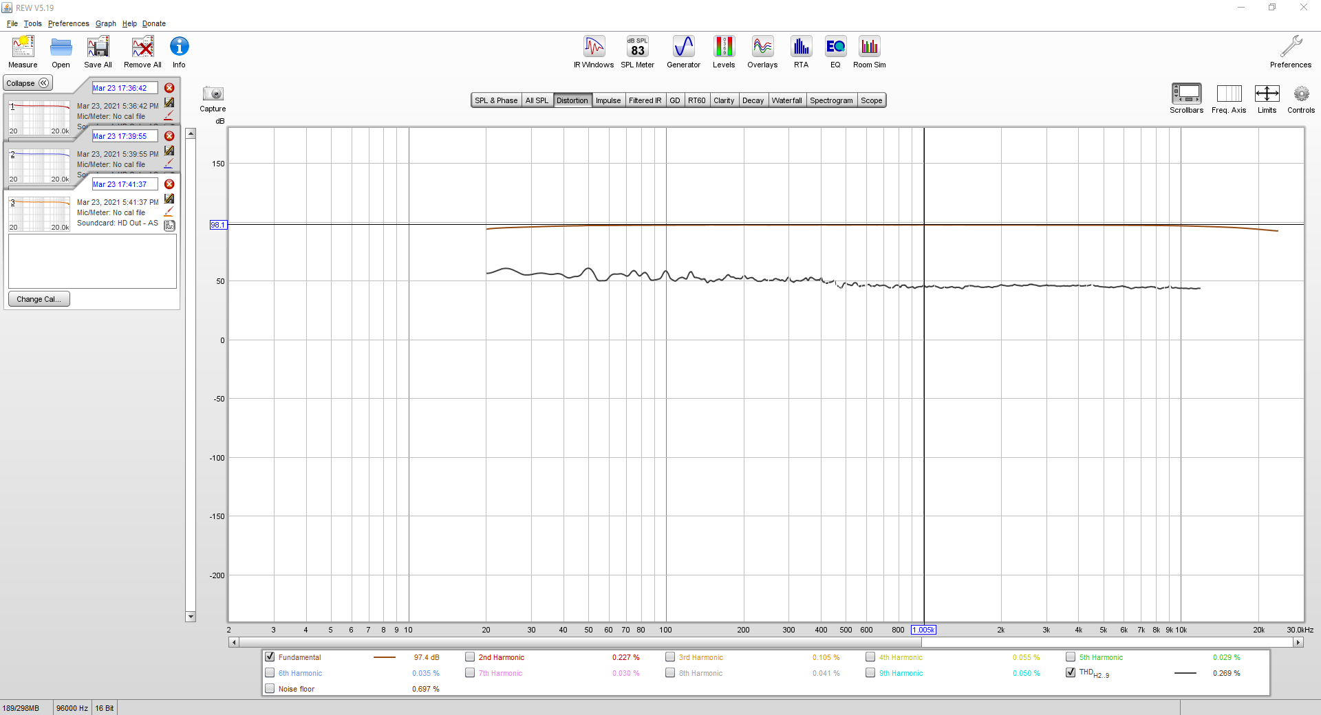

While I was at it I reconverted to UL and added a fixed -V BIAS for output tubes instead of cathode based bias. Biased at 70 mA but adjustable. I decided to regulate the NFB to 3 dB (also adjustable). I could get the frequency curve fully flat with more NFB but then it had the tendency to oscillate. THD measured at normal listen levels and. Left and Right channel are perfectly balanced in amplitude.

Ives, you really should plot the gain and phase without feedback first. Adding any supplementary phase/gain shifting circuits is best done with a knowledge of what they will do, and where to focus their effect to best improve closed loop gain/phase margins.
Your plots also indicate you can only measure from 20Hz to 24kHz - that is very limited when it comes to assessing LF and HF stability margins and performance. Is that really your limit range (as REW can compensate for drop off of an interface device, and has the ability to measure down to 2Hz, and generate signal to 1Hz)? Do you have any other test equipment? How did you know that the amp was oscillating when NFB was increased?
