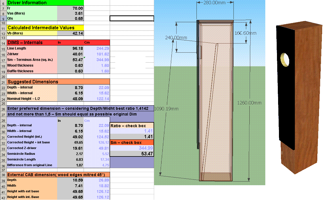

Attached is the revised plan.
I've tweaked the sizes a bit for easier cutting. It has resulted in a bigger box but I've kept the ratio to 1.4, so I reckon it will work!
Is chipboard a huge compromise over plyboard for this design? It's about 1/4 of the price!

Quick question - with the inverted BiB, how far off the ground should the box be, or is it again a matter of finding what sounds best? I am thinking about experimenting by putting blocks of wood under the corners first, but if there is a recommended amount then I will just make the sides longer and have a front and back vent..

I have now ordered some 30mm long spikes to go under the speakers and I'll be using some of my leftover plywood to make some bases which I'll spray black.
I'm going to cut the karlson slot in the speaker soon. I'm going to start off with 1 on each side approx 50mm x 200mm - any opinions on this size?
Te scheme i plan on using if i get as far as building a set, is to use a grid of holes (in one of the Karlson documents), as illustrated in the attachment. The staggered grid looks better to me.
Slot can be easily grown and leave the panel stronger.
