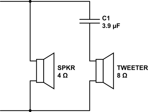

You need to connect a capacitor in series with each tweeter to prevent the low frequencies from destroying it.
However, the tweeter and capacitor combination need to be placed in parallel with your JBL similar to what is shown in the attachement (ignore the values shown in the attachment).
A 4.7uF non-polar film capacitor may be suitable for your purposes.

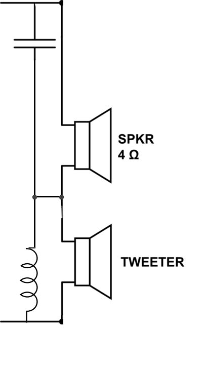

BTW this is a ( 1st order) series crossover for a woofer and a tweeter.
It can be done! The value of the components has to be carefully chosen
For a 2.3 Ω woofer the value of the coil will be pretty low, and the wire gauge low too ( 14 ? ). But I don't think it will work in a car environment, as the tweeter's voice coil is prone to burn easily, with just a cap for protection. Better to go 2nd order.
The woofer now works without any low pass filter, so it would benefit from some band limitation.
