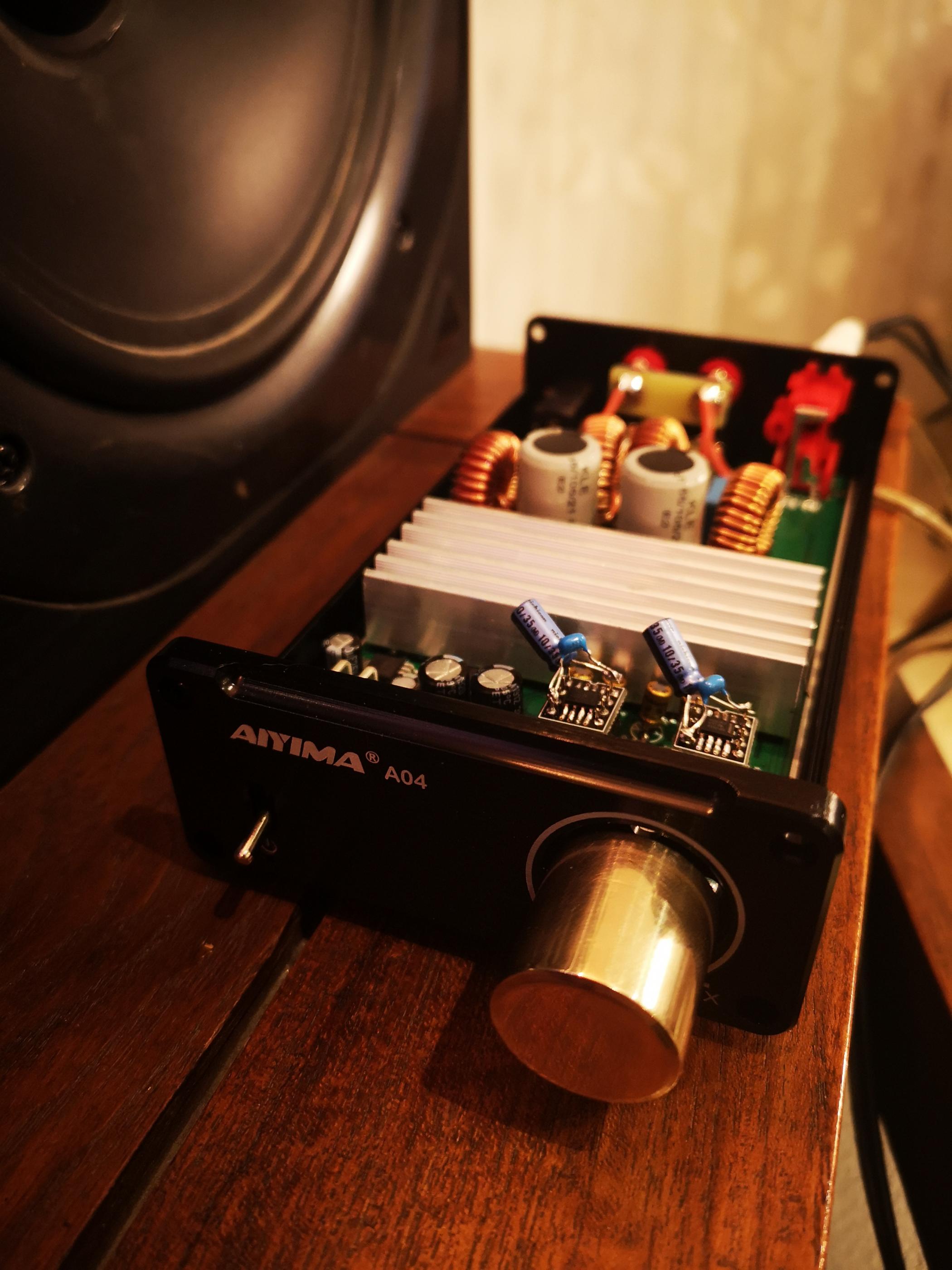

I built a little desktop system last fall. Bought a TPA3250 amp to power it.
It's small and sounds good. I connected it directly to headphones output of MacBook. There was a hiss on higher volume levels which i solved by buying a grounded power adapter for the laptop. The stock one didn't have a ground pin.
Headphone output turned to be of a decent quality. The laptop is about 6-7 years old.
