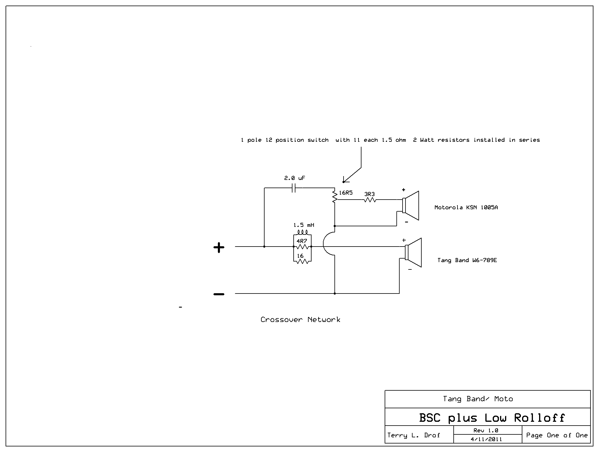

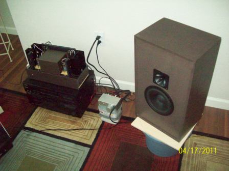

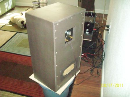

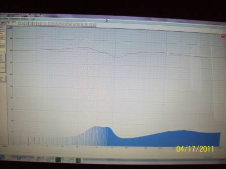

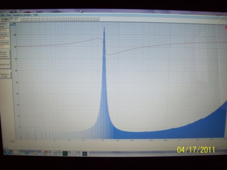

It has been a while---had a little interim construction to do before getting on with the Tang Bands. I ended up trusting my measured parameters. I used the calculators on the Madisound site to calculate about 19.3 L sealed for a Qtc of 1. I cut a 5 in. X 2 in. slot on the back panels, was able to bring the impedance curve down to a relatively flat 18 ohms from 90 Hz down to 45 Hz as the plots show (apologies for the poor quality-I was trying to keep the upload size down). I used hardware cloth stapled on the interior side, and used one layer of 1/4" A/C register filter material obtained from HD. To this layer was added 5 layers of 1/4 in thick very open celled foam I had on hand. These layers were all pressed together and held in place by Hardware cloth.
I went with a BSC as the diagram shows. The reason was--I was trying to simplify if possible--keeping in mind my amp provides about 5 watts max. The tweeter is a piezo. It is a Motorola KSN 1005A, and I can attest along with others who have commented on the internet about piezos--there is a big difference between these and some others I had around. The Motos are hands down better. They are rolled off below 5K. I tried the L Pad/ paralleled resistor circuit and did not like it. I listened for long periods of time and determined the circuit in my diagram is better. It is much smoother, and contrary to my suspicions, very well integrated with the TBs. I found the BSCs allowed the TB to be used out to its limits and also took care of some peaky stuff around 6K. Easy load. Nice deep sounding but detailed bass. Highs are smooth and don't irritate at all. Obviously only one resistor can be used on the BSC, the 16 ohm is just a consequence of my listening/ tweaking. One of the best aspects is the decent efficiency in my room. The dogs there are not suffering from listening fatigue---they are happy.
