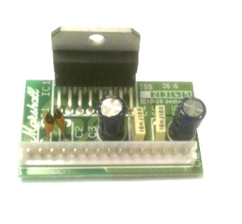

Hello. I would like to know can I power 4 mono boards tda7293 with only 1 transformer which has output 45-0-45 vac ? Transformer is taken out from some sony amplifier which has stk4221 chip inside.
Of course I'm considering to put proper heatsinks on all boards and if I need to I will put some fan and I don't expect more than around 50w clean power per board.
Thanks for any help.

The actual delivered DC Volts was +/-48V at idle. This obviously sagged a LOT at full roar because the box was rated 80 Watts @8r clean or 35V peak. The "Music power 170+170" rating suggests 51V peak which is more than the idle power rail so is surely pretty clipped.
The power supply makes 48+48= 96V and the TDA7293 is rated 120V. It can work (but see JMFahey's remarks above). It will not tolerate careless or sloppy craftsmanship. Hmmm... the TDA7293 sells for $13 which is a lot less than I used to pay for blowing-up all the outputs of my 27 Watt amp.
And of course with the same power transformer the power output will be very nearly the same as when it was a Sony: 80W clean 100W blasting, which is serious power for the home, especially in serious speakers.
EDIT: ah, you want _four_ channels? Try it. It will certainly play medium loud. Sneak up the volume and keep feeling the power transformer (be sure all joints are perfectly insulated!!). The RX-99 was designed just-good-enough for two big stereo channels. Four channels pushed hard may shorten its life.
