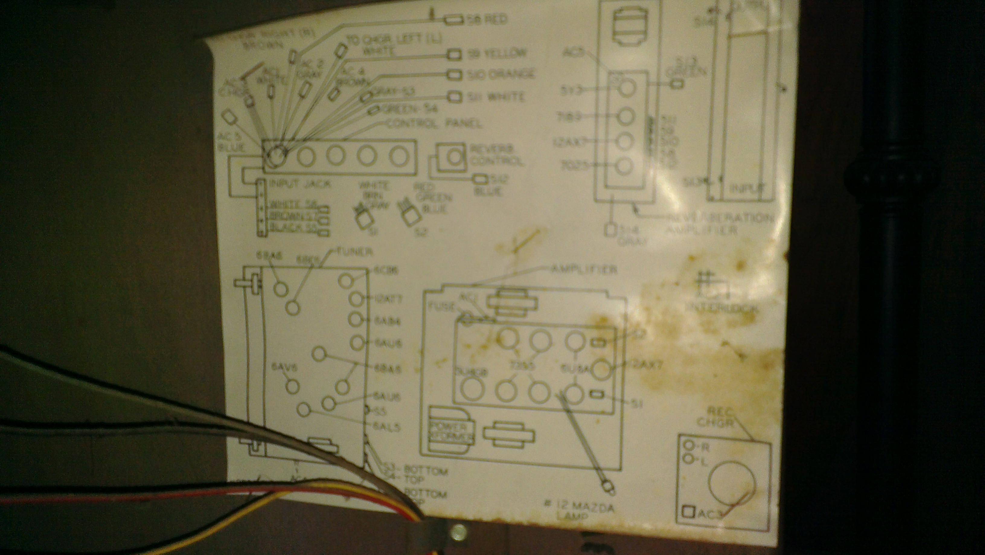

Need Schematic for this GE Console fast.
I just scored my 2nd of these GE consoles and haven't had a chance to get a schematic for them. My order for some other parts from ApexJR will ship tomorrow and now I have a appetite to get these also re-capped. So I need the schematic ASAP if anyone has one so I can add the parts.
It was manufactured April 22, 1960 and runs on 7355 output tubes
Here are some pics.

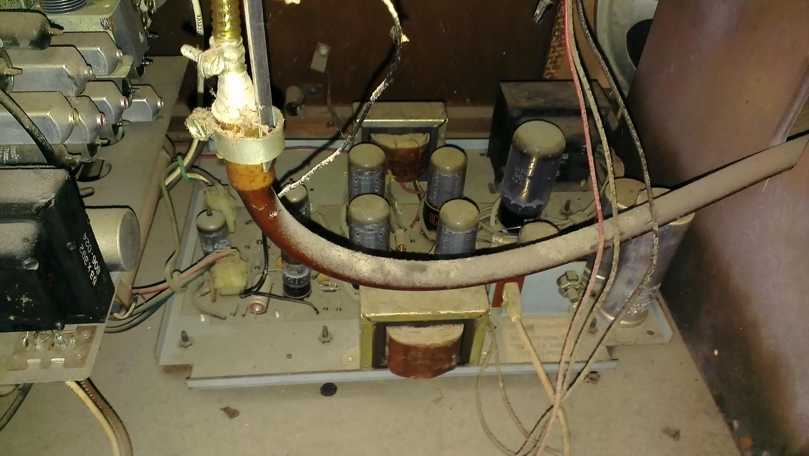

Do you want to make the whole console work, or just take the power amp out??
The power amp likely can be repaired just by basic inspection and troubleshooting, if there is a problem.
I'd get a vacuum cleaner with a brush attachment and clean out the dust, btw...

Yes, definitely needs a vacume!!
Both of them work and fortunately when that was demonstrated to me, nothing smoked or died. Of course, before seeing power again, the coupling and PS filter caps will be replaced (the main goal of this thread).
I will have 2 of these. Between the 2 of them, I could make a pretty pristine one, so right now my goal is to;
- both have 7025 based mono "reverb" units in them in addition to the main power amp. I will pull the mono amps and maybe make monoblocks out of them.
- pull one power amp and make a free standing amp
- restore and modernize the cab and insides of the other. I plan to leave the tuner in, remove the turntable and replace it with a touch screen, and add a motherboard with wireless wifi to pull digital music off my media center, internet, etc. It will look original from the outside.

Most of these old consoles didn't have fuses anywhere. When the can caps dry up, the power supply cooks. Surprisingly, I've never heard of one catching fire.
I'd start by installing a fuse and grounded plug.
You can read the values right off the side of those can caps, even if you can't find a schematic. AES sells them.

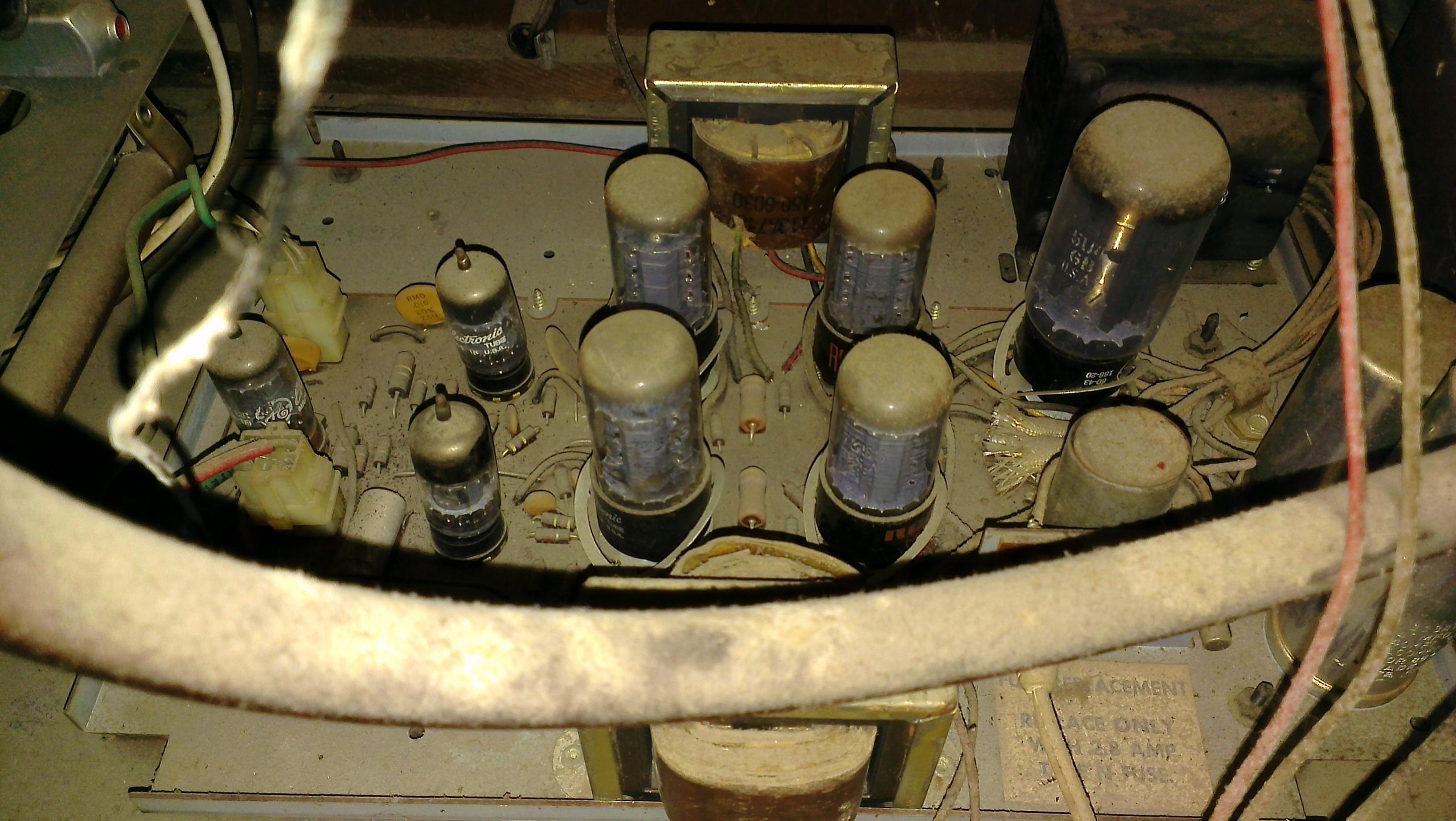

I do not recall any lack of fuse protection in these, in spite of being decades back in time for me. In the photos in post #4 - it shows the chassis sticker regarding fuse replacement....
I don't believe Underwriters Laboratories (UL), would approve a consumer device like this without a fuse.

Without a doubt, any of the electrolytics in any of the circuitry in this console are likely a bit dry. So the plan to replace them is a good idea.
We had normally used an air compressor to blow out dust buildup in all the repair jobs. I know that has pluses and minuses regarding dust blowing around...

In it there is a pic of a ID tag that implies its a "RC-1710R", or "RC-1711R" or "RC-1714R" depending upon wood construction. Mine is Walnut, so would be a RC-1711R per the tag.
There is also a shot of some Sam's info, but no actual schematic or actual component value data.

I picked up the 2nd General Electric console today and i still ad the model number tag on the back.
It says;
RC-1350A
RC-1351A
RC-1354A
Each means a different wood cab, so I'm sure the insides are the same.
So still looking for a schematic. Maybe the above will sound familiar to someone.
