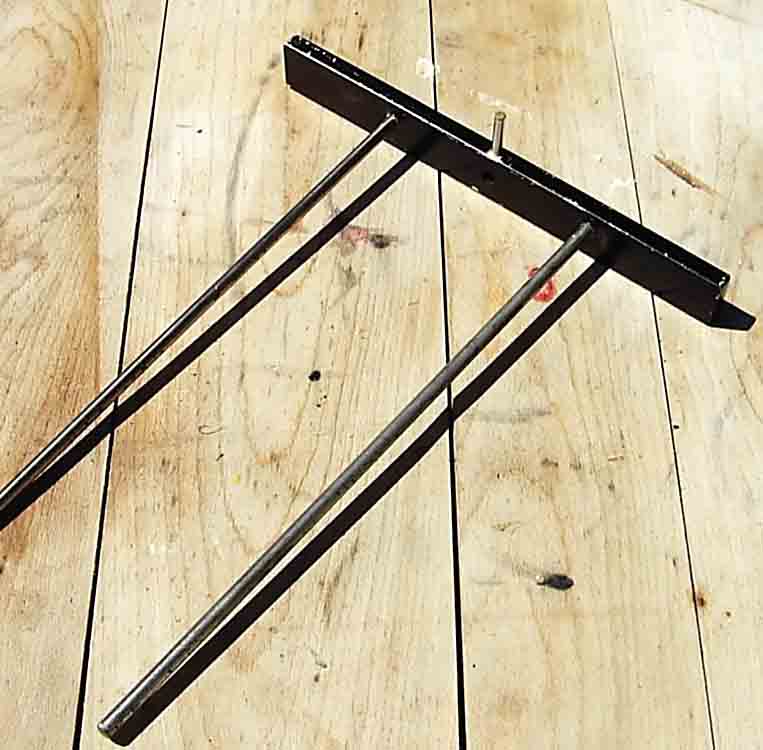

I'm quite new to routing, so perhaps I'm missing something, but I made up this device which acts as a standard fence one way up and a fully adjustable circle jig the other (the pin fits into a predrilled hole of course).
