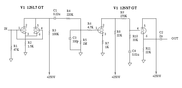

I agree with the 6SL7 suggestion. Many 6SL7 specimens have issues with microphonics, but that is easily circumvented by using the Loctal 7F7, which is electrically equivalent to the 6SL7. Remember, Loctal types were intended for mobile service and must be vibration resistant.
BTW, the "12" V. versions of these tubes (12SL7/14F7) may allow some cost savings.
If you're feeling adventurous, a pentode (IMO) worthy of consideration for 1st gain block duty is the 6AC7. Even with partition noise, it might be quiet enough and the high gm allows "gobs" of gain to be extracted.
Don't be too careless in substituting an ECC83/12AX7A by a 6SL7 (and vice versa, of course)! The latter one has lower µ (70 vs. 100) and lower plate impedance, which might have an impact on a passive RIAA eq network. E.g. see Kodabmx's schematics above, which was first published by Bob Danielak. I've built that, too, but using ECC83 and ECC82. Hence I had to adjust (decrease) R4 to cope with the ECC83's higher plate impedance.Use the 12AX7/ECC83 design and substitute a near identical IO valve; 6SL7.
Best regards!

It's interesting this thread should come up, as I've been considering a scratch-built RIAA stage build over the past week. The three I'm considering:
I've already gathered the parts for Eli's stage, which I like for its novel approach, but I was wondering about the pros and cons of the other two. The JE Labs is attractive because I have boatloads of NOS Loktals, but Vinylsavor's looks to be simpler.

That was going to be my next question (you read my mind). And since the 7F7 is basically a Loktal 6SL7, this might further expand the options for the OP. I've considered the 7F7/6SL7 as a substitute, but was concerned with the different interelectrode capacitance and Mu (the 7F7's 70 vs. 100 for the 12AX7).
Remember, net gain is controlled by both μ and RP. There's not much difference between the 'X7 and the 'SL7, when you crunch the numbers.

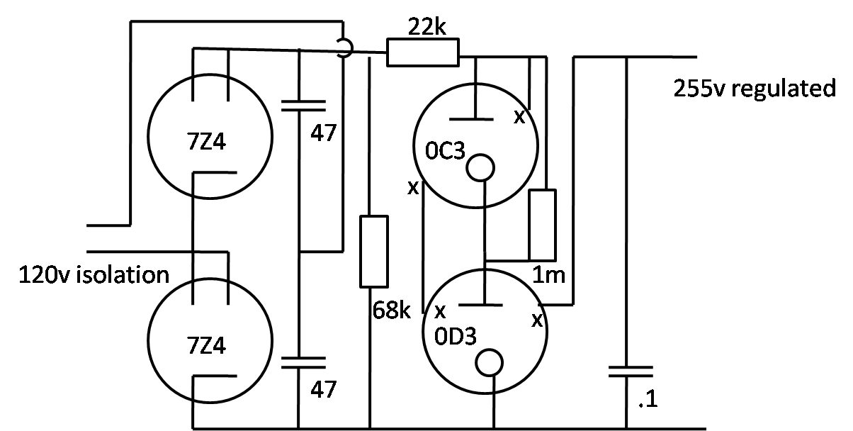

I have been looking for an excuse to use glow-discharge tubes for the first time, so how about the following for the power supply?
Sticking with the Loktal the 7Z4 makes an inexpensive voltage multiplier. The caps should give me about 300v to fire the regulators (with the 1meg shunt to help).
The 68k resistor is just to drain the caps when powered off for safety.
The 22k resistor limits current through the glow-tubes
x notes the path to remove voltage from the circuit with removal of a regulator.
.1uf should be small enough to prevent oscillation while providing some filtering.
Suggestions?

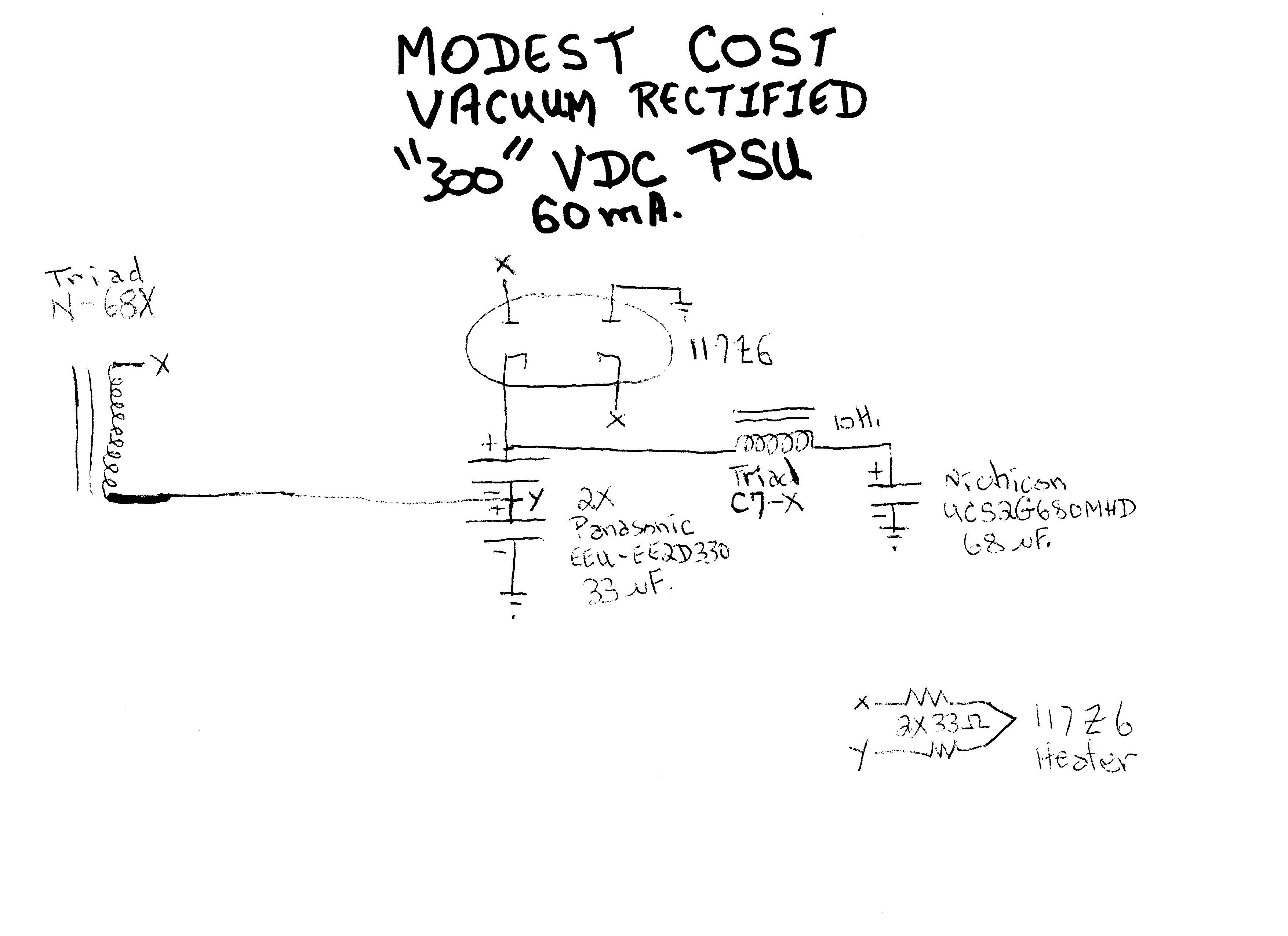

I say, did somebody mention voltage doubler? The attached "hen scratch" schematic is inexpensive to execute and would work well with gas discharge regulation.
BTW, the 0.1 μF. noise suppression part is (IMO) pressing your luck, with regards to observing unwanted relaxation oscillator behavior. I think 0.068 μF. is a better choice.
